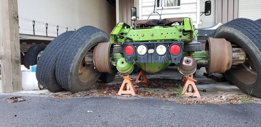

These have been holding up this truck 4-5 years.

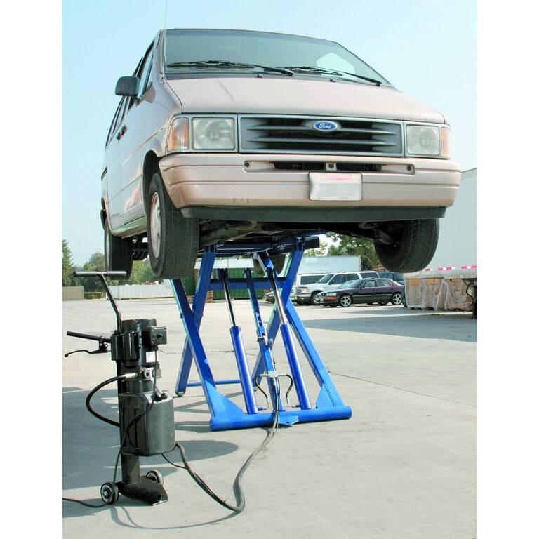

Case in point... This just doesn't look safe to me. The base is narrow and it looks spindly, almost as if it's all set to twist one of the legs and fall down. I would trust it to do a brake job where the car isn't far off the ground, but getting under it? No... Just no. I'll bet that at full height, I could tug on a corner hard (like pulling to take a part off) and have that Ford Death Star van sitting on the ground.
