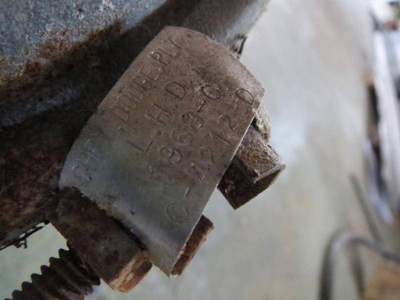

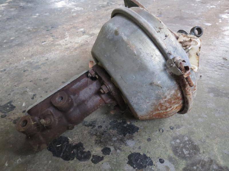

I just may have what is supposed to be a very low mileage original master cylinder and booster from a '68 New Yorker. I'll get it ou tomorrow and post some pics here, remind me by bumping this in the morning.
Bumping Matt
I'm on it right now, stand by...
Really nice piece, I'm thinking it is a 20 thousand mile original.
$50 + shipping and it's yours.
Thanks for the offer. We went by our local store and ordered a Cardone that will fit the car. The shop parts guy already bought the dual chamber MC. You're an wonderful person for offering this piece of history. Again, thanks!
You're welcome and thanks for letting me know.
