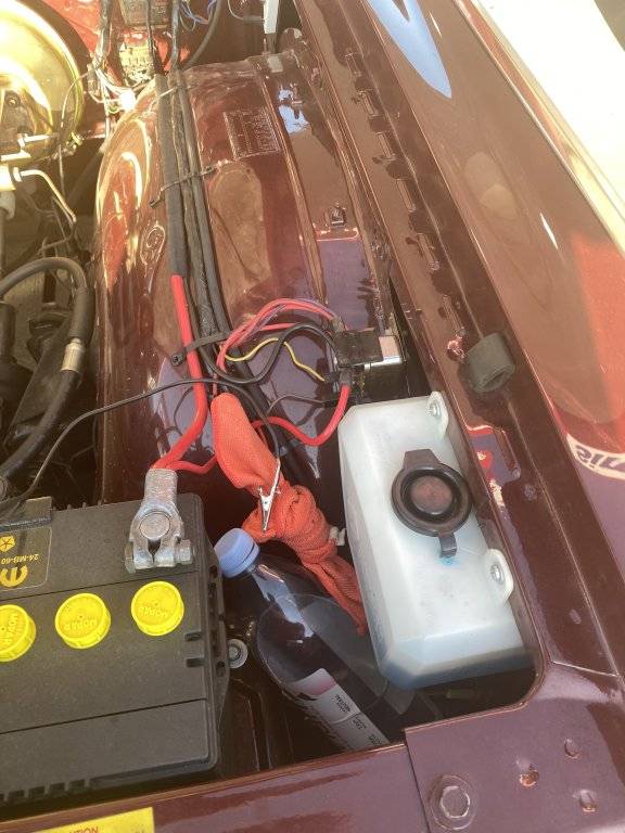

We installed this in about 15 minutes.
Wedged alligator clip into the power on my relay

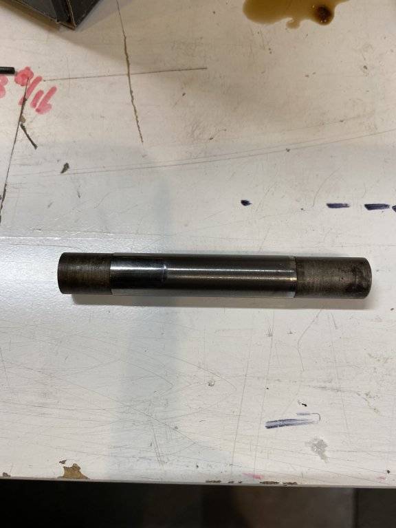

Somewhere there was a thread that discussed good pushrod vendors vs some that weren’t so good.
I found the measurement in on of @LocuMob posts so will measure mine first. 3-7/32”. But first I need to wait until the power comes back on so I can raise my lift. Have a storm going through right now with 70 mph wind gusts.
My rod is a little short. Measures at 2.98. I think the spec is 3.21 or 3.22”
Mine is off about .24 or 1/4”. Ok maybe it’s a little worn.
Are these two ends supposed to be equal?
Yes, they should be equal. That rod lost a little.
Definitely, some major wear. I like to re-use the originals, they seem to never wear, even with 6-figure mileage.
This was an original. I didn't know at the time when I re-built my engine that I should have replaced it as well 114,000 miles ( hard miles) Not sure how often dad changed the oil back on the farm. Probably only as time allowed.
The key to a replacement is to get one that has good hardness, but a hair softer than the cam. Would rather wear the rod than the cam lobe.
At least the end had perfect even wear with just a little concave hollow.
