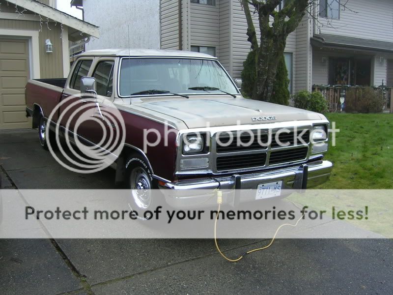

Are you refering to a swepty crewcab....? Heres a pic of mine... daily driver.

Nice truck. Looks like you've done a lot to it. Can you tell us more about the truck?

Nope my 84 D350 Crewcab...with a 89 Cummins and a NV4500 manual 5 speed....my daily driver too. Slowly fixing it up as I drive it.

Thank you...always loved those swepty trucks. I get around 20-21 mpg locally. And seen just shy of 28 mpg on straight hwy running. Love the 89-93 cummins motors....mechanical everything, and just a darn easy motor to work on and maintain. Never go back to a gas powered mopar truck again.
