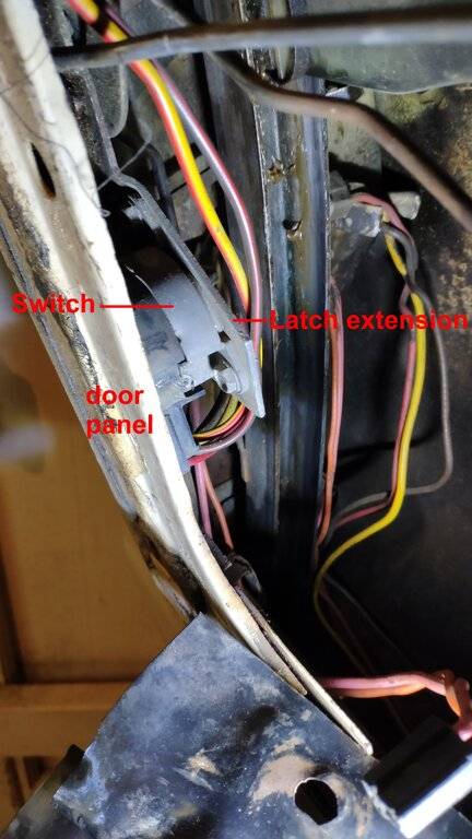

I need to change the switch because it works (with the lock cylinder) only in one direction (down) . The switch is stuck between the latch and the door sheet metal, see pic. So to remove it (it has a pin from the latch which goes in) i must remove the latch (so the glass and the run channel !) ... Unless I manage to have enough space to disengage the pin by sufficiently unscrewing the latch.

You will have to remove the lock. Prise the spring U clip sideways from the inside of the door with door open and window right up. The lock will then withdraw and you can disconnect the latch. Then I think there are 2 small hex screws that hold switch in position. When messing with any of this read carefully about your adjustments in the service manual. Its over 20 years since I took off any tailgate and its not easy. Read carefully on how to release the torsion spring. If I remember rightly you will remove it in the door position , with door wide open(window down). You will need at least 2 pairs of hands, its extremely heavy. The hinge is about 40 lbs. When you put it back on , its best done with a ratchet strap anchored to a garage roof timber or something similar. Good luck.

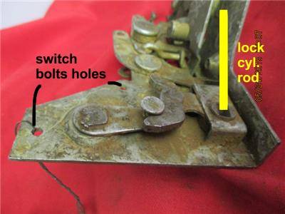

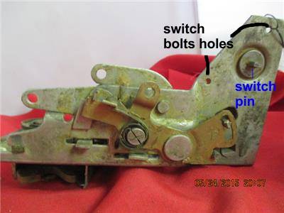

Yes, 2 small screws and you can unbolt one of them only if you move the latch ! In any case I have to move the switch away from the door panel because i must disengage the small pin which actuates the switch. I've found some pics of the latch on an ebay sale
