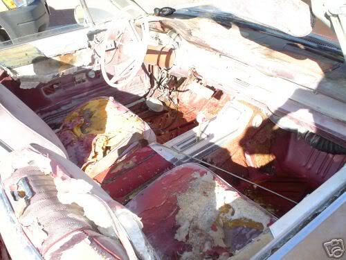

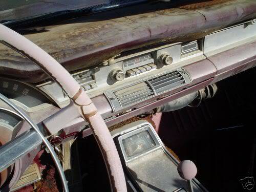

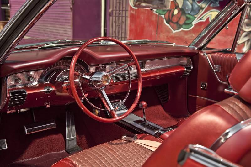

I've got $8K in my interior but that includes EVERYTHING in the interior. The seat upholstery alone was $1,100+ from Legendary. I think you are in the neighborhood with the prices you were quoted. Before and after.
Before:
After:
