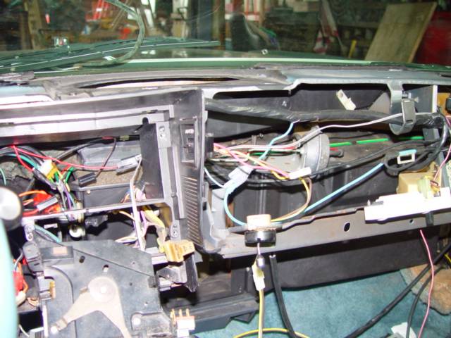

Introduction of New Yorker St. Regis 78'
With the CB radio....

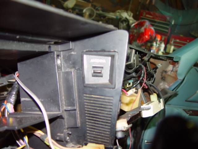

Adding factory stamdard power antenna switch....

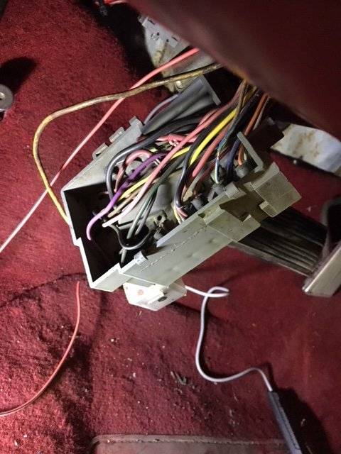

Advertised fun working on a Formal dash....

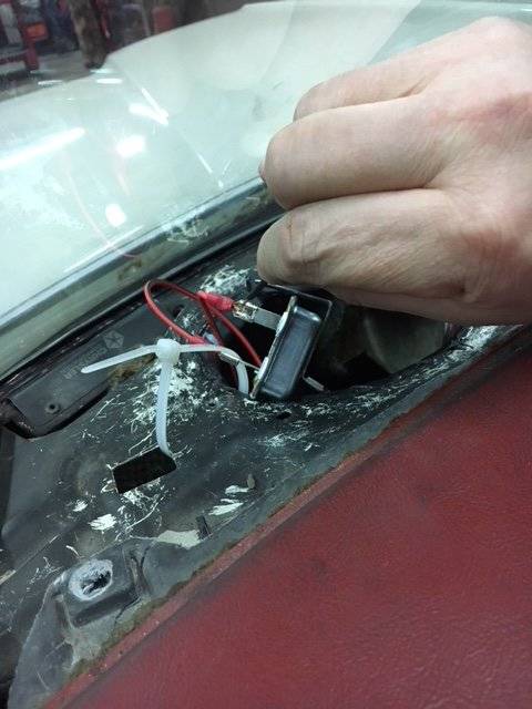

No CB parts or a factory CB antenna exist on the planet. You might be able to find someone in the U.S. to repair the radio. I took mine out and installed a modern aftermarket system so I could run my IPOD through it. Another thing.....you probably don't have a power antenna switch mounted on the dash. I had to fab up an original switch and installed a factory standard formal power antenna assembly. A major pain in the *** but it can be done. I'll post some pictures when I'm not on the phone. Surgery on a Formal dash is not easy or fun.
Bob, is there a difference in the power antennas between cars that were equipped with or without the CB radio function?

Yes....the CB power antenna automatically goes up when you turn the radio power on. Antenna goes down when you turn the radio off. No power antenna switch on the dash if equipped with a CB radio. The wiring harness from the antenna to the radio is different too.

Thank you for the clarification, I was considering purchasing an OE antenna on eBay, but it’s from a CB equipped car, and mine isn’t..

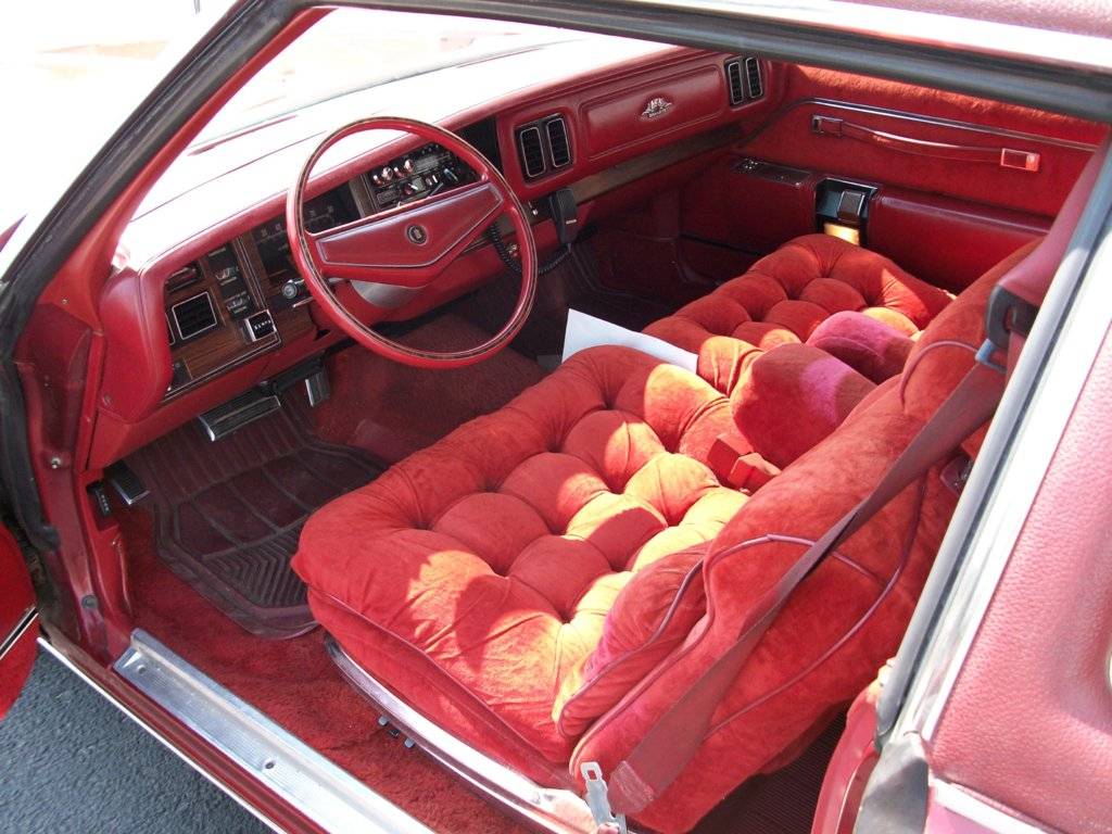

A thousand people using their own camera will take a thousand pictures of the same red interior, and the pics will come out with it being a thousand different shades of red.
Need sunglasses to look at most Formal red interiors. Lol.:poke:
Yup. Never rely on a photo (or your computer screen) when defining a shade of color. Get samples, and compare them side by side.

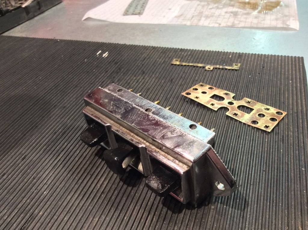

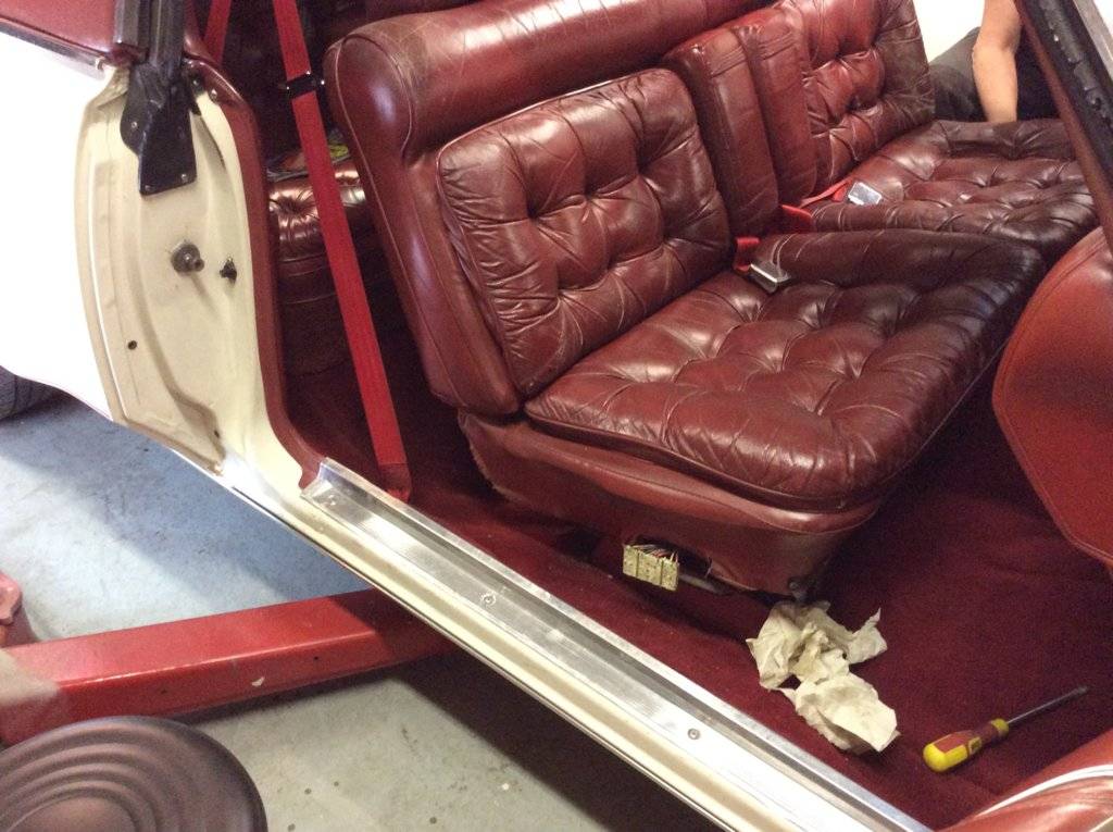

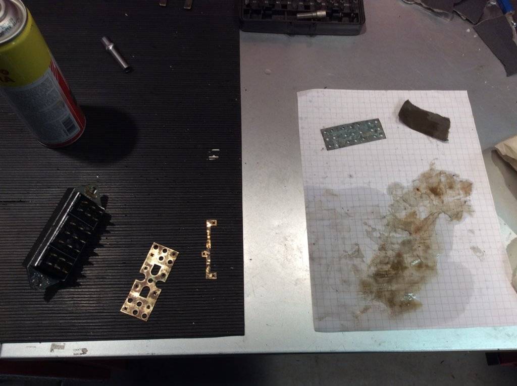

Another project was power front seats. Driver's seat was only 2-way (forward and backward) and passenger seat was 2-way or noway:mad:. I took switches away and cleaned them. Now we have 6-way seats both sides.

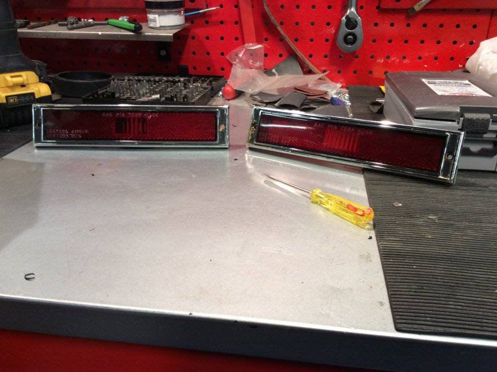

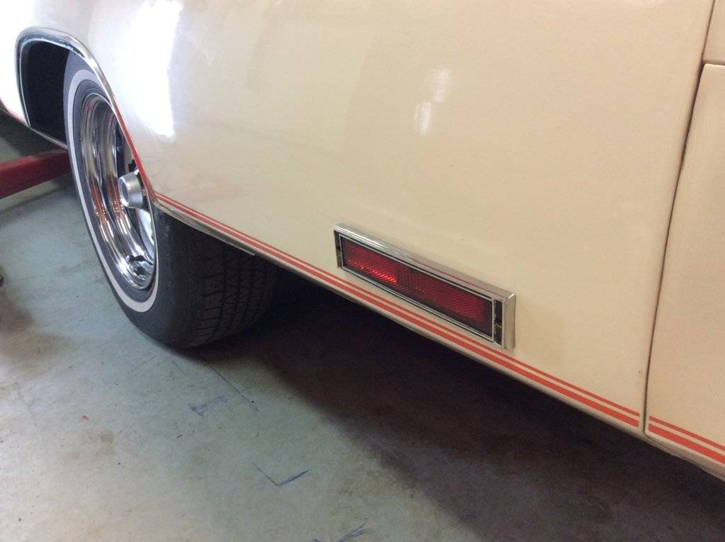

Third project was rear sidelights, I had bought better sidelights from Murray.

Make sure you use some sort of sealer around the rear side marker lights in the trunk area because they will leak when it rains and will rot out the lower quarter panels.
