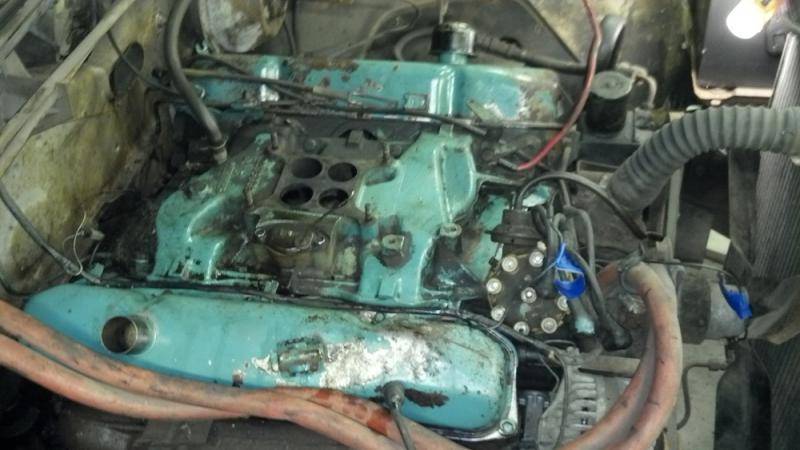

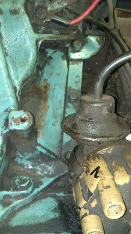

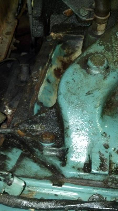

I started cleaning up the top of my 383. I noticed insulation between the intake manifold and the engine toward the back of the engine. In the front of the engine there is a plate and there appear to be insulation under it. First is this insulation suppose to be there? I'm I missing a plate covering the insulation in the back?
I uploaded 3 photos. An overview,front and back where the insulation is.

Yes, that's factory. Is it absolutely needed? No. I replaced my intake and carb with Edelbrock setup and didn't replace the insulation. It is available new or some guys just make their own. And some choose not to install them at all.
The plate is only on the front section...to allow the air from the radiator to flow over the pad. There is not supposed to be a plate in the back. And YES it is supposed to have a foil wrapped piece of insulation under the intake. It was mainly there to help keep noise from the cam and lifter to a minimum. Many choose to not intall it.
