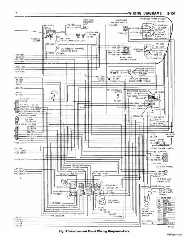

Anyone able to take a hi res photo of the wiring diagram for the turn signal circuit inside the steering column? 70 fury, no cruise or tilt.

Here are the ones from the 1970 Plymouth Factory Service Manual
