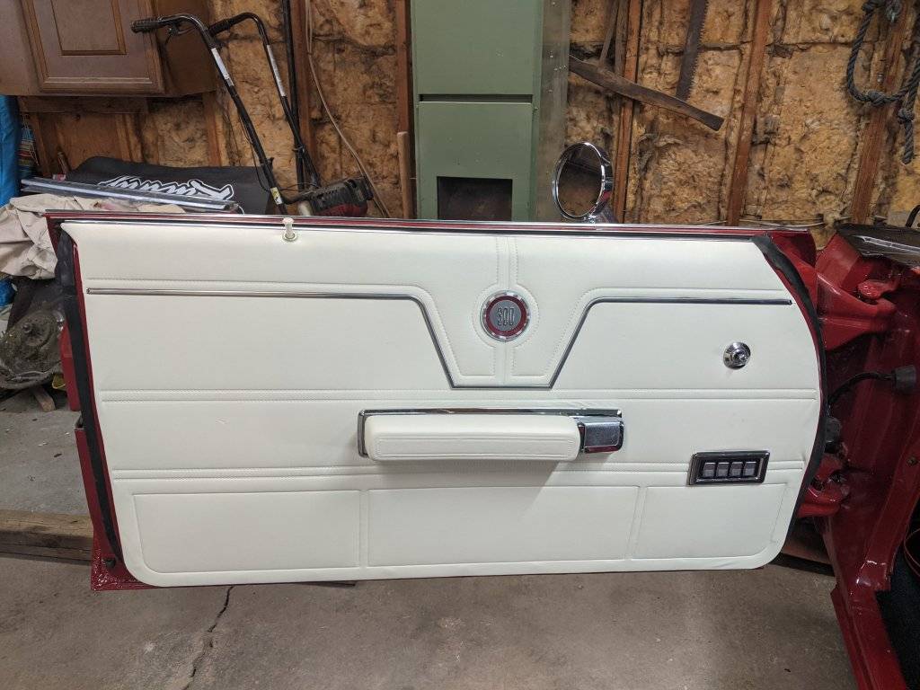

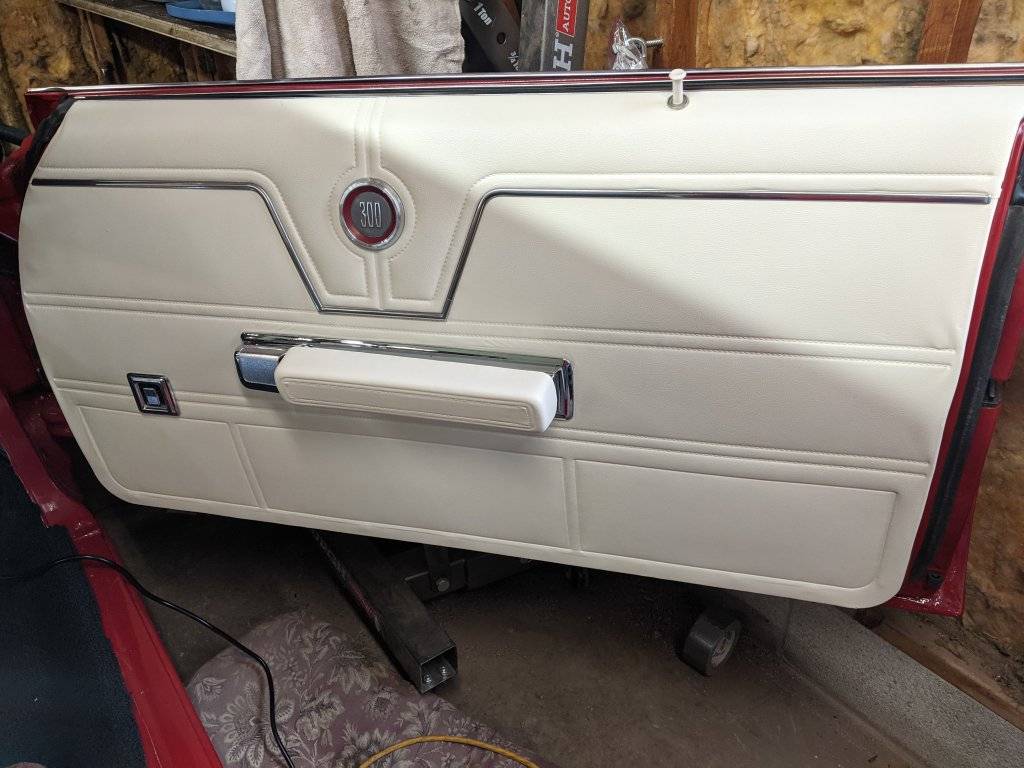

SMS Door Panels (?) - if so, how long was the wait and did they renew the front door panel emblems?

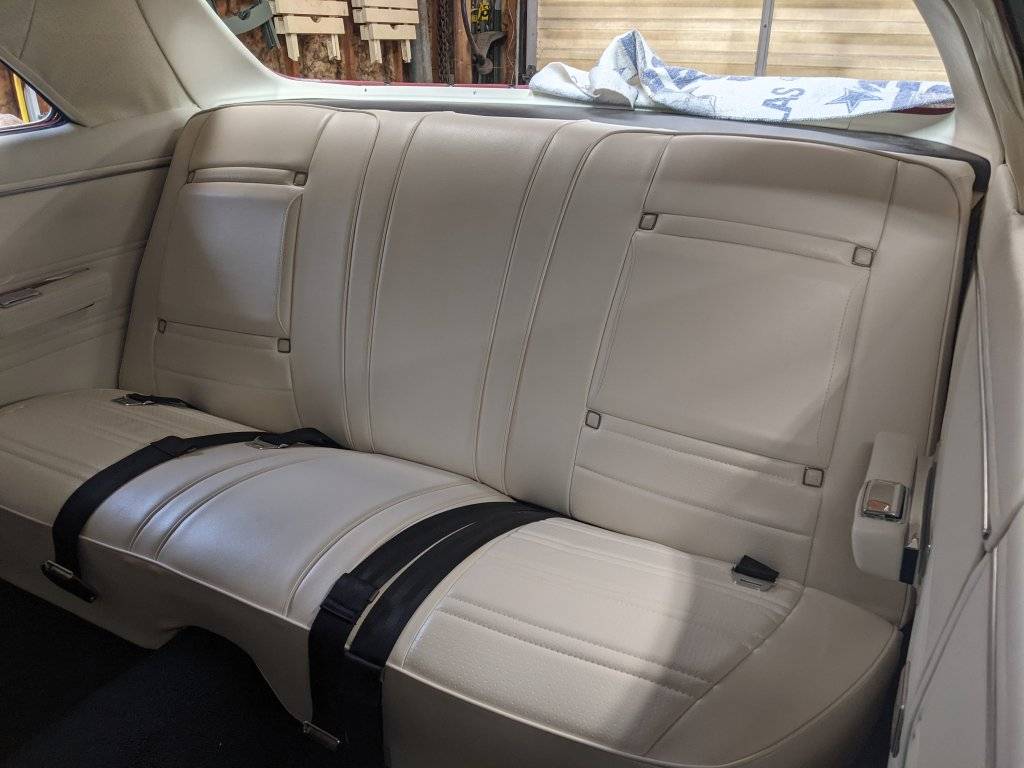

Legendary Auto Interiors for the seat covers?

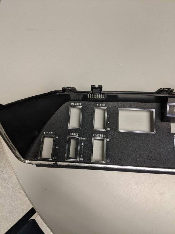

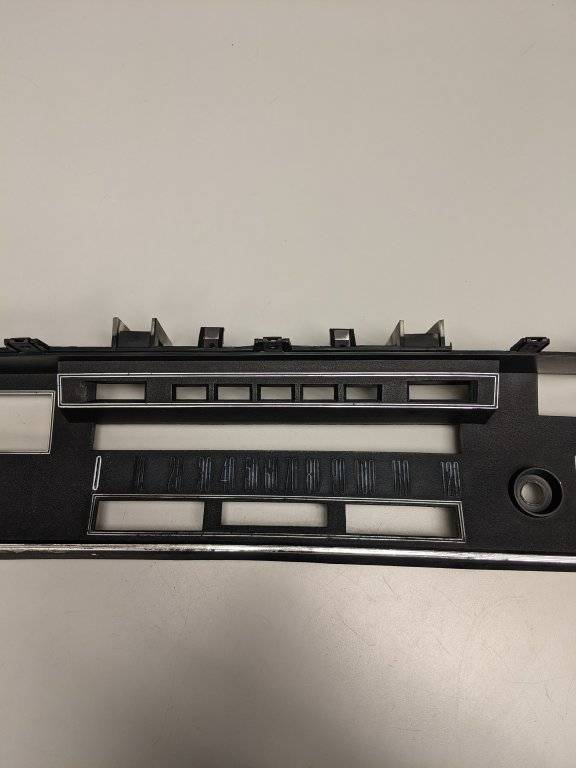

Is the dashpad original or was it redone by Just Dashes?

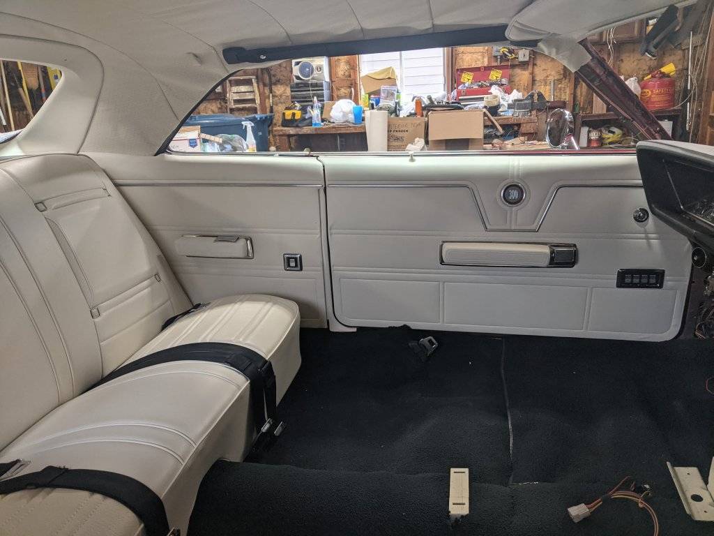

Ok, here goes
Door panels original, they are in very nice shape luckily, re painted with Herbs paint

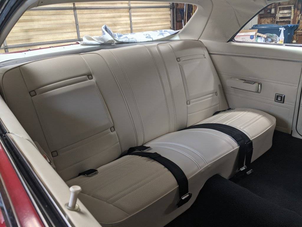

Legendary seat covers
Carpet..Rock auto, great price, but it is ACC carpet
C pillars are original, repainted with Herbs
Armrests, front are new fron ABC, rear, original, repainted. I wanted to keep the ash tray style
Trim at front of rear panel, original, repainted.
Headliner I think was from Josh's, can't recall, I'd have to dig out my records

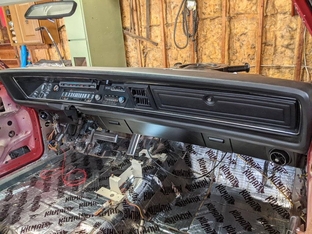

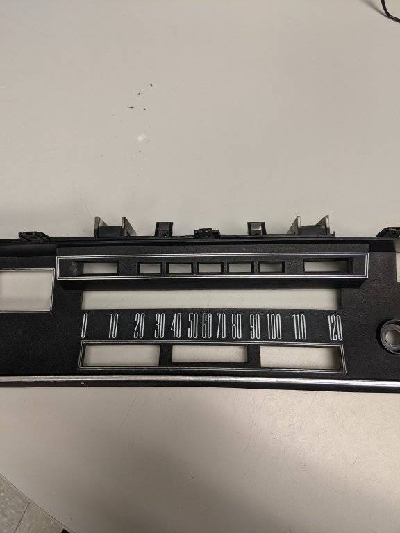

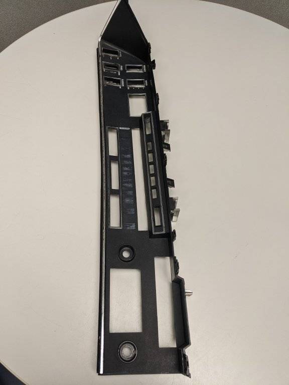

Dash is original, repainted.

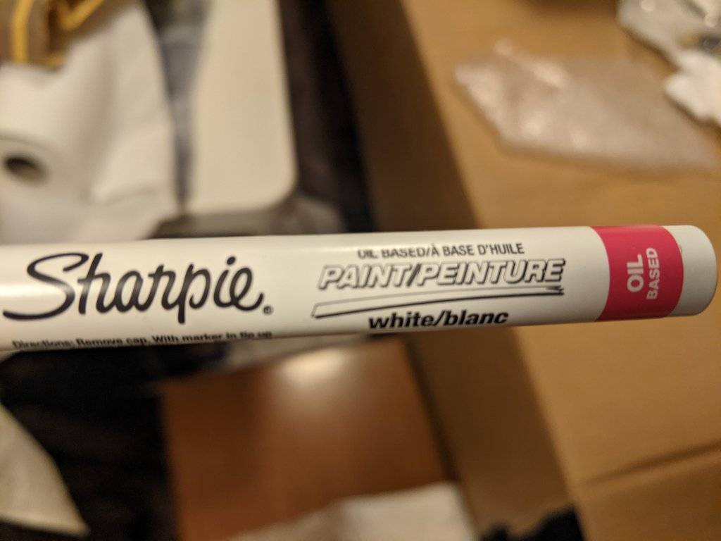

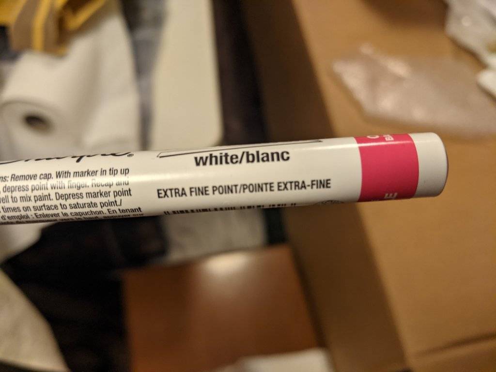

I did use paint sticks to redo the lettering, tedious, but cheap ..lol
Overall, much of my interior pcs we're in very good shape, so I just repainted most.

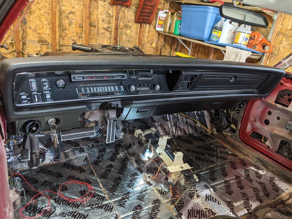

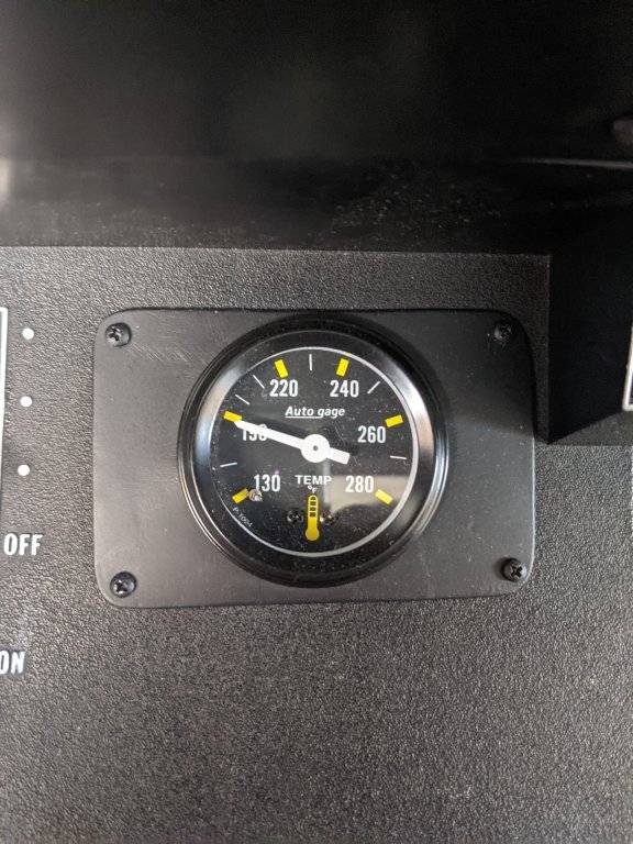

Dash pics added

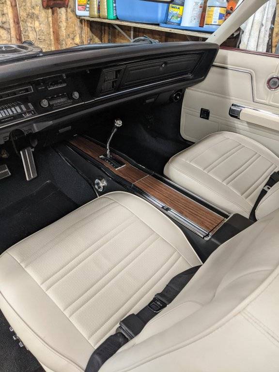

Hoping to get front seats, console, and steering wheel in this week.

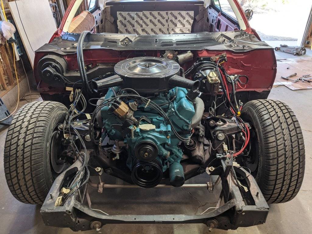

Then on to the front end. Rad support, fenders, etc. Engine has been rebuilt to stk, and broken in, so I can just plug and play I hope. So far all electrical has proven functioning.....
Also seatbelts, I bought material in line, $50 odd dollars, then took it to a local upholstery shop. They took original buckles and sewed them in to new, about $60...so that is definitely the way to go. Also got the new stretchy mat' l for the shoulder belts sewed on too

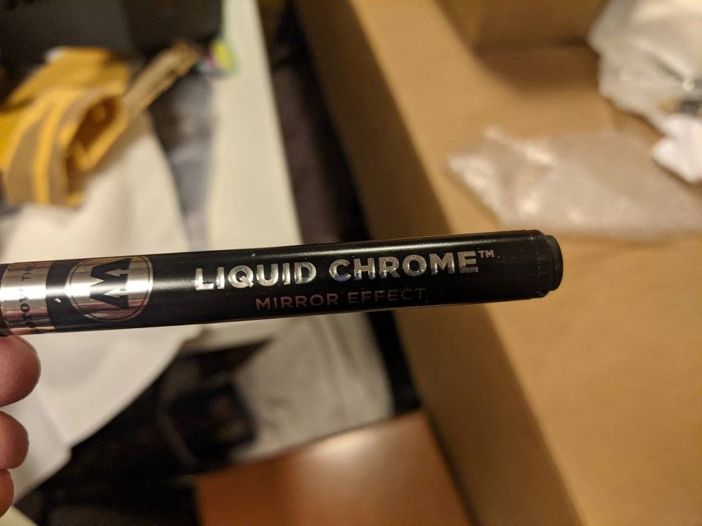

What is a paint stick - I am not aware of that term although I have used paint markers from hobby shops that seem to work pretty well unless the raised letters/numbers are for some reason worn away some or were never that good from the factory molds?

Paint stick/marker..I got them from hobby lobby. White and a chrome. You can get them with different tips, fine to wide, just like a marker, but paint filled.
The sound deadener was easy to install, and according to some research, best $ value. I'll know more once I drive it.
Original roof only insulation is about $135....I did the whole car, roof, doors, floor, and I did on the inside of the trunk divider also, for about the same price. 2 boxes of 36 SQ ft if I remember correctly.
OK then, I also have the ink pens in both white and chrome from Hobby Lobby as well, so we are on the same page then on that. Which tip did you find worked the best on lettering for you?

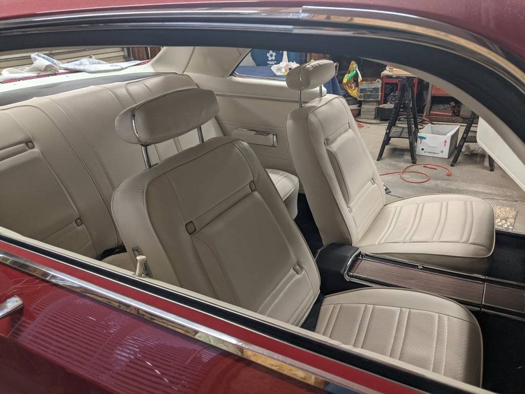

Looking great. Looks like you are not to far of from getting it back on the road.

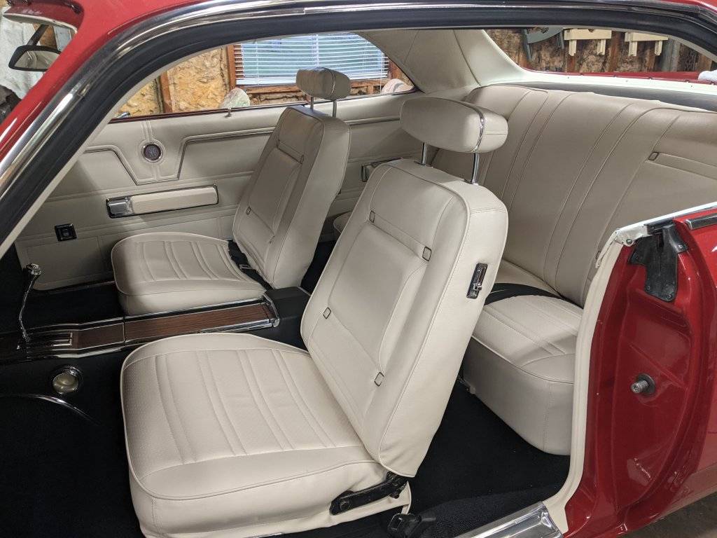

Front seats and console.
Shout out to detmatt, for the console. Repainted and looking.
good!

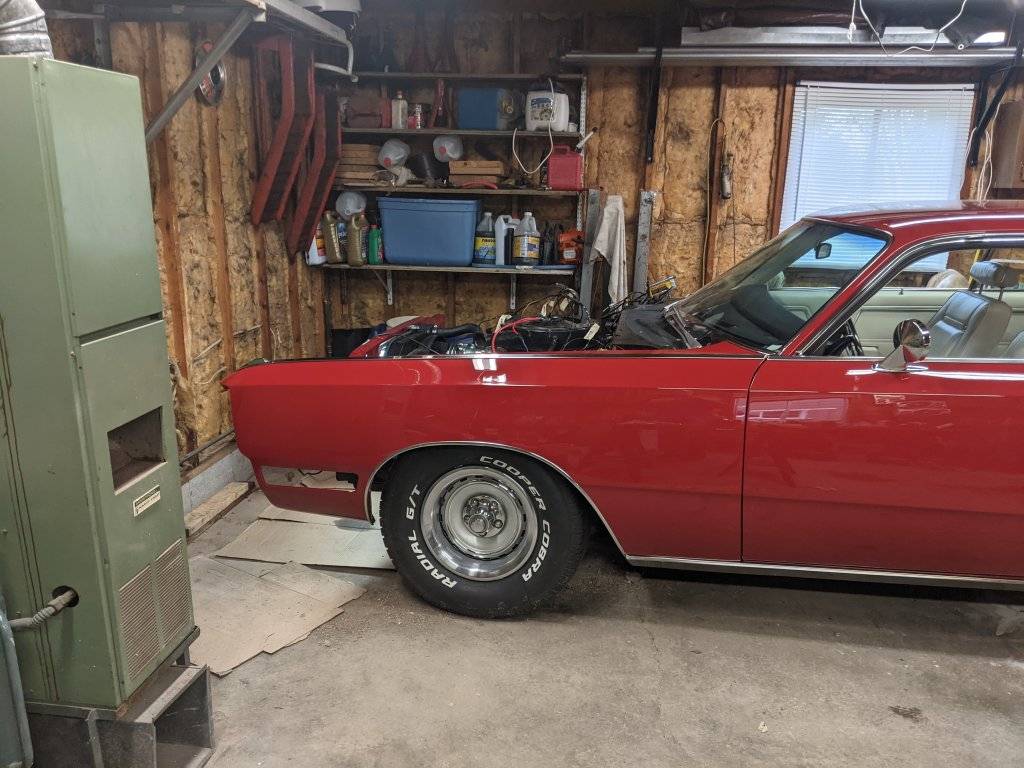

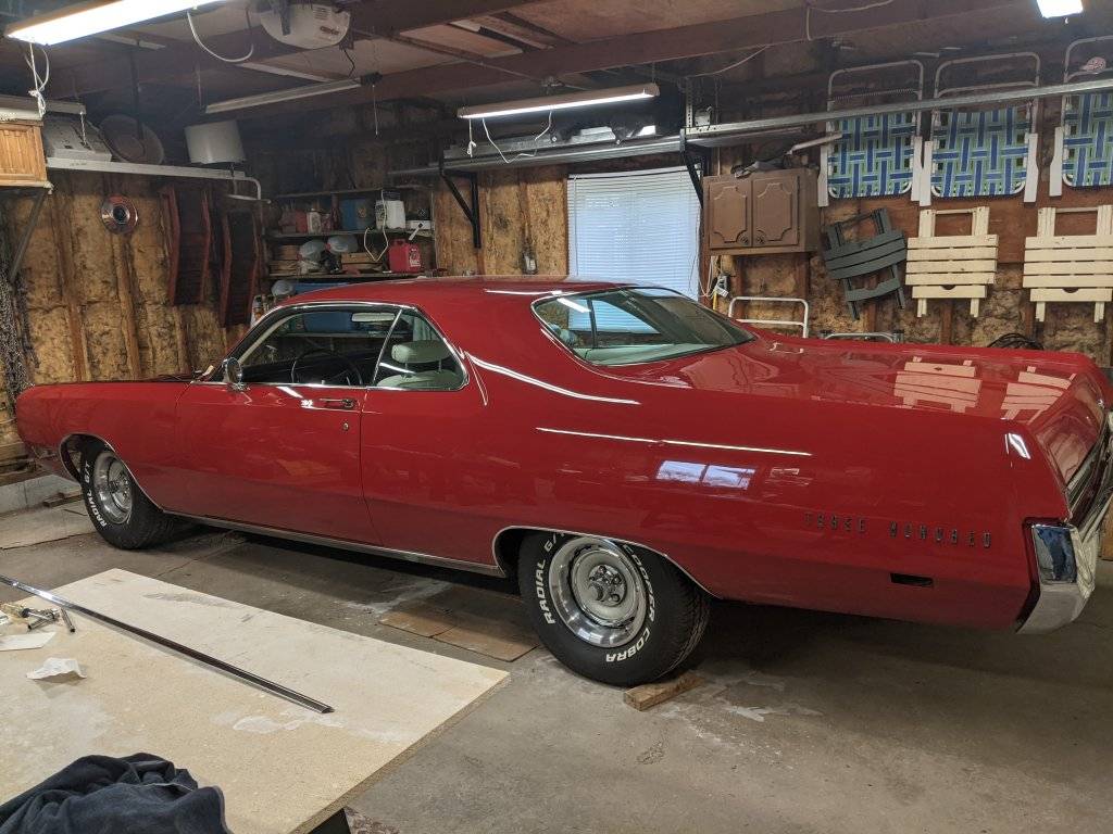

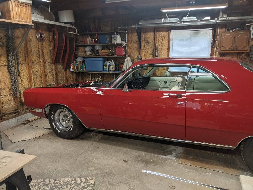

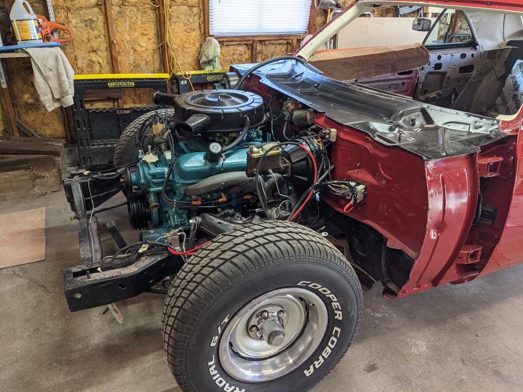

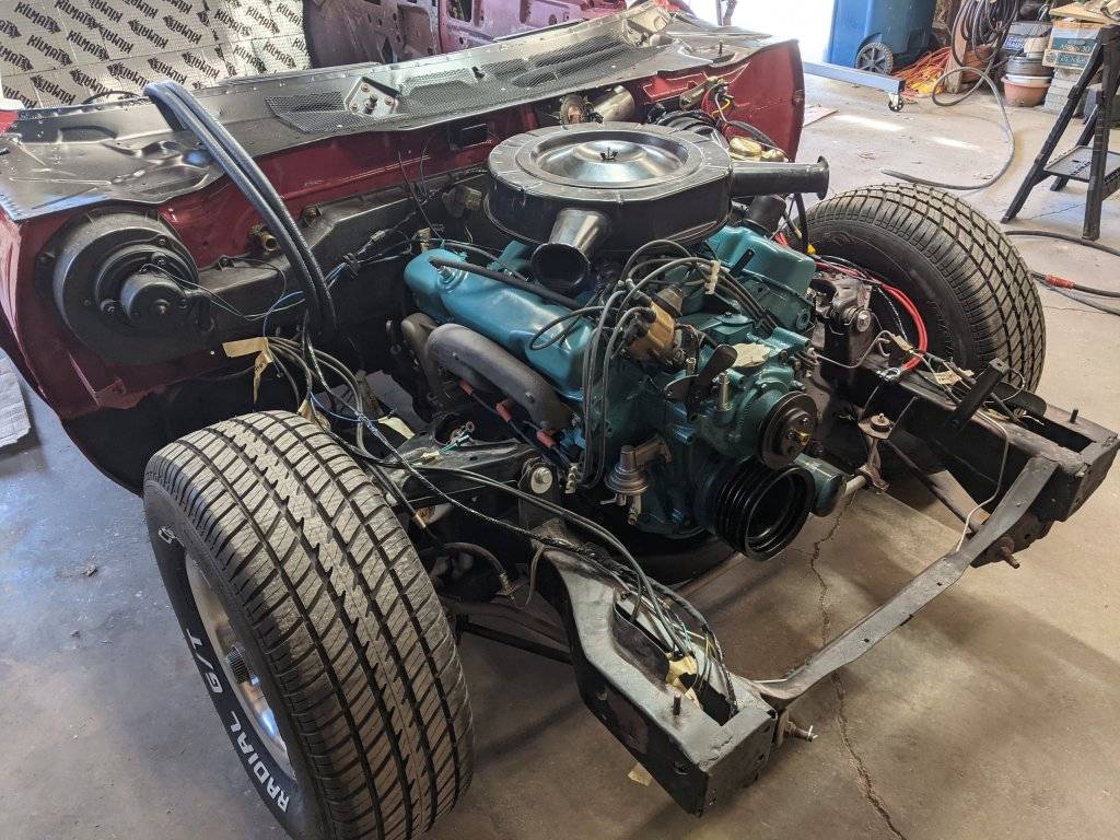

Update!.
Left front fender, inner fender, rad support in and dressed out. Engine fired up, running a cool 190. I'll get it turned around now that it's under its own power and get passenger side caught up.
