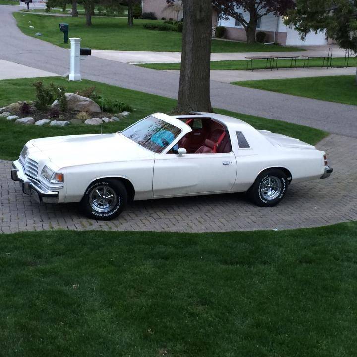

I'm glad you got it together, even if it was a tourtous path! Now you can enjoy the car. I used to get all Gung ho to rip something apart and rebuild, but then I realized that changed it from something of a hobby, to a pain-in-the-*** w/a deadline. Now I learn to "Enjoy the moment".
I'd love it if my Magnum had a stroker small block w/aluminum heads, cam, etc. There is no reason I can't do that, but I've enjoyed thousands of miles of thumbs up and wind in my hair with just a humble 318.
