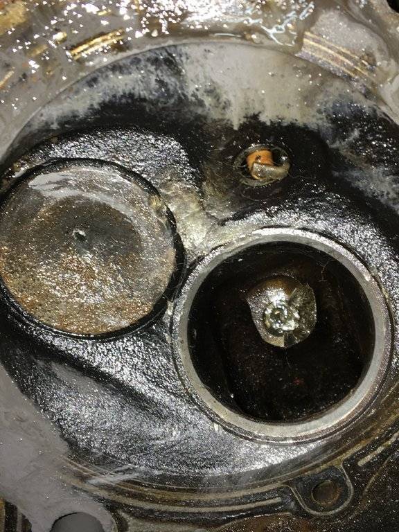

I put a camera in the intake and it looks like the piston is holed. I can feel damage on the top of the head. Had a buddy stop by and we just couldn't resist pulling the intake off for a peek. No time yet for a head and I have a truck to get ready for an AACA show tomorrow.
I might get the head off yet this weekend depends how the exhaust manifolds come off. Took a crack at it last night and they were not easy but a couple came without heat.

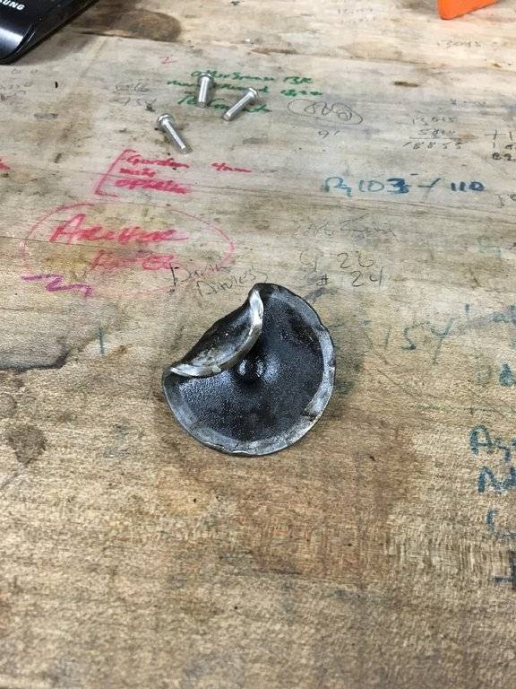

Got the head off. Piston is a little banged up. With a little JB weld it will be as good as new. Back on the road tomorrow if there wasn't a big chunk out of the cast iron where the valve goes through. Might have to braze in a little cast iron. Might not get it back on the road till Monday.
Block appears to be intact and should be rebuilt. If you are going to rebuild it, be sure the re-builder checks the rod on the damaged piston for alignment as it could be bent. The head should be discarded.
Dave
Clean the piston, if that's a hole you need a piston. Remove the rest of the valve stem, clean the head, if the boss around the valve guide has a piece missing clean it up with a die grinder. That boss gets reshaped all the time when heads are ported. Have a machine shop check the guide. Best of luck.

View attachment 127977 View attachment 127978
Ouch!... looks like it took a bite of the bore too... I can't see how an era correct replacement would change the value of the car, and if you have no desire for the 318, I would guess you have a fair amount of mix and match swaps possible... IDK too much about engine interchanges of that era. Are A and LA blocks a bolt in change? If a bolt in, nothing wrong with a temporary engine that's easier to find until you sort out the rebuilding/replacing of the original.
I hate that your off the road in this one, please keep us informed.
I'm pretty sure the bore is ok. I couldn't see or feel anything on it. Since it is summer and I have cars to drive, not fix this one has to go sit in the corner for the summer
