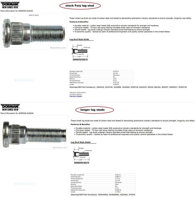

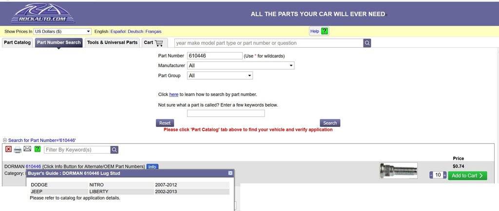

Anyone know the stud size, knurl size of the 8 3/4 diff axle studs with drums. 1967 fury 3. Need to go a little longer, could pound them out and measure the knurl but I have the interior out redoing and running out of time, just thought I would ask
