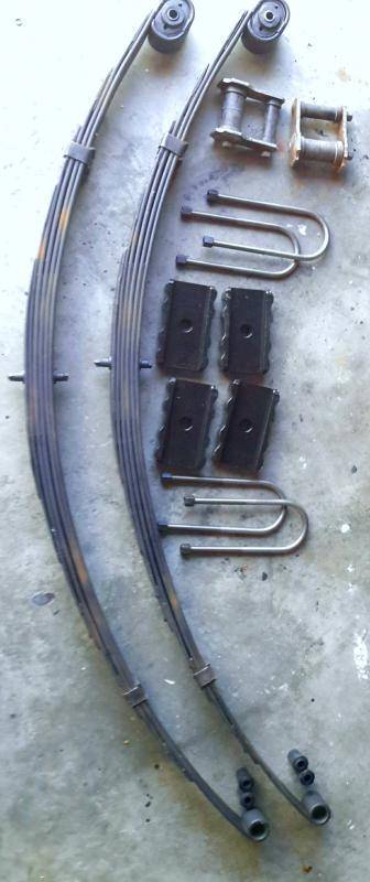

Do me a favor.
Take pics of the chronological order you do your spring swap as a reference for me.
I want to do this in 30 minutes or less. :D
I'm thinking I can do this without even unbolting the shocks. :poke:
Actually, it may take 45 minutes... :D
I didn't stop to take pic's. But it's pretty straight forward.
Car on stands.
remove lower shocks from mount plate, swing aside.
remove 4 u-bolt nuts on one side.
remove u-bolts and lower plate.
remove 4 forward bushing bracket nuts
support spring.
remove 3 rear shackle bolts.
lower spring from car.
reverse to install.
note: be sure to check fit of alignment pins in the new springs with the holes in the axle mount pads and lower shock plate.
note 2: Do not tighten anything until both sides are in place and aligned.
