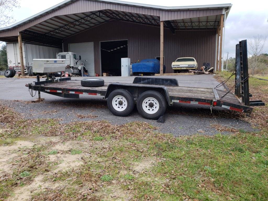

My preference for an open trailer...
Depends

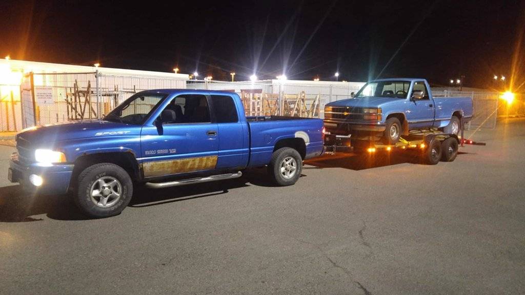

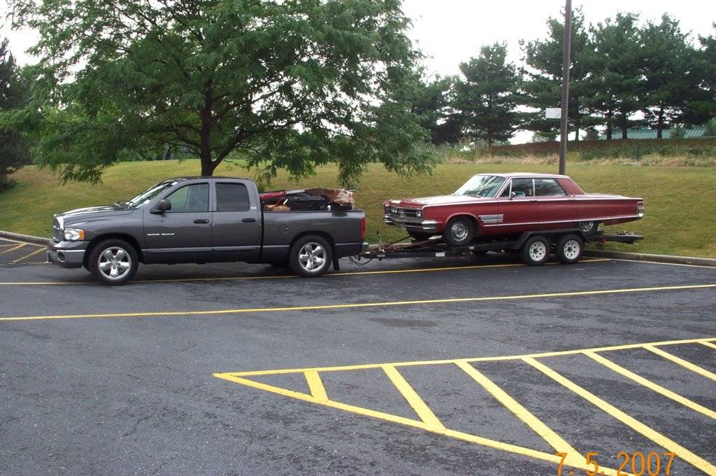

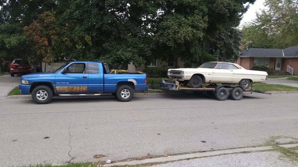

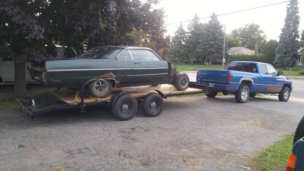

Mine trailer is a 20' dovetail. 2-7000lb axles, 86" between fenders. Its heavy, but it hauls whatever I can fit on it. From my Fury's to a Cat 287b (about 12000lbs with a bucket and grapple). I tow it with a 2001 Dodge 2500 4x4. It handles it fine. My boy hooks it to his Dodge 1500 he can go coon hunting with his headlights.

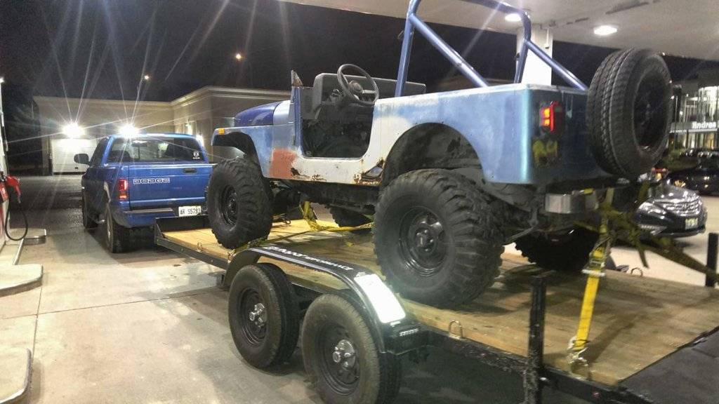

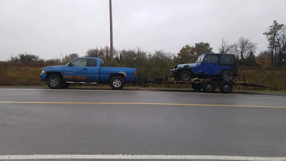

Here's mine. It's a 20 foot steel deck with a winch. One thing I like about it is the axles are set pretty far towards the rear. It never gets the tail wagging even hauling a car backwards. Oh and as Stan will tell you the most important thing you want on your trailer is road wheels. :lol:

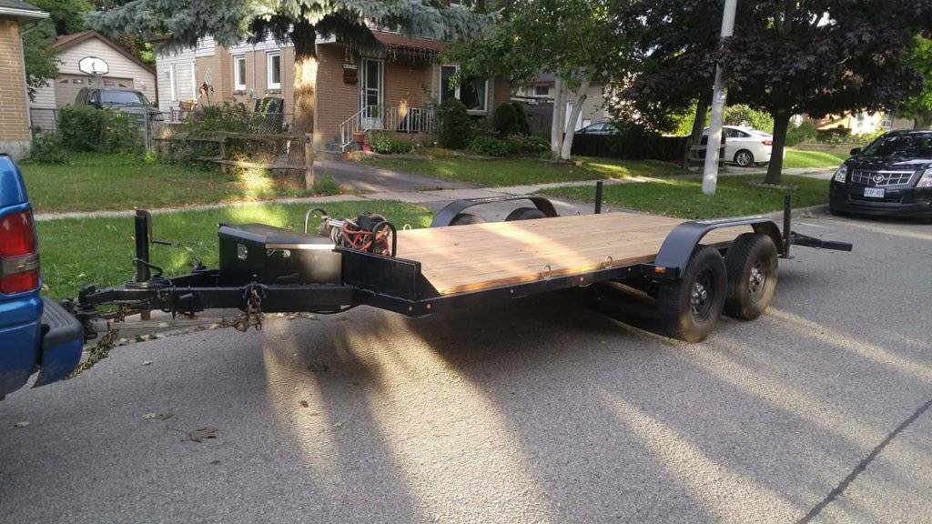

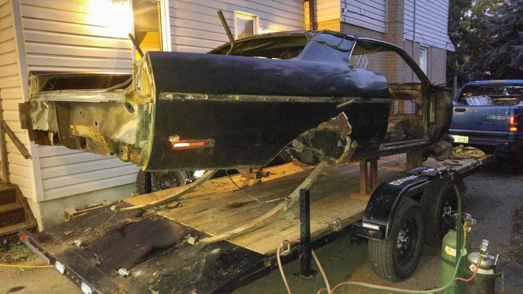

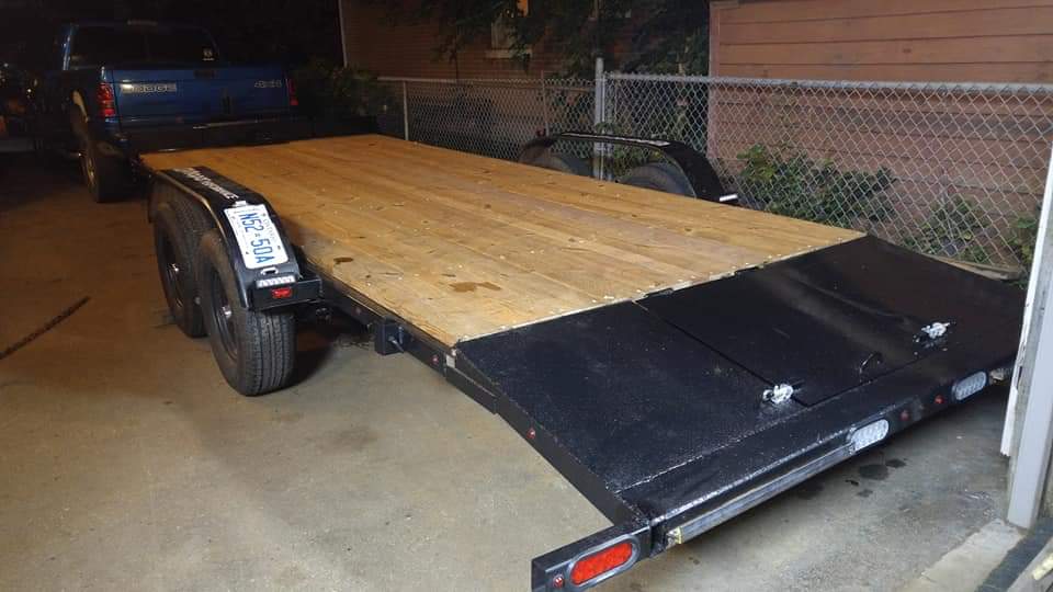

My trailer has an 16 foot deck with a 4 foot beaver tail. My ramp angle is 15 degrees exactly.

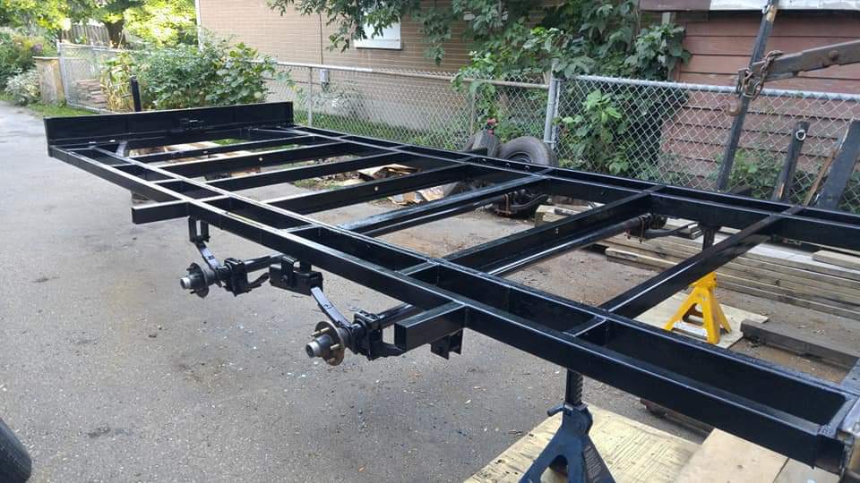

I built it myself from 1/4" wall tube, my cross members are every 16", I have 225/75R15 Goodyear Marathon tires on 6 inch rims, it has a HD slipper suspension, the axles are 3500lb with 10" Electric Brakes on both sets, it is all LED, the beavertail is 1/4" plate steel, underneath it is overly framed.
Basically my trailer is complete overkill, I built it so that if I ever want to I can put 5200lb axles or 7000lb axles under it....

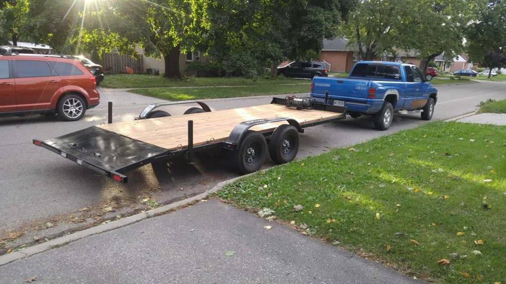

My deck is pressure treated maple...I previously had non-pressure treated maple and After 4 years it looked the same as it did the day I put it down, every day at work I see 7-8 year old trailers with wood decks that still are in good shape. The initial cost to go with a steel deck is prohibitive for most, and putting down OSB is a half assed way, every single thing you load isn't the same size, at the end of the day I can load ANYTHING on my trailer and not have to worry about it being strong enough in that spot. Track width is not an issue. I can load a lawn tractor or a 4x4 with 35's on that deck.
