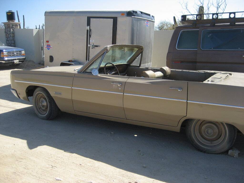

hard to tell from your picture but the height looks about normal. Inspect the front-end parts for wear, replace what needs to be, Then adjust accordingly

First of all, we have a four door with the roof cut off. Has the car been reinforced in any way?
Second, this car and others like it have been rolling around for 50 plus years over the bumps you describe. If it's bottoming out, A you are going to fast or B parts are worn.
Third , The torsion bars are there as an adjustment for level in ride height, not to raise the car 3 inches.
Fourth, the suspension has likely never been replaced. Replace all suspension parts including rear springs and shocks.
If it's still bottoming out, slow down. If that's not good enough, bag the whole car or stick a four wheel drive frame under it.
Haa! I won't go that far. You're right- suspension has never been done. I was told (mostly by my dad) that if I cut the roof off the first dip I hit and the car's gonna bend in half. It's actually just fine. No bendy. I don't think I need any reinforcement. Proof is in the car. I've driven the shit out of it and it hasn't changed. The door reveals are even, the frame still looks straight.
I'll be damned it is a 4 door with it's roof cut off! Do all the doors open and close ok?
I thought the height was within reason too. Are those 14 inch wheels>?
the doors all work. Although we mostly dukes of hazzard the rear seat and only use the front doors. I do have 14 inch wheels. Might be my suspension is so worn and tired that having the extra bodies in the car pushes it down too much for the speed bumps. It's never a problem with just the driver.
