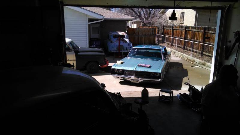

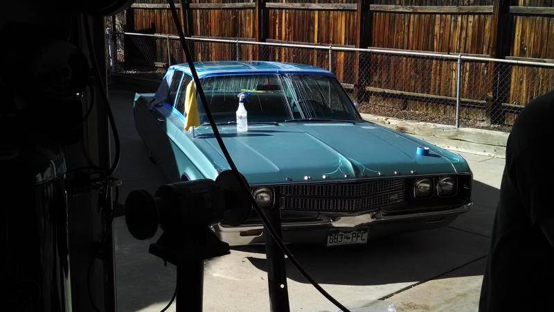

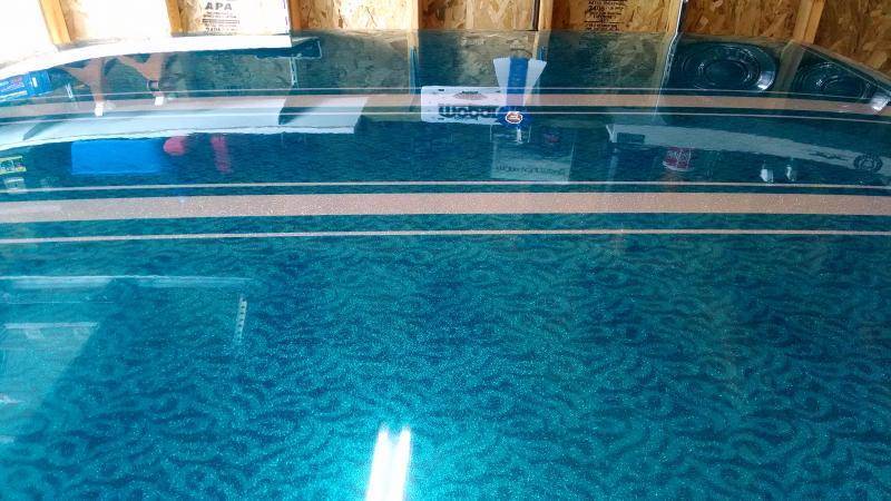

Finally got around to wet sanding and buffing the roof out. Came out pretty well. No sun shots yet, but you can see mirror like reflection in it now. Before it was a little orange peely and blurry.
Sorry for the small pics. Photobucket wouldnt load up for some reason.

A question about technique: You used the lace as a mask for painting, and then pulled it off, right? If so, did you have to do any prep work to get it to pull cleanly?
We waited about 20-30 minutes after we shot the kandy before we pulled the lace off. It just came right up, no issues at all.
