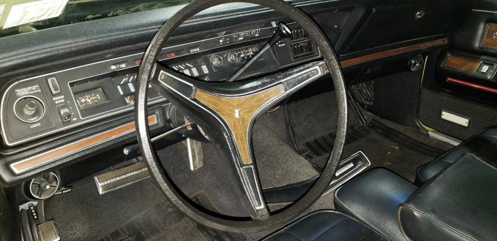

Thanks to @71Polara383 Buttercup once again has a functional horn. The original rimblow steering wheel was cracked in multiple places: repairing it might have been an option except that, despite months of searching, I could not find the switch needed to fix it.
For safety and practicality, I therefore decided to replace it with a 3-spoke wheel from a regular NYer. The « new » wheel is technically incorrect for a 1972 NYB (a non-tilt rimblow was standard that one year) but would have been correct on a 1972-1973 NYer and on a 1973 NYB (the rimblow became an option on the top Chrysler once again in ‘73).

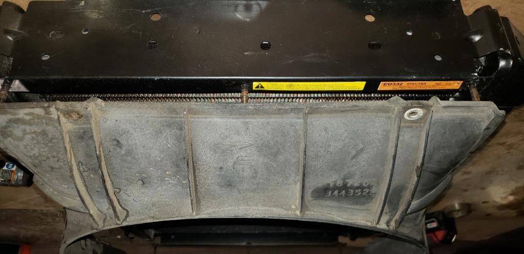

Work keeps progressing on Buttercup, and she is now undergoing road testing by @71Polara383 after getting her radiator replaced. Assuming all goes to plan, I will take her to @sixpkrt 's 5th C-body Show on June 25 and then (if the stars line up) to Carlisle in July.
Here's the story of her radiator. When Wyatt and I test-drove her for more than a few dozen miles at a time last fall, BC's cooling was OK when driving below 60mph but not at higher speeds. My idea was to replace the after-market unit that was on Buttercup when I bought her, by a Spectra Premium CU 332 26-in 3-core radiators as @Trace 300 Hurst has been very happy with his.
I had bought one of the last brand-new SP CU332 rads sold in the United States last spring (it is not only available in Canada), for my EB7 1970 300 TNT 'vert. However, I ended up not using it after having the TNT's original radiator (P/N 2998970) recored -- so I thought I'd use the CU332 for Buttercup.
The CU 332 looks almost identical to the original 1970 26" rads. I have one in my 1970 N-code Polara 'vert, and it seems to work fine and looks good in that car. At a distance, it also looks fine in the '72. I therefore thought that the SP would work for Buttercup.

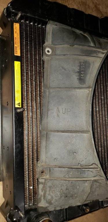

Unfortunately, the CU 332 is not a good fit for the 1972 shroud on Buttercup (correct P/N 3443522): 6 studs vs. 4 bolts means the SP wouldn't have worked without first modifying the original shroud. The following pictures show the issue:

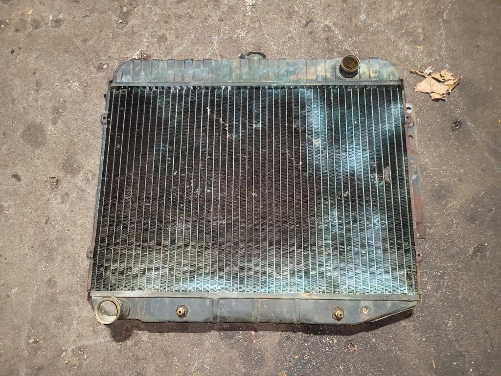

Since I had made a deal with @BLIMP to get his 1972 police/taxi radiator (P/N 3574602 -- see details and pics here), I decided to have the latter recored by Tim at Revcore, a specialist shop in Illinois. The 3574602 is a HD radiator and so I chose the "high-performance" re-core. The cost was very high, but I was convinced to do it for a car with a 440 and likely A/C running in her future.
Here is a photo showing that Blimp's 3574602 rad and 3443522 shroud are made to work together. That is the rad before re-coring.
