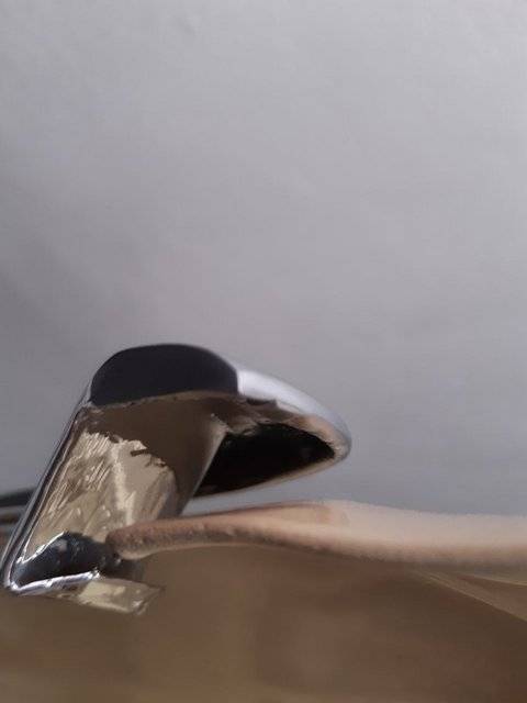

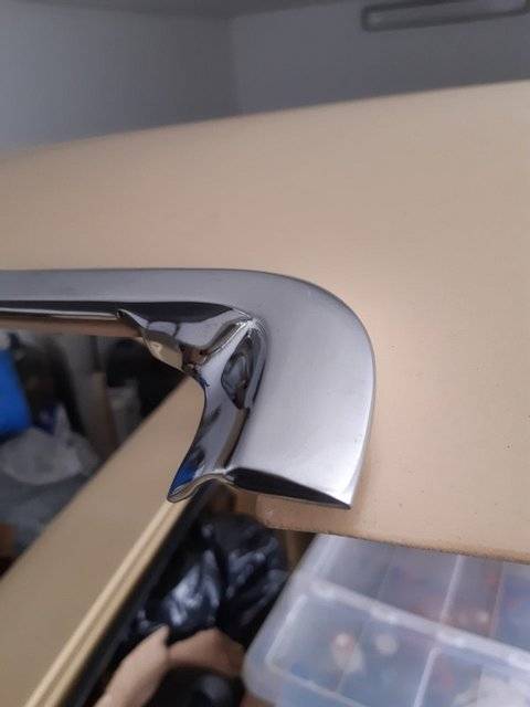

Hi Alan,
would you be so kind and make me a picture of this inner clip once you had a chance, holding the trunk molding? I lost it many years back when making new paint and would like to see the original to duplicate it. I had one brief try in past but I did not figure the shape correctly. Thanks in advance :thankyou:

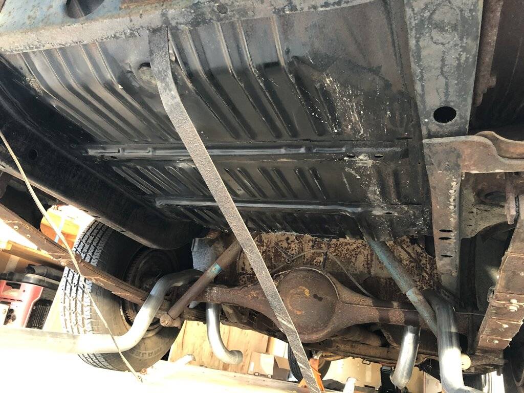

Well still not where I wanted to be at this time.
Replaced the gas tank, it looked like the fuel filter inside.
Will probably be replacing the fuel lines.
The floor pan was real clean, wasn't expecting to see shinny black.
Gutted the exhaust.
Got the correct exhaust manifold installed on the right and went to the left, one of the bolt kept spinning, first thought the stud cam out, upon further inspection it appears it is stripped in the head. Will be looking at a HeliCoil repair, will need to get the kit and a 90^ drill.

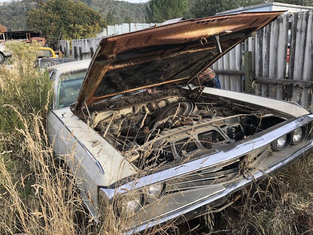

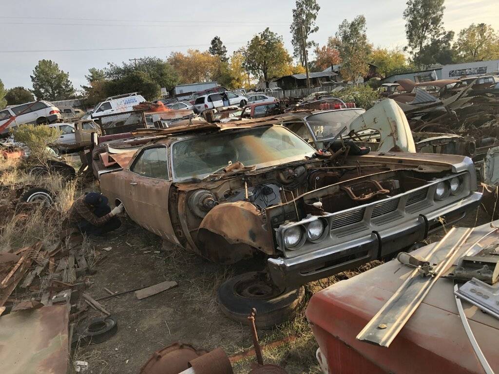

Prior to all this I went to Cloverdale with a friend to look at a 69 Polara 500 that they had, got a bunch of smalls, enough to make the trip worth it. The trip was tied to getting the exhaust manifolds that another friend had.
There was also a Newport that we got a few parts off of
There was also a 70 Polara 4-door hardtop, no pictures

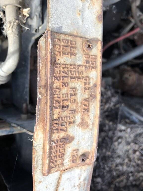

That Chrysler is a New Yorker that came standard with a 440. The H in the VIN means highline, New Yorker.

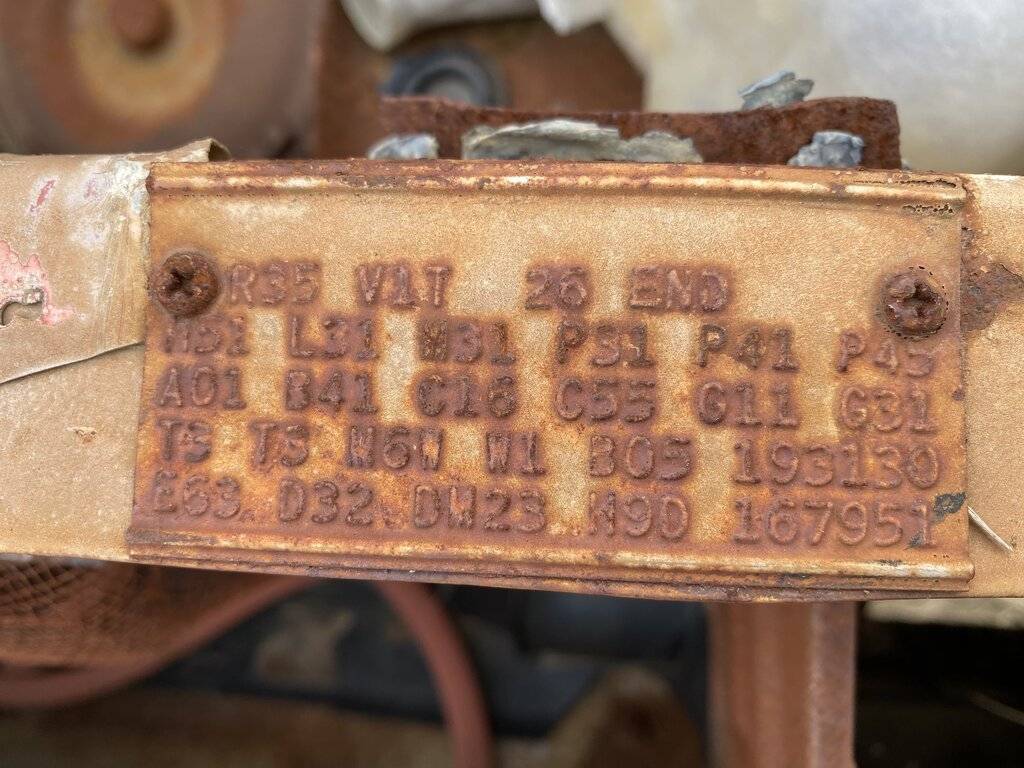

From your trip, we have learned the fate of two more fusies for records: CH41T0C233521 (a 1970 New Yorker sedan) and DM23H9D167951 (a loaded 1969 Polara 500 that was born with a 383-4, fancy R35 radio, T3 Light Bronze paint, V1T tan top, and white buckets/console interior).

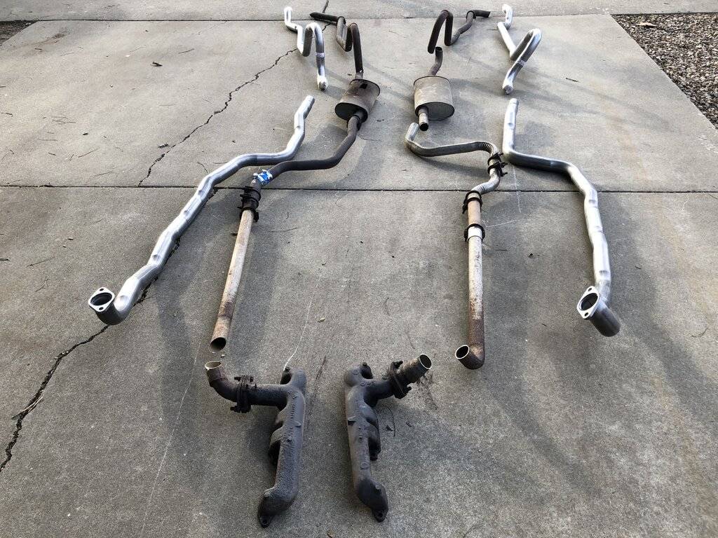

Source for the exhaist system? What length mufflers will it tolerate?
Thanks,
CBODY67
Thanks,
CBODY67
Accurate, this is a copy of an NOS pipe that was given to them by a friend of mine, it is an exact copy, flat spots and all.
2-1/4" tip to tip (factory stepped to 2" middle of the tailpipe)
Muffler (Hemi repo from Accurate) 21" body, don't think there is any extra pipe.
Alan
Alan
Thanks! As I recall from my old Walker Exhaust catalog, the '69 Polara/Monaco 440/375 exhaust was the only year to use the Street Hemi mufflers, rather than the larger C-body case from 1970 onward. '69 was the year a 440/375 Polara 2.76-geared, tall-tires police package set the top speed record that held until it was bested (by less than 5 mph!!!!) by the IROC-Z police-spec Camaro. So, your mention of the Street Hemi mufflers for that system is accurate.

Looking at that Polara in the yard I was trying to see which was more equipped.
I have cruise and cornering lights that it doesn't.
It has power locks that I don't (got all the parts that were there, missing the left lock/switch)
