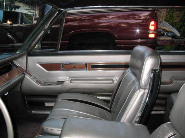

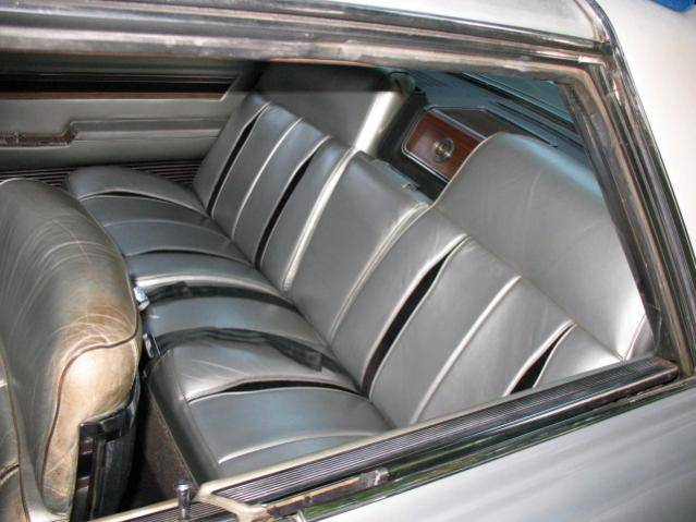

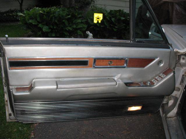

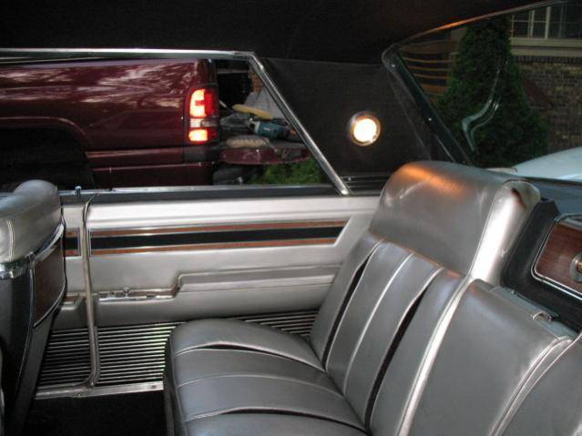

Sweet car, again, I really like the interior, and can't believe it wasn't as common as black. Do you have a sales brochure for it? I have brochures for the '67 and '68 Chryslers (no Imperials) and I never saw silver as an option for the interior.
Matt, I am quite certain this will turn out to be a fuel pump issue. I have had this happen several times to vehicles that have been sitting. Usually the first symtom is the check valve letting the fuel drain back from the carb after you shut it off, the second seems that it won't draw/pump fuel at cranking speed.
Hey Has2b, Thanks for your input, I appreciate it. I had a `68 AVS for a 440 auto that I got with my `68 Coronet R/T, which is a 4spd so I've been looking for a correct carb for it and holding on to this one as a spare. Well it's no longer a spare and it works almost perfectly, I can basically reach in the window and hit the key as long as it's not the first start when totally cold. Fuel pump is fine so far. I did have to put a water pump on it yesterday though.
I don't have a sales brochure either. The fender tag code for the interior is actually called out as gray and black and not silver. There is a silver special code and I would love to see an example of it, if my interior is not silver, I would love to see one that is!

There is nothing Gray about that.....

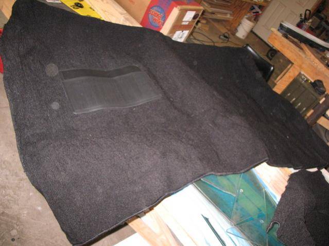

Had to put a water pump on it and replace one of the power steering pump hoses, the low pressure one with the clamps. Ordered new carpet, battery hold down(missing) and the new engine mounts. Took it for its first cruise up and down Woodward Ave (born to cruise the ave). I have basically not driven my work truck since Monday!

Continueing to work out the bugs. Horns didn't work and now they do, just the relay. The switch that locks the window controls for the passengers was innoperable in the locked position and it was assumed that it was a bad switch. I took it apart to get a part # off of it and realized that the plug was just 180 degrees off and when plugged in correctly, works just fine. Got rid of those ridiculous exhaust tips! New carpet showed up and I am very excited to get that installed but it will have to wait till I wrap up some stuff on the `71 R/T. Almost as if the clock's turning back on this car, I just love it!
