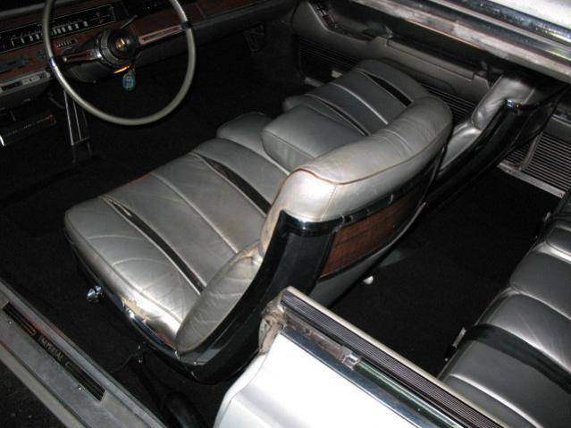

That is a gorgeous car. Like everyone, I love that silver interior. Is there some sort of discoloration on the driver's seat near the top or has that just not been cleaned up yet?

There is some discoloration from the sun there and on the tops of the back seat. Probably will try to get some sort of dye or stain to try to blend it back to silver. Any suggestions for this would be appreciated.

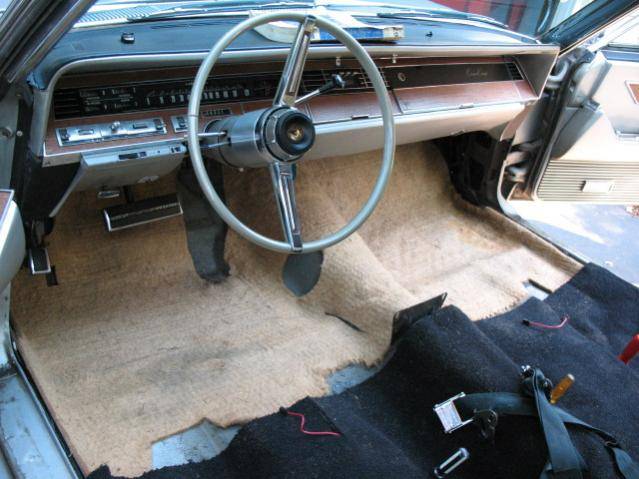

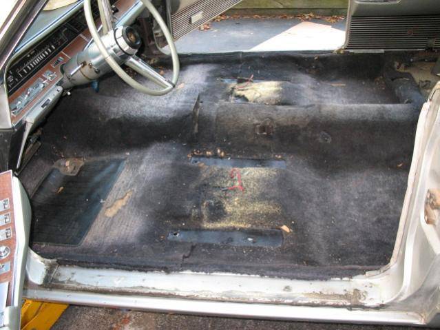

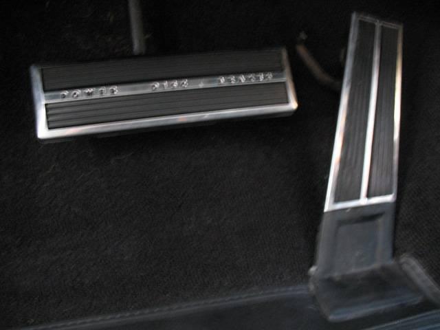

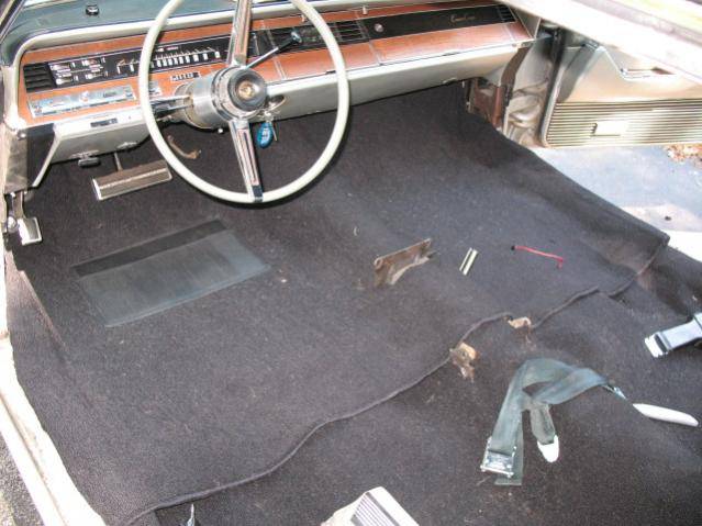

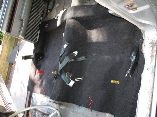

I knew it would take the better part of the day to install the carpet but I worked on it for a solid 10 hours yesterday and it's still not done! Very close though, I got the driver seat, gas pedal and hooked up the new parking brake release switch after dinner and had to quit just as the mosquitos started to get me. More pics of the finished product to follow as soon as it's finished.

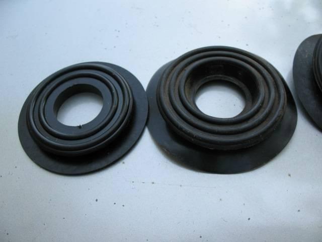

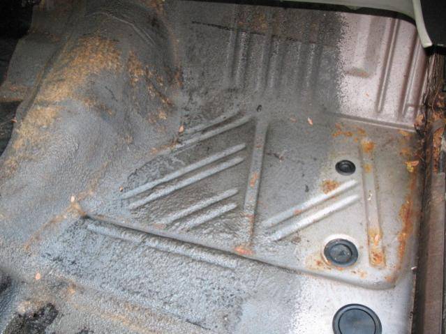

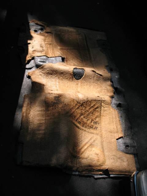

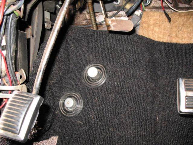

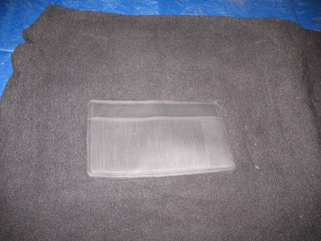

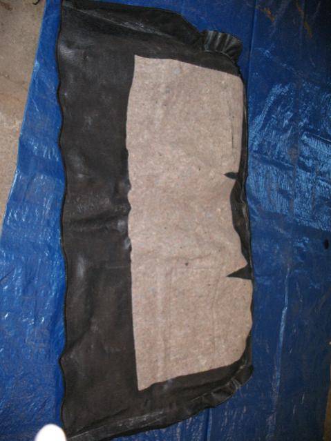

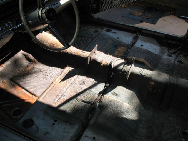

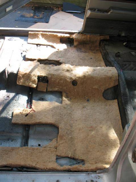

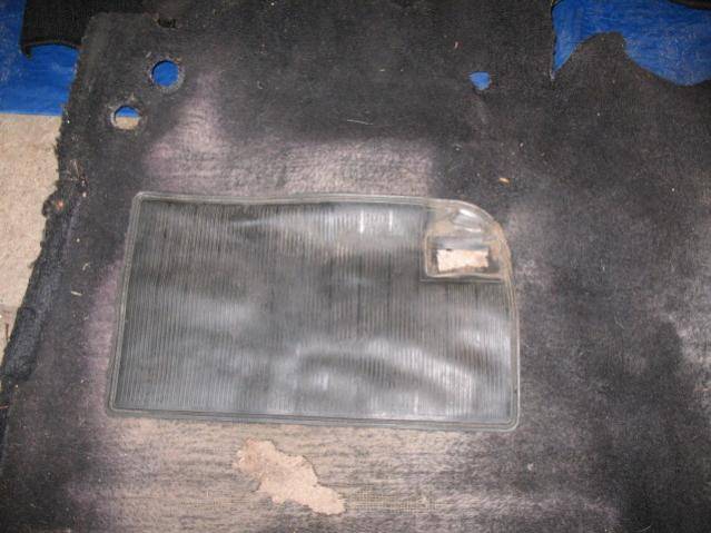

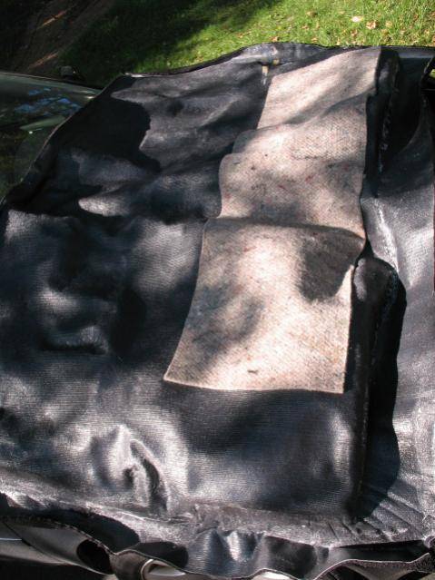

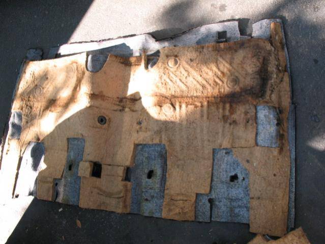

The carpet from Trim Parts fit nicely but had nowhere near as much padding as the factory so I removed the factory jute and layed it under the new carpet. Didn't find any suprises under the rug, just as solid as it is everywhere else. One cigerette but from the factory and a mummified frog, I'm geussing from WA but how the heck did it get in the wiring harness raceway inside the rocker! I was able to reuse the gromets for the headlight and radio preset selector which I'm thankful for as the 1 provided by Trim Parts was far inferior.

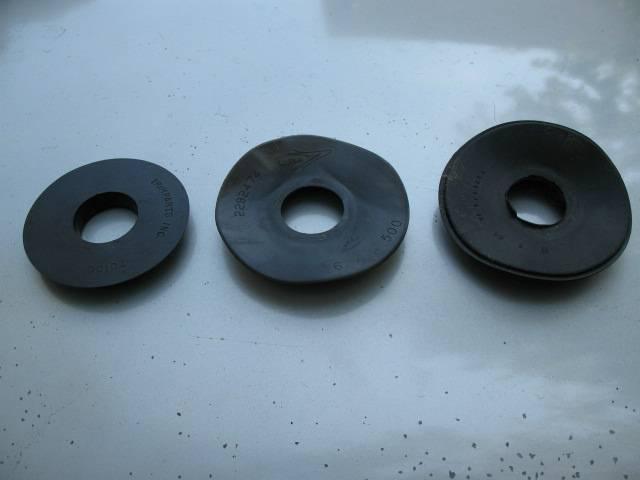

No grommets in the original correct? I see the rubber inlay is a bit different...what company did you buy from?
No, I reused the originals. I bought the carpet from Trim Parts and it only came with one grommet and it wasn't close enough to the 2 nice originals.

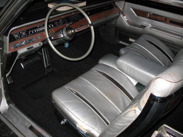

Here's the finished product. I am overall very pleased with the result. I know that these companies, Trim Parts and I think there's another that makes carpet for our classic rides, aren't making these rugs to last as long as the original material. I would say that with the condition that the original carpet was in with 136K miles that the replacement rug would probably be in the same condition with around 50K miles. I do know that these cars are used completely different now-a-days and the repop carpet is probably as good as it needs to be.
Matt, ... I'm having an emotional moment. Somebody makes a product for a formal C-Body! It looks like Tuxedo style of carpet matches what is in my NY'er. Your thoughts? Thanks for the carpet tip!
Looks incredible.....you should be proud.
I didnt think grommets were used at all, none of mine had them from the factory
I d
Several years ago, Mike Lyons, who is known by many in the Mopar world as an "over restorer" returned a carpet to Legendary because he wasn't satisfied with it. Legendary made up a new one and sent it to him. Lyons returned that one too. Finally Legendary called him to ask WTF was his problem. He said "the grommets were wrong"....
And yet I have read an article in a mag that said they never used them. None of my original cars came with them.........
