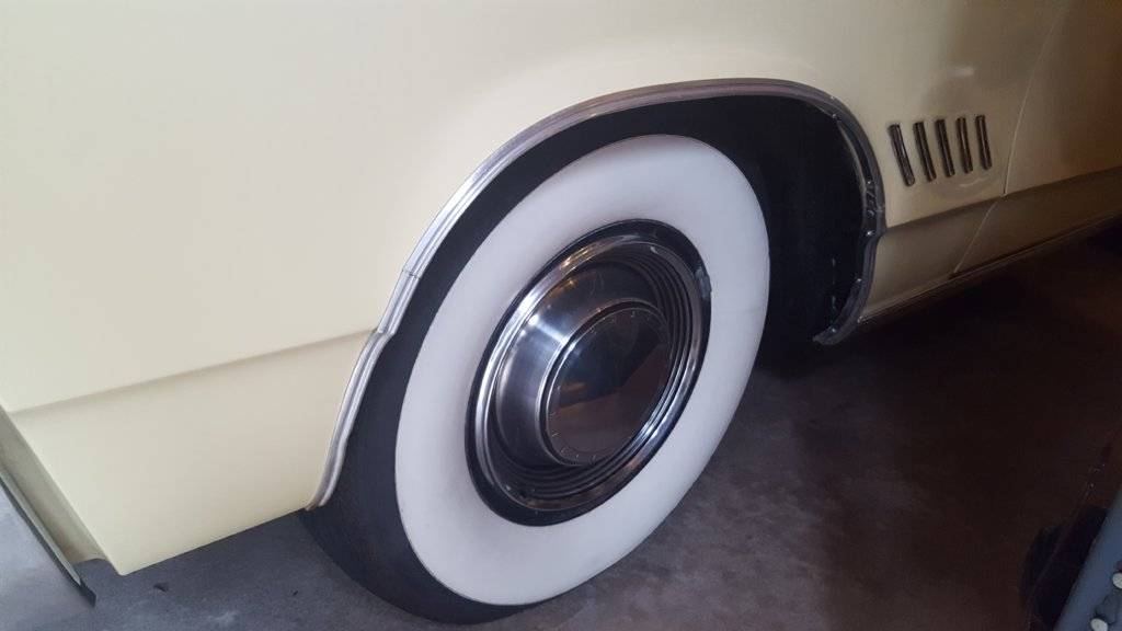

The tires and wheels that are currently on my 68 300 were on the car when I bought it. The tires are huge-L78-15 Coker Classic bias ply 41/2 inch wide whitewall. The hubcaps are from a 69 or 70 New Yorker, nice condition. I would not change them if they were in perfect condition, I don't hate them, but don't love them either. My preference is a stock look. But now the tires are looking very dry and when I checked the DOT code on the back of the tire, they are 14 years old. So definitely time for new tires, radials. I was thinking of 14 inch rims, with 68 300 hubcap( I have neither, so would have to buy them) and white walls. OR 15 inch Magnum 500 style wheels with white walls. It seems from threads I've read that 14 inch white walls, not wide, are harder to come by, so I am leaning towards the Magnums. Coker has 15x6 rims with a 4 inch setback that my FSM says was the wheel size for a car with disk brakes. I know the pics will generate comments...all are welcome.

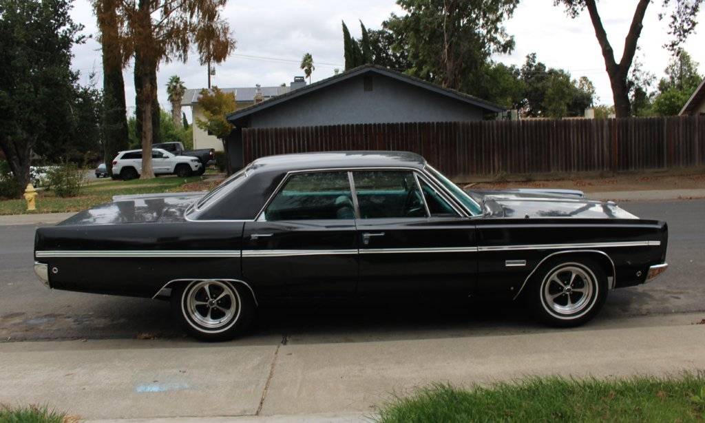

I went with the 15" Magnum 500s (my car had already been converted to disc brakes) with a narrow whitewall. The wheels are polished aluminum - I was guaranteed they won't rust) -unlike the wheels I had on it before which started to rust from day one.
Don't think the whitewalls are hard to come by at all. My American Tire store had them in stock but had to order the wheels. At first I thought they looked too tall but have grown to love the look. It is perfect for the era of the car.

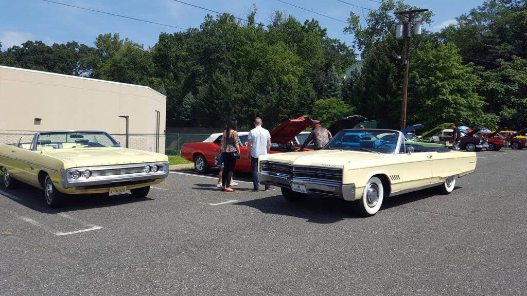

btw, note the whitewall on the Plymouth convertible sitting next to your car in your picture.
There are several things to unpack in your post, most or all of which have been covered by others, but sometimes it's helpful to look at exactly what you're asking for to get to the answer.
As it stands now, you're asking about changing everything in a big block of changes, which is kind of limiting. Why not take the issue step by step?
Wheel size. You have 15" wheels now. There are a greater number of modern tires available for 15" wheels. You might consider just getting new tires for those wheels. It costs you nothing and keeps most of your options open.
Tire size. As you mention, that is not the factory tire size, and except for Coker, the original tires aren't readily available. 235/75-15 is the size most of us run as being closest to original. You can still find them in the (reasonably correct) 1" stripe at a good price. If you go with Magnums and want blackwall or RWL, they are also available in this size.
Sidewall. 1" stripe is closer to correct for your car. Wide whites went out in the late 50s.
Hubcaps. If you just put new tires on your current rims, you can use your current hubcaps while you look for 15" 300 wheel covers. If you insist on "original" 14" wheel covers, you can modify your 15" wheels to accept the 14" wheel covers and still have access to the greater range of 15" tires. Converting Your (Chrysler) Imperial's 15 inch Rims to 14 inch Wheel Rims. You can still buy Magnums later if you want, and will only be out a mount and balance charge.
Wheel Type. I like Magnum 500s, but I don't know how they'd look with white stripes, that's a question only you can answer. I don't know the cost of those or the cost of 15" 300 covers. But if you are set on them, getting tires for your current wheel setup means you're not pressured to buy the first set you see, and you can probably save a few bucks there.
So the only real recommendation I have for you is to go with some version of the 15" wheels. If it were my car, I'd probably keep the current wheel/cover package, get new 235/75-15 white stripe tires and start looking for a good set of 15" 300 covers.
That's the look I am going for, nice looking car.
Thanks. As a sidebar to my original post, I put my car in the shop to fix an oil leak and the owner - who is quite a car guy and restores antique cars on the side - while showing me where the leaks are, told me 'I made the perfect choice in wheels and tires for my car'.

The Hankook has the 1" whitewall look that I like. Thanks. I was looking at the 15x6 Magnums with a 4" setback, I am worried about going any wider because of the fender skirts. In the pictures you can see it's tight. I can barely get my hand under there when I clean the wheels.
