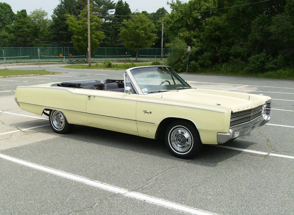

Thanks to all for the informative posts here. Although I don't take my Fury on very many long trips anymore, I like to drive it at least twice a week, especially with top down days getting a little closer:thumbsup:.

Good suggestion. I will do that. I bought these tires because they offered whitewalls. I think these older vintage cars from the past look sharp with the whitewalls but on my Fury, I like the small whitewall instead of the large ones that look better on the '30's through '50's gems.
