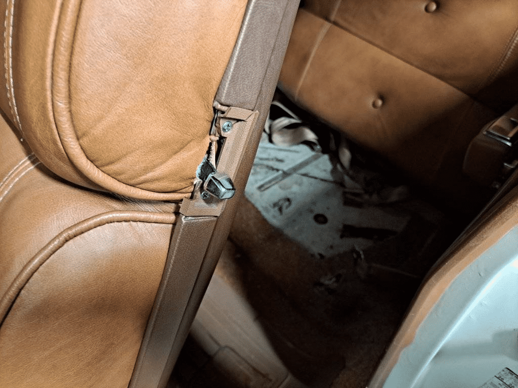

Without a good "escutcheon" (look that one up!) to model from, how do you 3-D this thing? And for that matter, I've never seen a good, whole, unbroken "seat release thingy" on the 12-odd Hursts I've inspected. EDIT: 13 including David's! :poke:
e know now, I'm betting the one that you do have was in that seat when the car left Jefferson.
Okay, let's get back to David's new Pride & Joy.
the 3D print part isn't hard. The trickiest part is getting a a good 3d model designed to start from. Someone would need an original in decent shape to measure from and a bit of trial and error.
Then it's just finding printer filament that matches color and a couple hours on the printer.

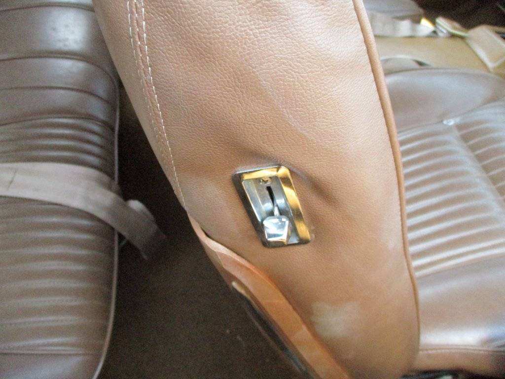

Well, yes, exactly. Getting a good "thingy" is certainly an issue, as is the trial & error and the color match, etc.
That's why I was so ecstatic to find a pair of these chrome versions at Carlisle:
I'm not the CAD guy here, but you could work with this. There's enough to get a length/width/depth and the CL to CL on the screw holes. I could probably get one pretty close with the "Tinkercad" program I use. That's the simplest CAD program out there (the rest have a really steep learning curve.
You would need a more complete version if you wanted to scan it though.

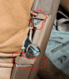

All of the recent comments align with my thoughts.
The 2 circled areas provide 2 cross-sections, and the hole locations, slot dimensions, etc, would be simple caliper-measuring to the nearest .01" or so.
I am starting to wonder if hogging the thing from a block of plastic is perhaps a better option.
Would be a 2-sided operation, but this isn't an aerospace part as far as fixturing.
The surface finish from that would be undesirable, though.
And I'm not sure what type of plastic is available, in sufficient thickness, that also machines well.
And also takes paint.
ABS is my favorite, as it makes nice chips when it cuts. (and I got a bunch of free sheet scraps at a past job)
But I've always left it in its natural black.

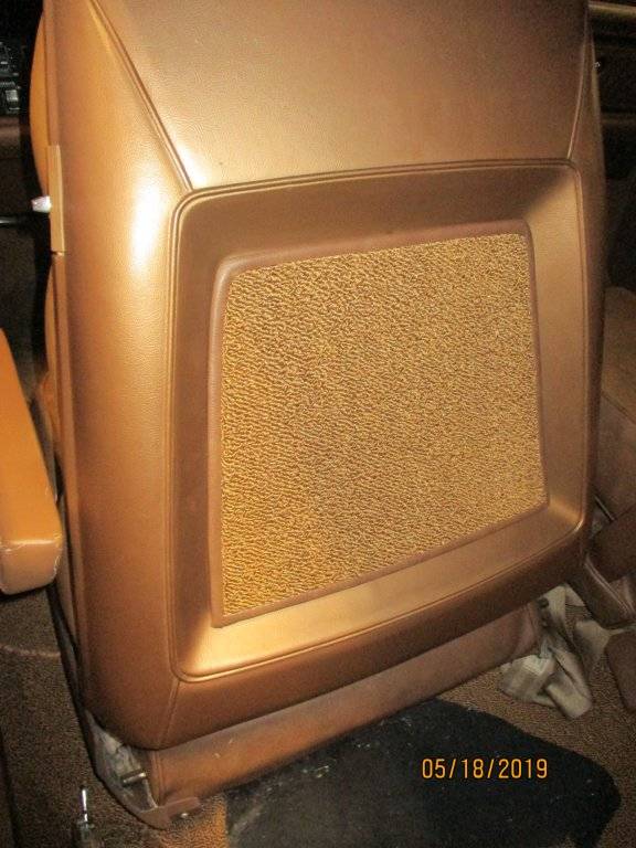

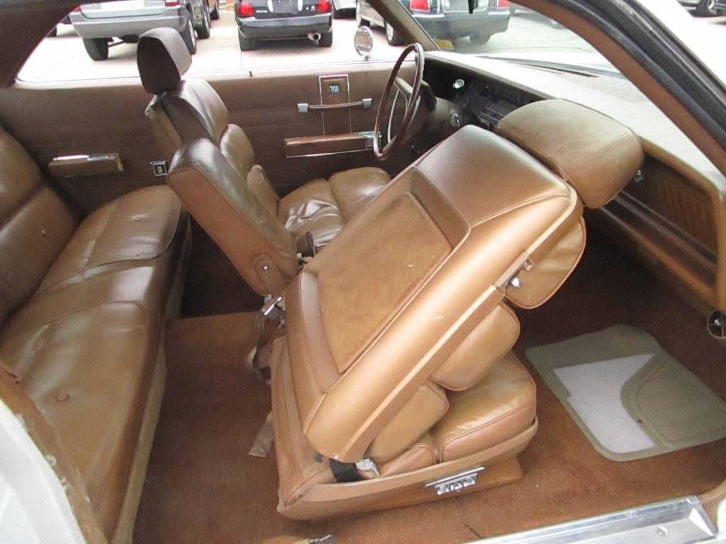

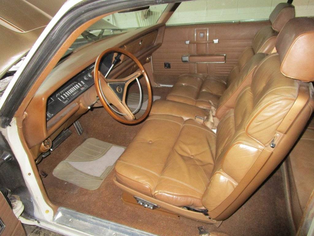

Here is a kicker that I need an answer to. What color are the front bucket seat backs supposed to be painted. Is it the saddle Tan or the hurst gold. Is there an exact paint color code that supports this. I just want to restore this w/ no mistakes. I started to clean them and a lot of color came off w/ the dirt.
The Hurst Gold was on the exterior, period, and it had NOTHING to do with any Chrysler color, period. Legend has it that it's Caddy Sauterne Mist, not even an Olds or Pontiac color. The Hurst interior was pure OEM Imperial Saddle, whatever that color might be. You might want to acquire one of those interior sample cards you see for sale out there to really figure out what Chrysler's color actually was. The "Upper Door Frame" code is FT6, Dark Tan Metallic but I really don't think the plastics are that color.
Here's a pic I took of a survivor....tan. I never took a pic of my own seatbacks.

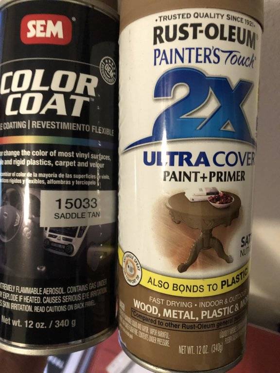

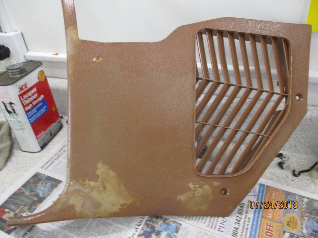

My kicks really peeled when I cleaned them. The Rustoleum Satin Nutmeg was pretty good to restore them (sorry, no pics of finished panels)
The SEM is really good, the simple Rustoleum from Depot is also pretty good. What I've found is that there are several shades of "tan" in the Hurst interior, be it leather or hard plastic or softer plastic like the kick panels. They're all just a wee bit different IMHO.

Thanks Trace, that gives me some good feed back. My concern was the best quality dye or paint that didn't have too heavy a spray pattern and build up on the surface.
