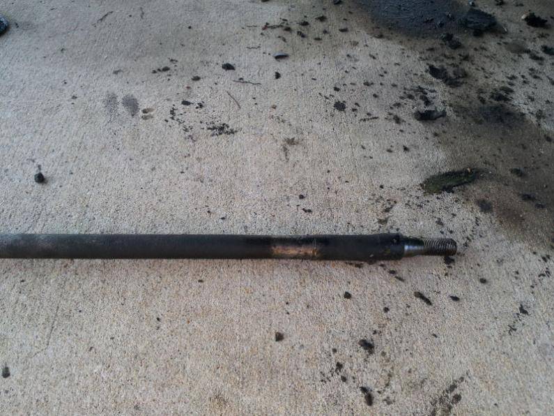

it doesn't look like much in the picture, but where the sway bar link connects is wore out about 1/8 - 1/4 thinner than the rest of the bar.
I knew they were like this when I only changed the sway bar bushings I lived with it. now ive got the whole front suspension exploded, whats another $150 right ? I don't want to go back in here again later if I don't have to. im gonna get a pitman arm also - wasn't planned - but the joint is sponge and I can feel slop in it when I make it pivot at the steering middle arm joint.

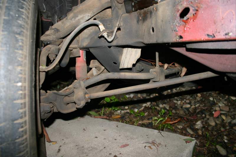

and if you are lucky, like me, you have the non field replaceable bracket that you have to saw through. the square one in the picture ^^.
its welded together at the factory.
if you look in the picture at where the link attaches to the strut rod, you can see that one looks wallowed out and ugly too.

I didn't saw threw mine. I used a flat blade screw driver dug the old one out. Tapped the new one in and drove it on the sway bar with the flat side of a pickle fork.
yup.
