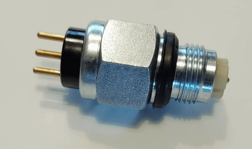

That's for a '68 and earlier. His is a '69 that needs the one with three pins. The two don't interchange. The outer pins are used for the reverse lights.
The rooster combs in the trans are different too.

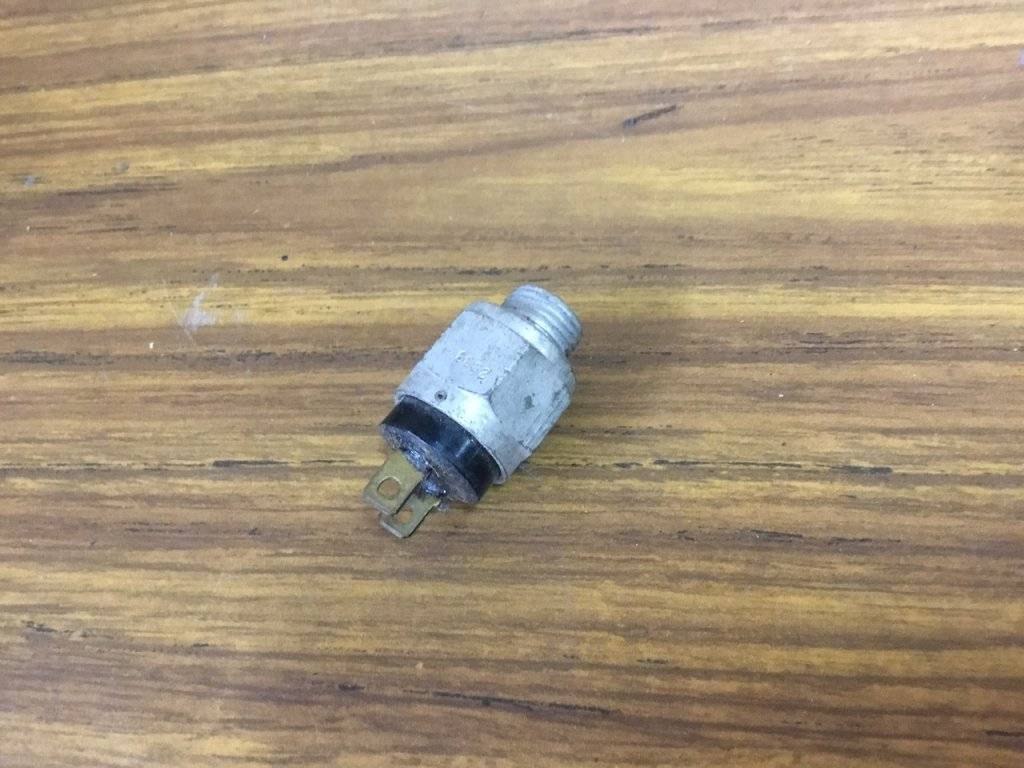

I think I have a few of these.
Turns out the ones I have are 2 terminal. Any guesses as to application?
The switch for the 69 does have three prongs.
