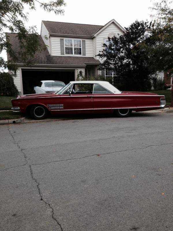

I think they look OK esp with the stainless lower trim .. thought that was your car at first
I thought so too until I saw the wheels.
67Monaco, any chance you have more pics of the red Polara/Monaco behind it?

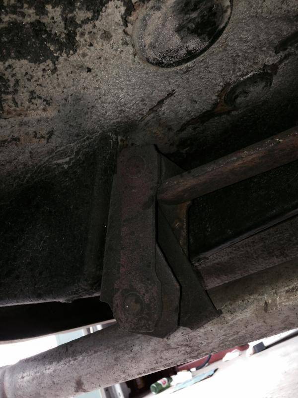

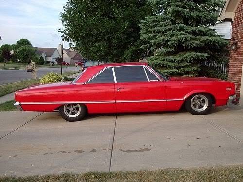

I flipped my shackles and it lowered the car 1 1/2 to 2". Took about a half hour and I'm happy with it.
Nice!!! That is a good looking car!
Thank you. Hope the shackle flip helps.
Flip the mount and the shackle.
I like it. That is all. The stance is right. Just don't know about the 5 spokes.

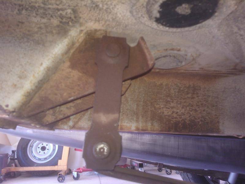

Here's what they look like flipped. 4 bolts on mine....
