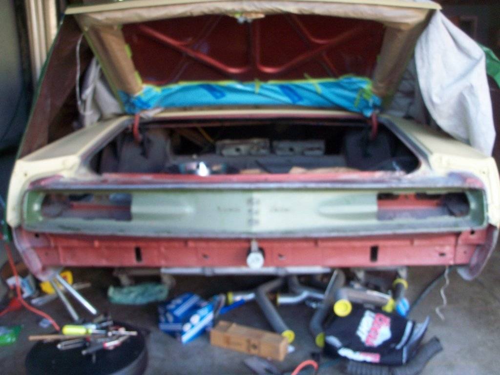

Today is tailpanel day!!
My painter went on a weeks holidays and that is perfect since I myself had fallen behind working on the old girl.
I bought that time to hopefully have the car ready to go to paint when he gets back.
This is a long weekend here on my area so I will be thrashing on the car and keep youse guys updated!!

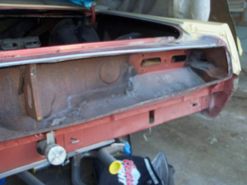

Test fit of replacement panel.
This thing was a ***** to remove without any damage.
Some tweaking required,lol!!

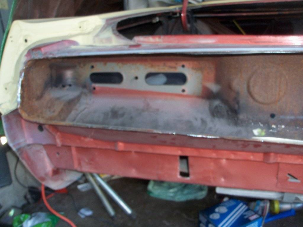

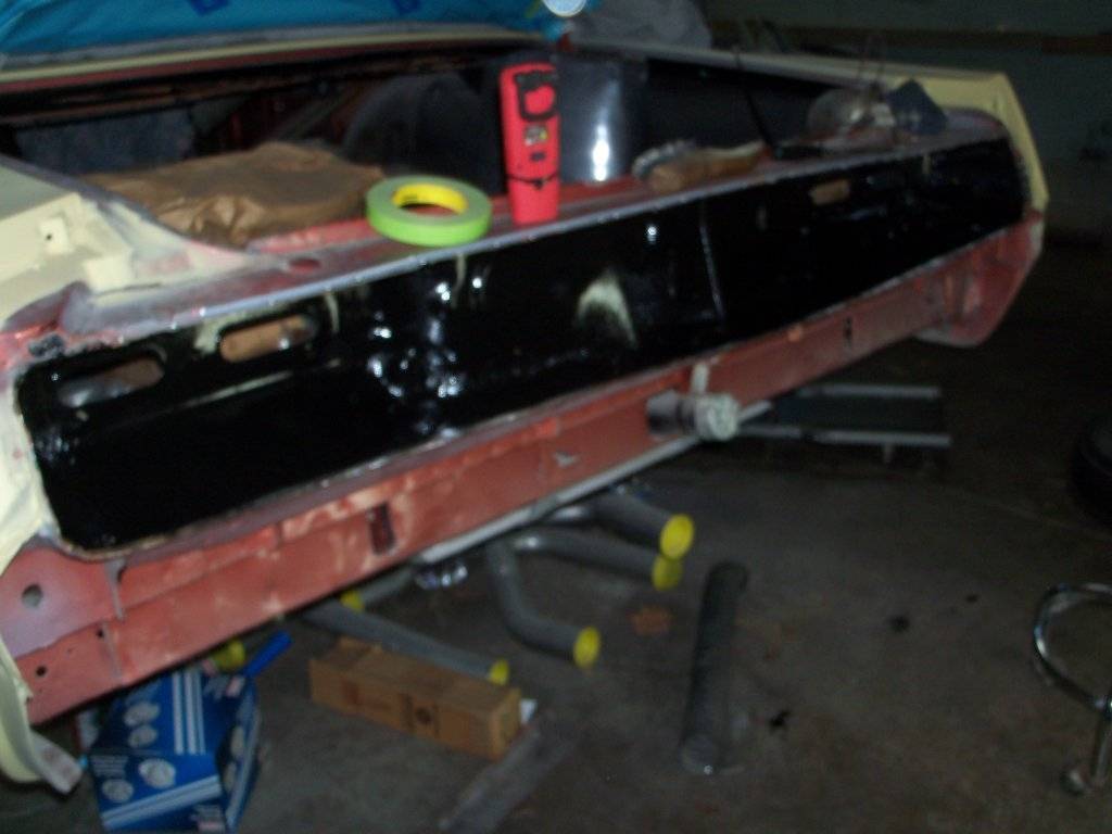

Tonight I have to clean up the areas where the panel needs to be welded onto.
While I am at it I will be treating the hollow guts to stop any further rusting. Obviously,the trunk panel is bare metal except where the tail light openings got over spray.

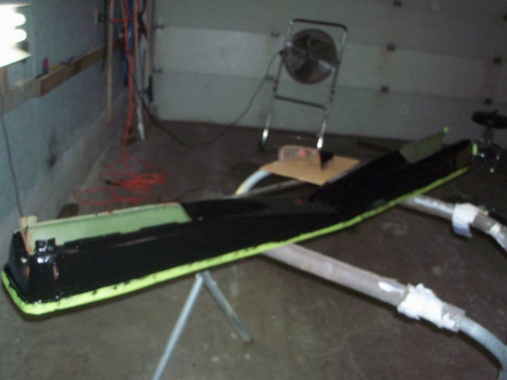

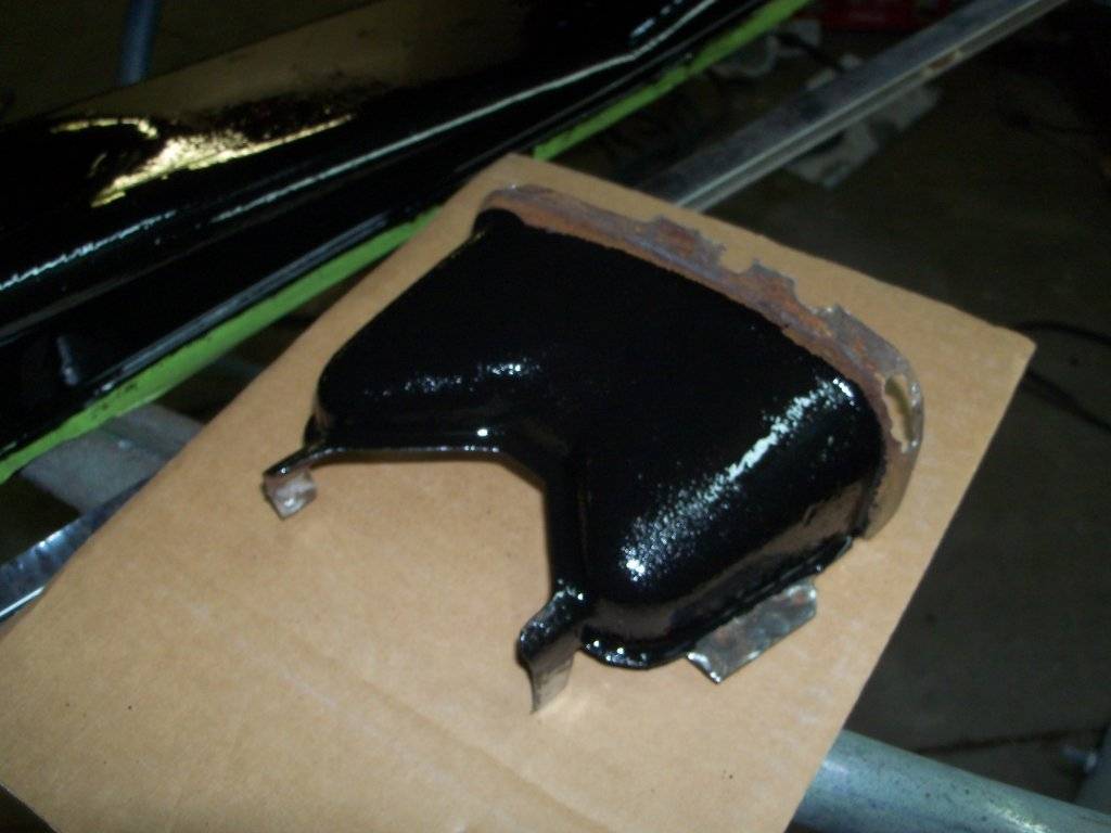

Will be using this to seal the trunk panel and tail panel.
Doing it by brush to cover all the nooks and crannies.

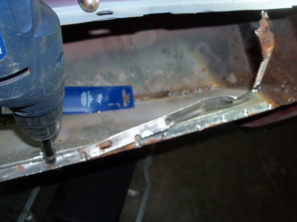

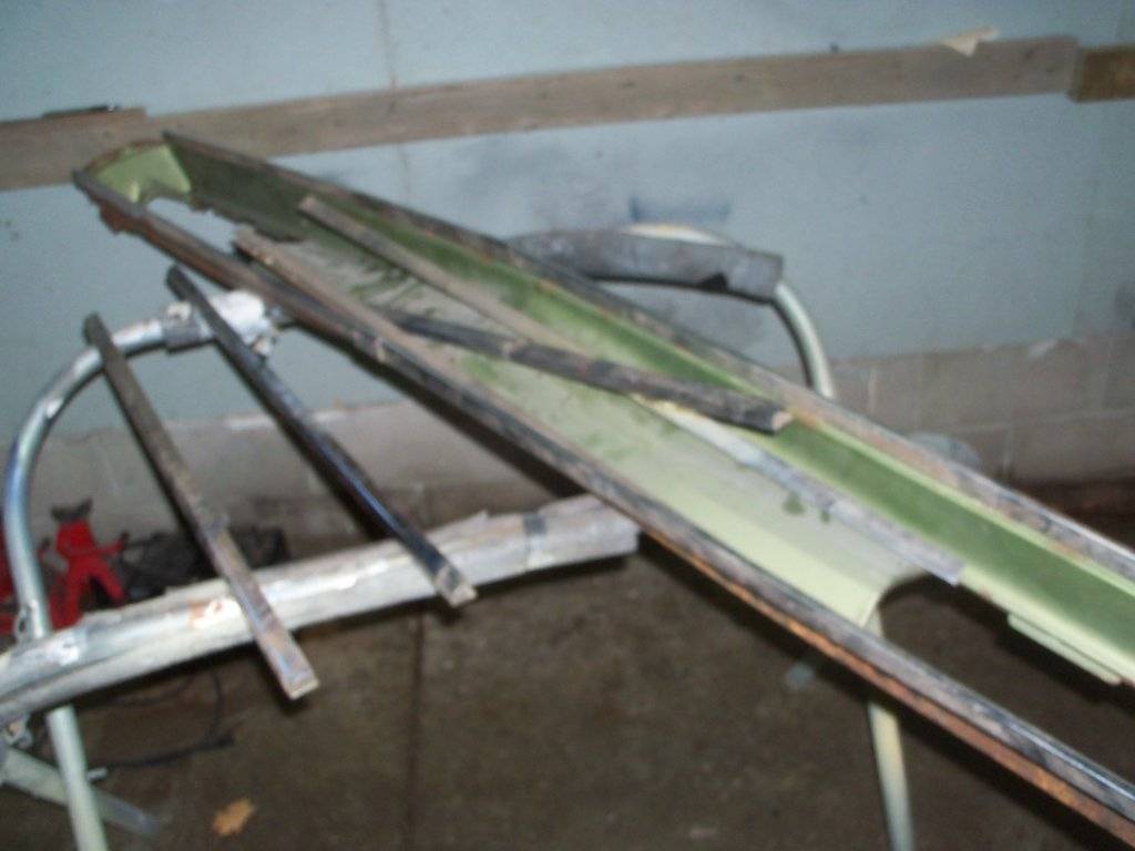

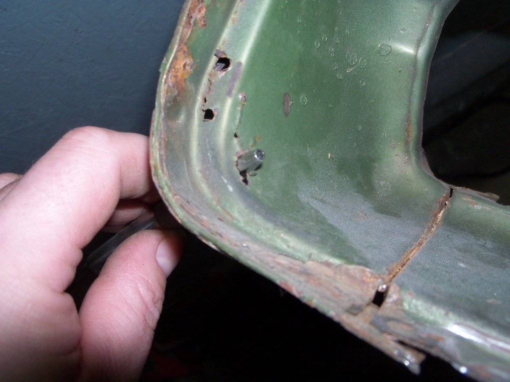

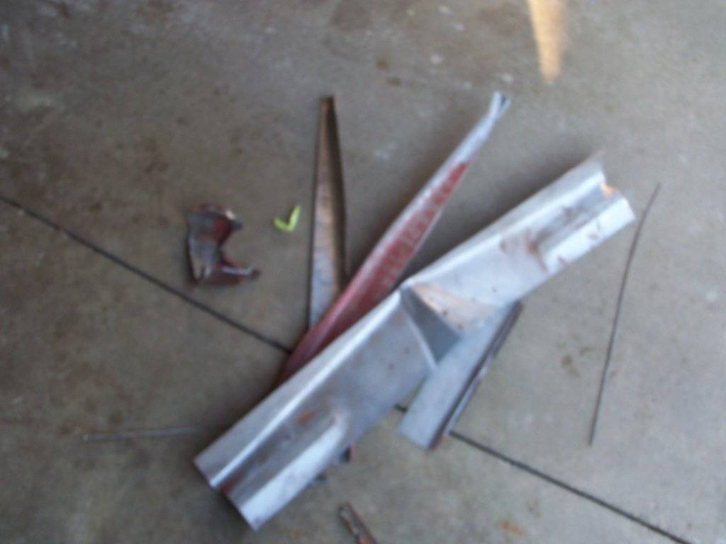

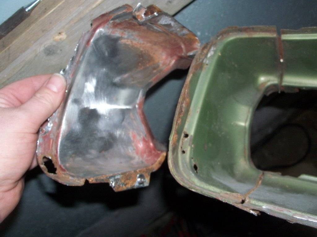

The used panel I got does have a couple holes.
Luckily,it is the left side channel where I saved the original one from my car.
I stripped it down to make sure there were no holes in it.
Will swap this out before installing the tail panel as an assembly.

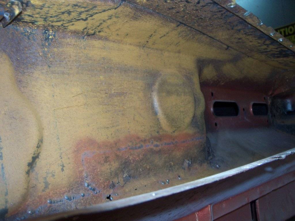

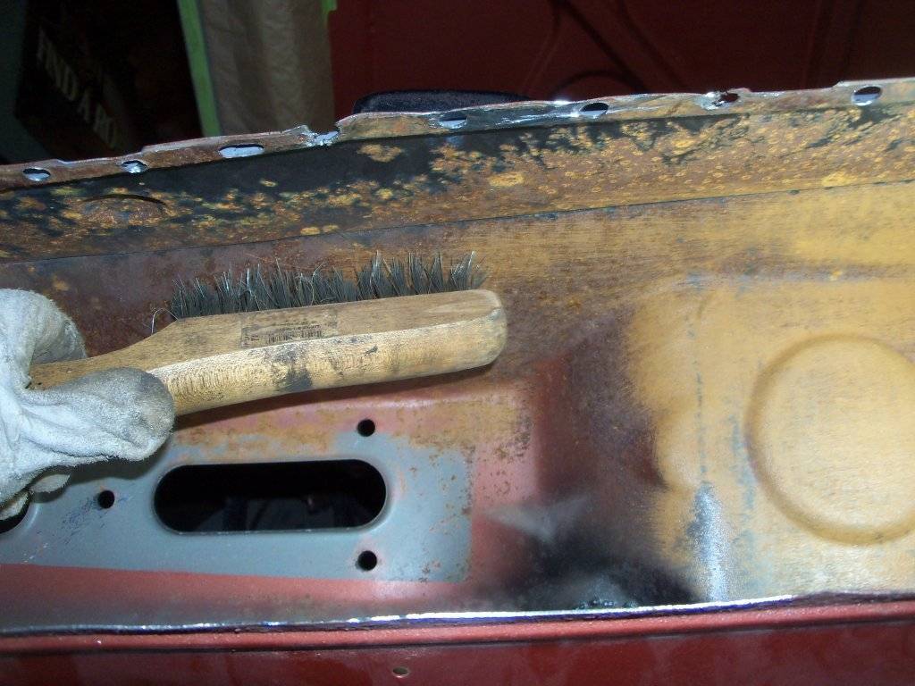

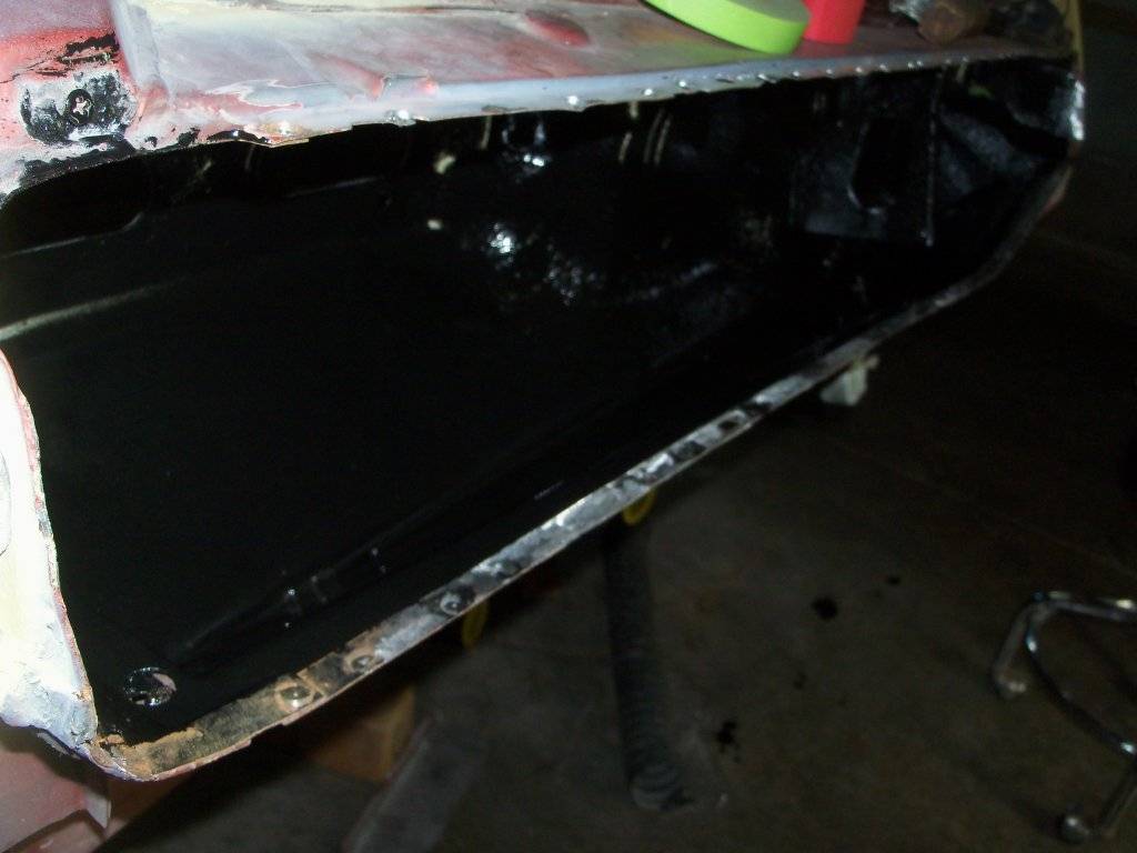

Today,I Prepped and sealed the hollow area's surfaces between the tail panel and trunk.
Something the factory never thought of doing.
Using a wire brush to remove any loose rust then brushed on the stop seal.

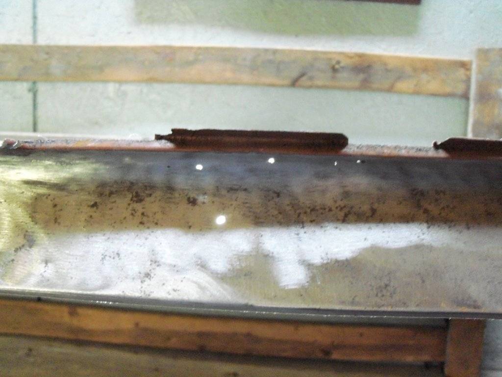

Next was prepping the good tail panel.
Good thing I kept the old trim to use as a guideline to straighten the edges from the removal process.
