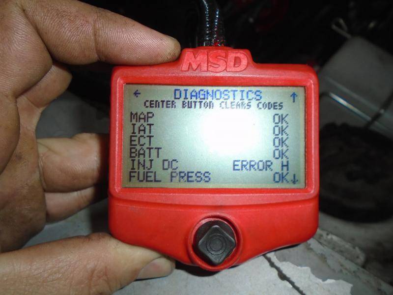

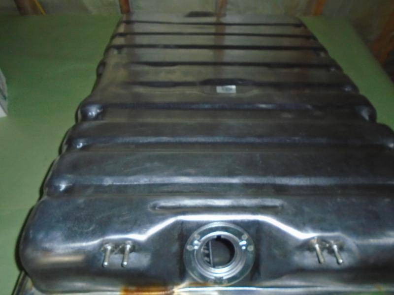

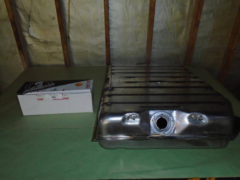

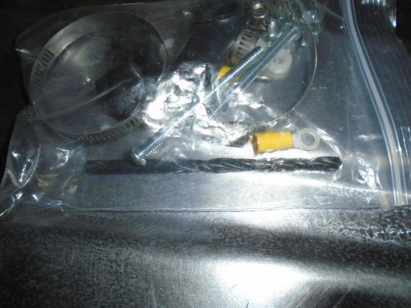

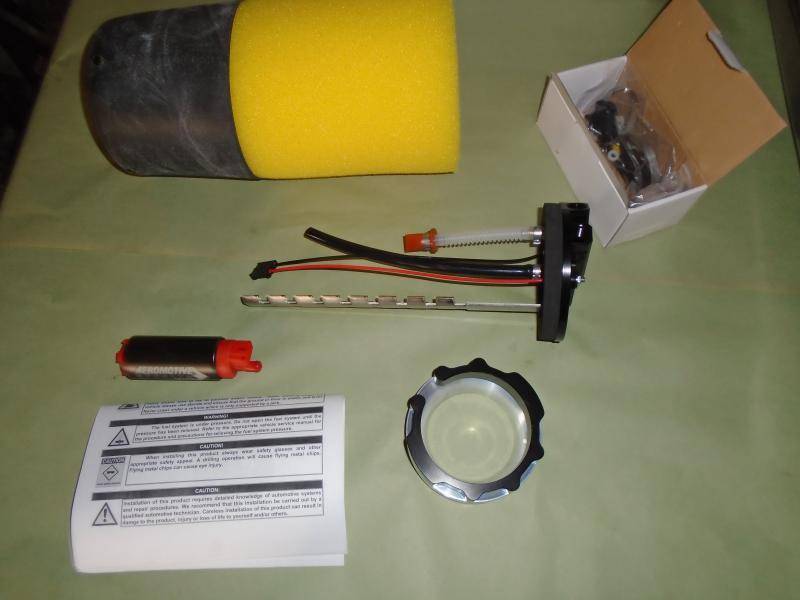

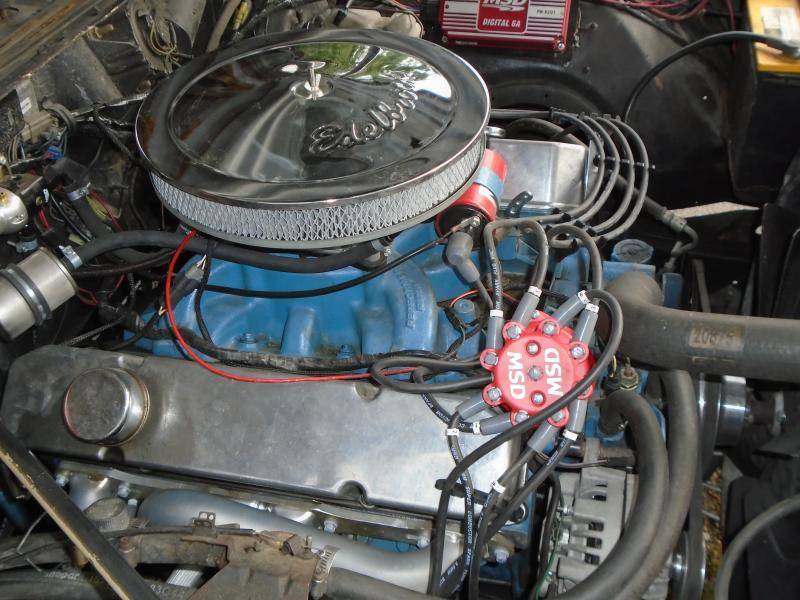

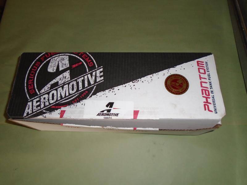

After installing an Atomic EFI system on my Newport I have been dealing with some minor issues. Although the car runs good with the new system I've been dealing with some trouble codes ( DC INJECTOR ERROR ) . So the next logical step would obviously be to throw more money at the problem. The other day I finally decided to upgrade my fuel pump and replace my gas tank. DSC00138.jpgDSC00118.jpgDSC00117.jpgDSC00120.jpg

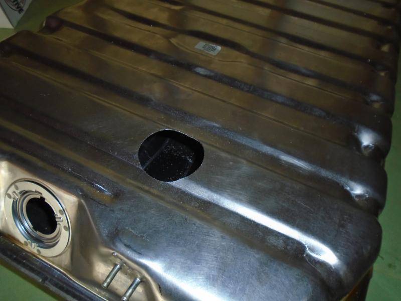

Butchering my brand new gas tank

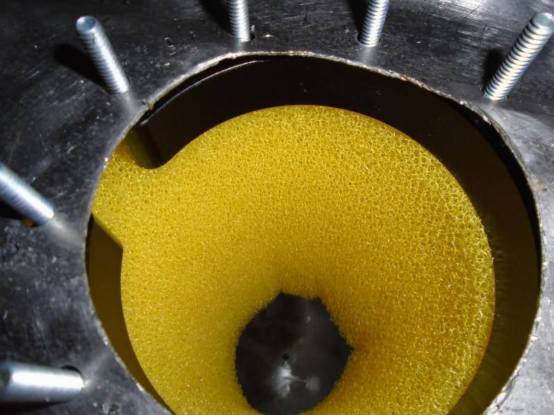

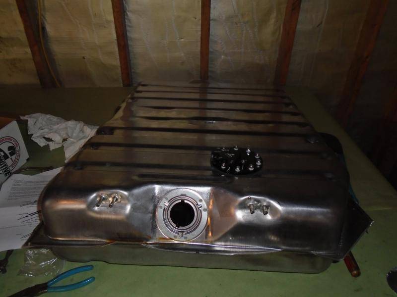

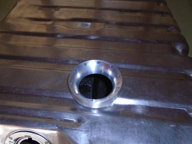

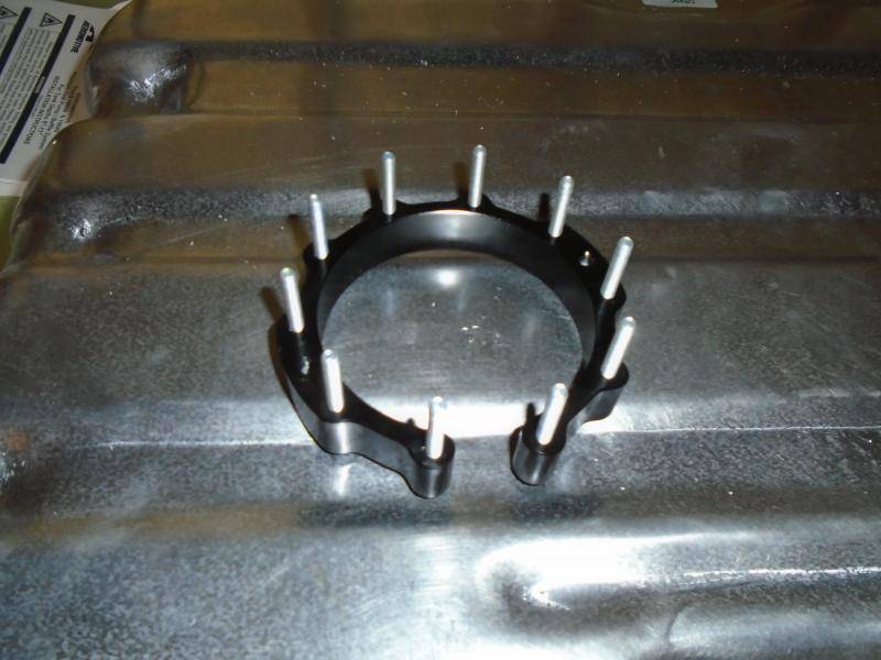

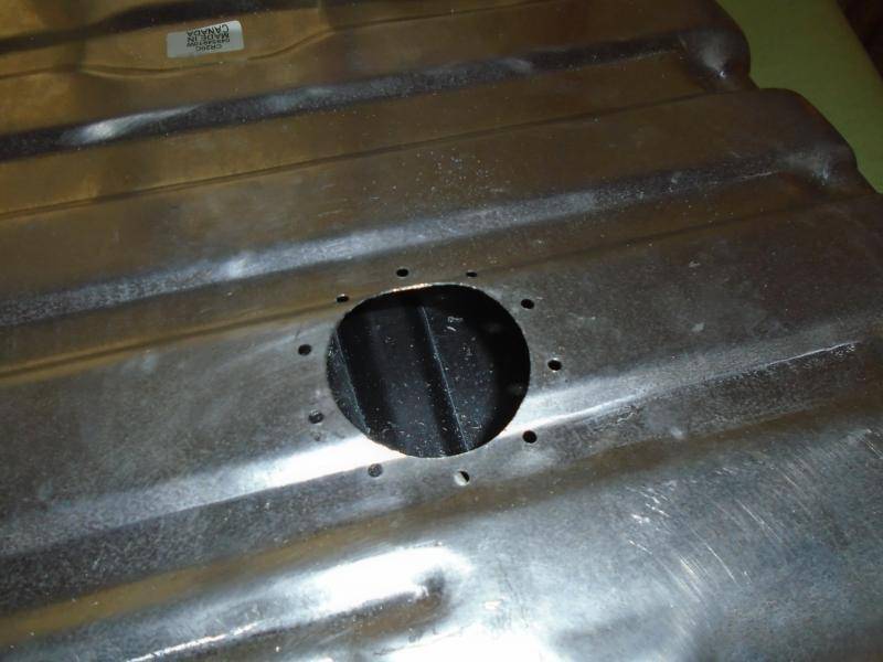

DSC00121.jpgDSC00122.jpgDSC00123.jpgDSC00124.jpg A 3 1/4 hole must be cut in the tank. The kit comes with a template and the correct size drill bit for the mounting hardware.

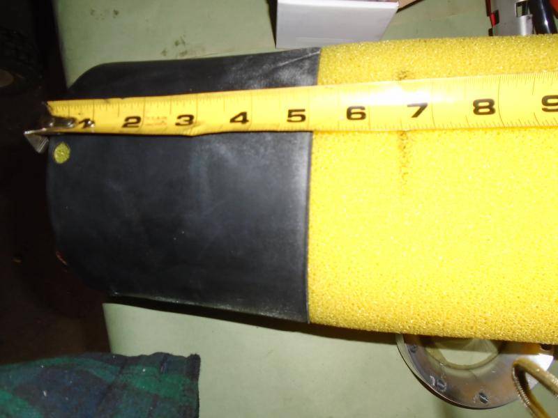

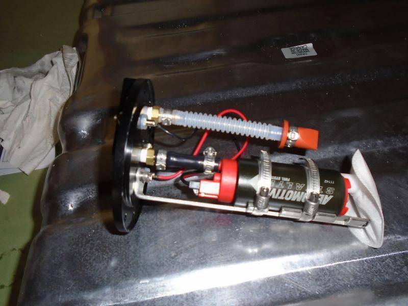

Installing the new pump
The install went fairly easy. I still have to purchase a few fittings and a rollover valve and remove my old gas tank before I can complete the job . That will have to wait until next weeks paycheck.

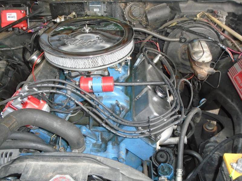

Pics of my car
I decided to throw in a few pics of my car. Please pardon the chessy looking hood scoop and front fascia. That is gonna get changed.
Do you make a hole in the trunk floor for the top of the pump?
