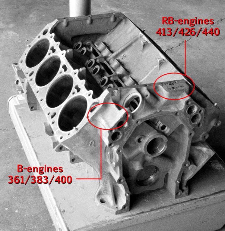

How can i tell a 361 from a 413?

There is a machined pad just opposite the distributor on RB series engines. This pad will be stamped 413 or sometimes just 41 if the engine is a 413. There is a marked photo below that shows engine ID locations. Mechanical parts for this vehicle are generally all still available. Most of the hard to find items are things like body parts and trim items. www.smsautofabrics.com has most of the cloth and vinyl materials in stock.

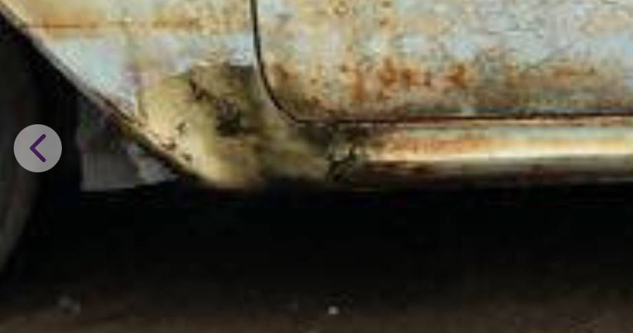

Oh it’s got the rust. I live in Houston, not the dry Texas. It’s been used as a sign outside of a junk yard for years. The guy I spoke to said it ran 2 years ago.
I should also be clear that this is not for Jay Leno’s garage. I have a $3k budget for a Lemons Rally car. I saw this one and it has style! No paint or headliner but that front end!!!
I can turn a wrench and get it running.
Attached is a pic of the driver wheel/door area and the worst rust spot I can see from the photos provided.
If it is a two door and no structural rust it might be worth the effort. I would recommend looking for a solid low rust running car. I rather look for six months and find a nicer car than scrape my knuckles and have a partially disassembled project in the drive way in the same time frame.
From the photo, it will need a rocker and a patch for the lower part of the front fender. Check the bottoms of the doors as they were prone to rusting out.
