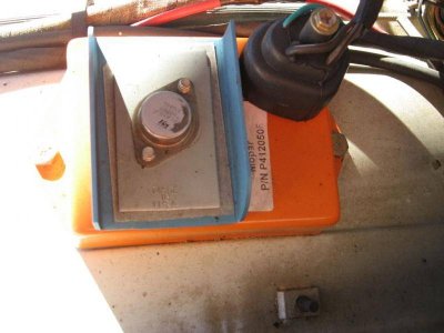

After changing the coil, I noticed that my replacement condenser had the type of clip that wraps around the body. There was no place to mount that, as the old condenser had a little claw-foot attachment. When I went to put the wires back on the coil, I noticed that the fittings are designed for a threaded post with a notch out of it, and the new coil didn't fit. So, back on went the old parts.

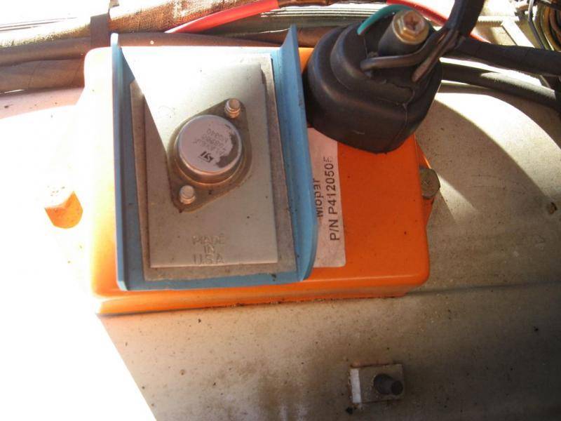

Close inspection showed that the wires and distributor cap were pretty new, so I left those well enough alone. When I went to pull the points... well, I saw that there were no points! Looks like the previous owner converted it to Mopar electronic ignition!

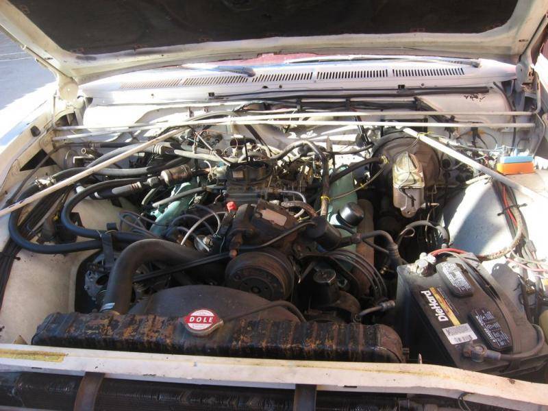

I went to check the idle and timing, and found it was idling at about 850 rpm, and that I wasn't really prepared to do timing, since my marks were really hard to read, and I hadn't brushed up on this stuff (my last tune-up was about 15 years ago). So I messed with it a bit, dropped the idle down a little bit, and crawled under the car.

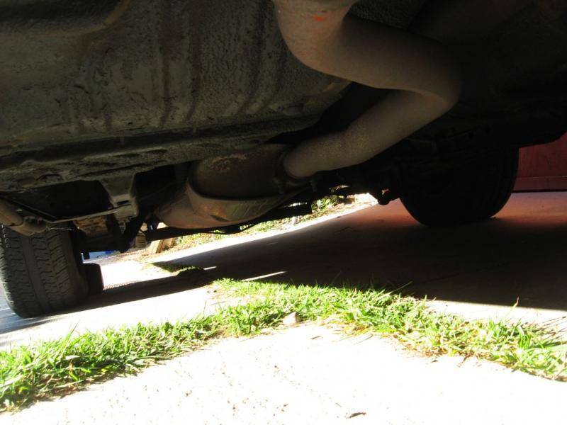

More good news. The car isn't anywhere near as rusty as I had feared. In fact, it looks down-right solid. There is some rot on the fenders and quarters, but the floor pan looks really good. The muffler needs help, though!
A question: Using a tape measure and eyeballing it, the ID of the inlet and outlet on the muffler seemed to be 2-1/8". My first investigations show mufflers in 2" and 2-1/4". Is the muffler measured from the OD of the inlet pipe, or is it a 2" muffler? I want to put on a cheap muffler and spend as little as possible so I don't waste too much money when I pay someone to put on dual exhaust in the future.
I forgot to take pictures with the air cleaner on, but you guys probably know what single-snorkel air cleaners look like .
