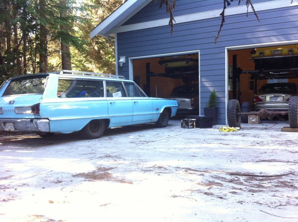

Still unloading old Blue. But here she is with the new stablemates and some of my truck's junk.
Lotta work to do, i want to figure out the charging system first. I've not delt with electrics before so this is going to be a learning experience.
Interesting view in your garage. And good luck with the blue beastie.
Well I thought Blue could use some good company after all these years on her own.
Yeah..... What else are you hiding in there besides the Jag?
1979 Jag XJ is mine. 79 Silver Shadow II, '55 thunderbird and X type is dad's. I do the work on everything.
X type was going anyway to make room for a blown XKR but then the black plague hit. So old blue's going to be safe and warm for the first time in it's life. The lift is going to help in mending it too. As soon as the electrics are sorted i'm going to at least patch the rear end up with some gussets and replacing what i can with my limited fab tools.

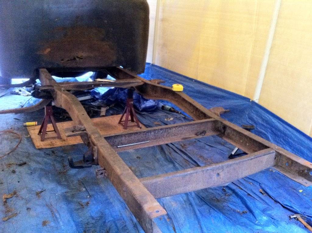

Down the line i will have to replace the whole subframe and the tortion bar crossmember though. Can you get complete subframes or is that going to have to all be fabricated new?

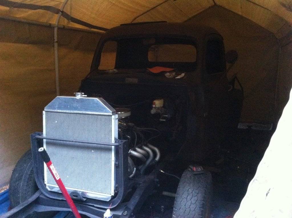

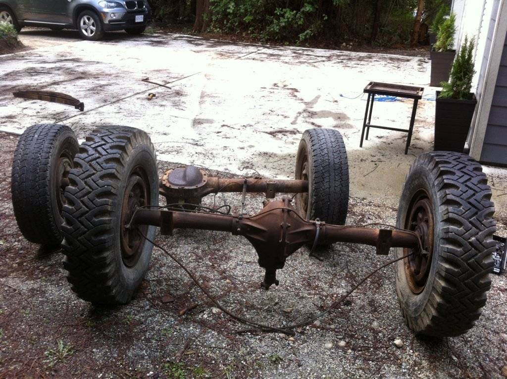

Also not seen is my 49 Ford F3 named Sketchy Bob, which i was in the middle of swapping the rear end on before all this. In that photo you can see the OG Timken two pice, which has an extremely rare 4.11 "highway" gear (compared to the usual 4.83), and the 3.55 LSD 8.8" behind it that's going in the truck.
The timken is a massive differential. It makes the 8.8 ford look like an economy car unit. I can lift the 8.8 by hand, i can't even tilt the timken on my own. Crazy thing.
If the gears were in better shape i'd feel confident in leaving it in there. The truck's going to be a weekend warrior drag/daily thing. I'm sure it'd be strong enough to survive launching on cheater slicks. However there's about a third of a rotation of slop in the pinion, and it's one tire fire only so that won't do. I'll keep it around though, i love old odd overbuilt stuff like that.
View attachment 362558 View attachment 362560 View attachment 362561

That truck needs a Ford 9” in it. (can I see that here?). Find a forum that specializes in that period vehicle.

The 8.8" rear ends are just as strong as 9" actually, and a substantial amount of people claim that they're stronger. The consensus is that a good one can take roughly 750 horse at the crank on an automatic from the junkyard.
The motor i have in there is a junkyard 302 Windsor with the magic 500 horsepower ceiling before it splits in half, so i will not be troubling the 8 inch.
I'm aiming for about 400 at the crank, which is plenty of hustle for a solid axle farm truck with a 70 year old drag link steering box.

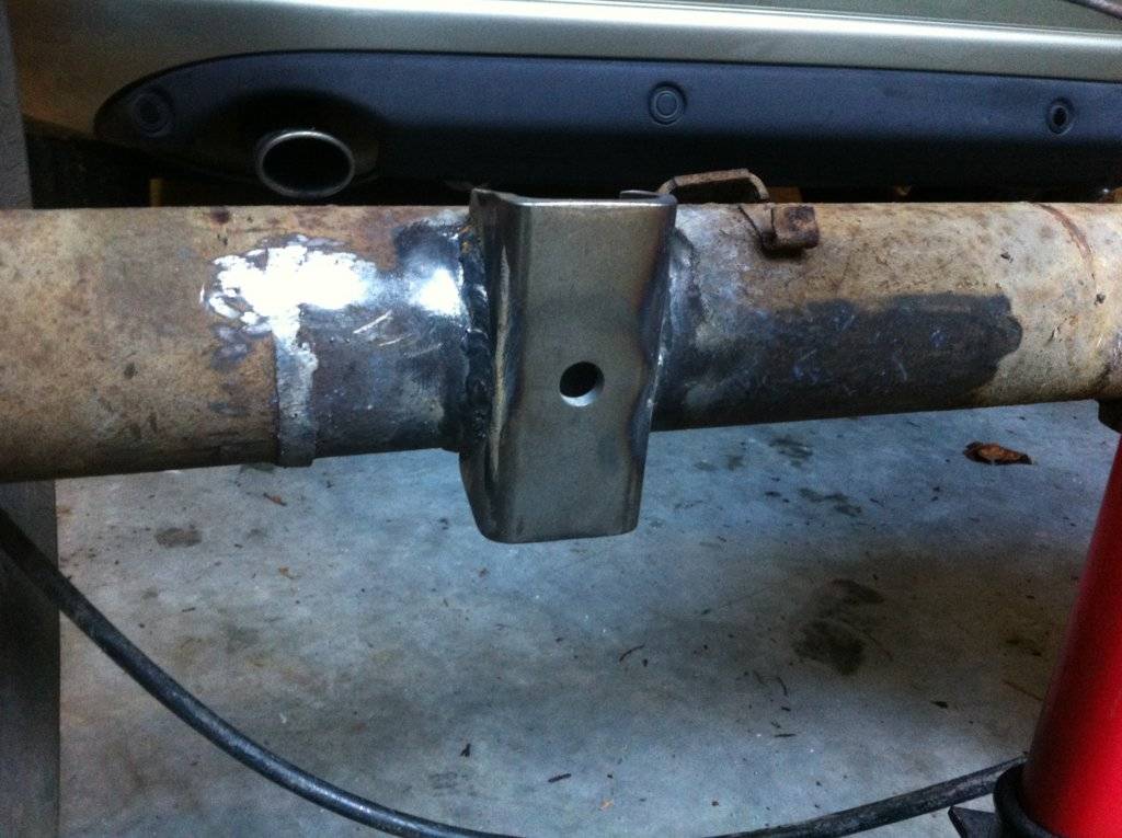

I already put the new spring seats on for the narrower frame, plus it's a pozzie, it's got 3.55's and I got it for free, so there's no reason not to use it.
