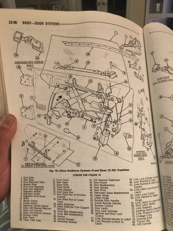

Pretty sure it’s the gear as I can hear the motor running.
Am I to understand (from Moseman’s post) that I have to drill out pop rivits to remove the window motor? If so....That’s just crazy!!

Yes, on a Formal, the door motor and worm gear (window regulator) are pop riveted to the door panel. There is one stud on the motor itself, but the window regulator in which the motor is attached is pop riveted with 1/4 inch rivets to the door frame. Drill out the pop rivets, remove the regulator, and then take the motor off the regulator. Watch out so that you keep the spring still under tension on the regulator. I inserst a bolt or something when I take the motor off so the spring is still under tension. Put the regulator with the motor back in the door and fasten with 1/4 by 1/2 bolts. You have to work behind the regulator to get wo in, but needle nose pliers and patience will ge the job done. I am getting a lot of experience on Formal doors!

You got any pictures you can share??? FSM is a little light on detail.
Best I can tell. The motor looks to be riveted to the sector gear support piece. But I guess it will all become more clear when I dig into it. Can’t imagine that the entire contraption is riveted to the door itself. That makes no sense to me.
