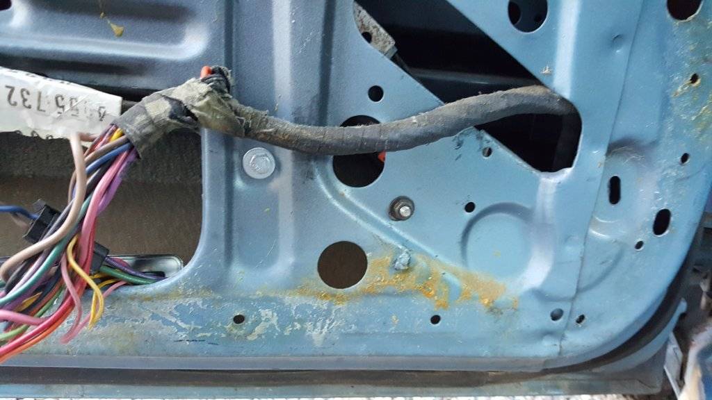

Am I to understand (from Moseman’s post) that I have to drill out pop rivits to remove the window motor? If so....That’s just crazy!!
I have to disagree with mosey on this. I've never had to drill out any pop rivets to remove the motors. Lord knows I've done enough of them. In fact, I don't recall even seeing any in there. But I've been wrong before.

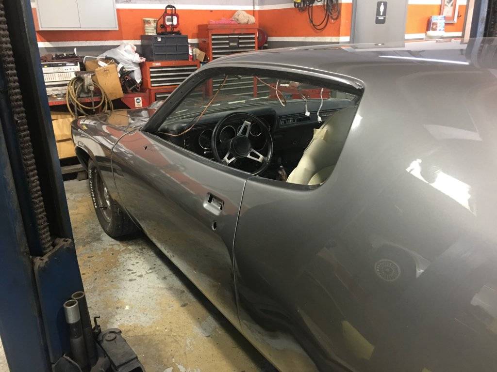

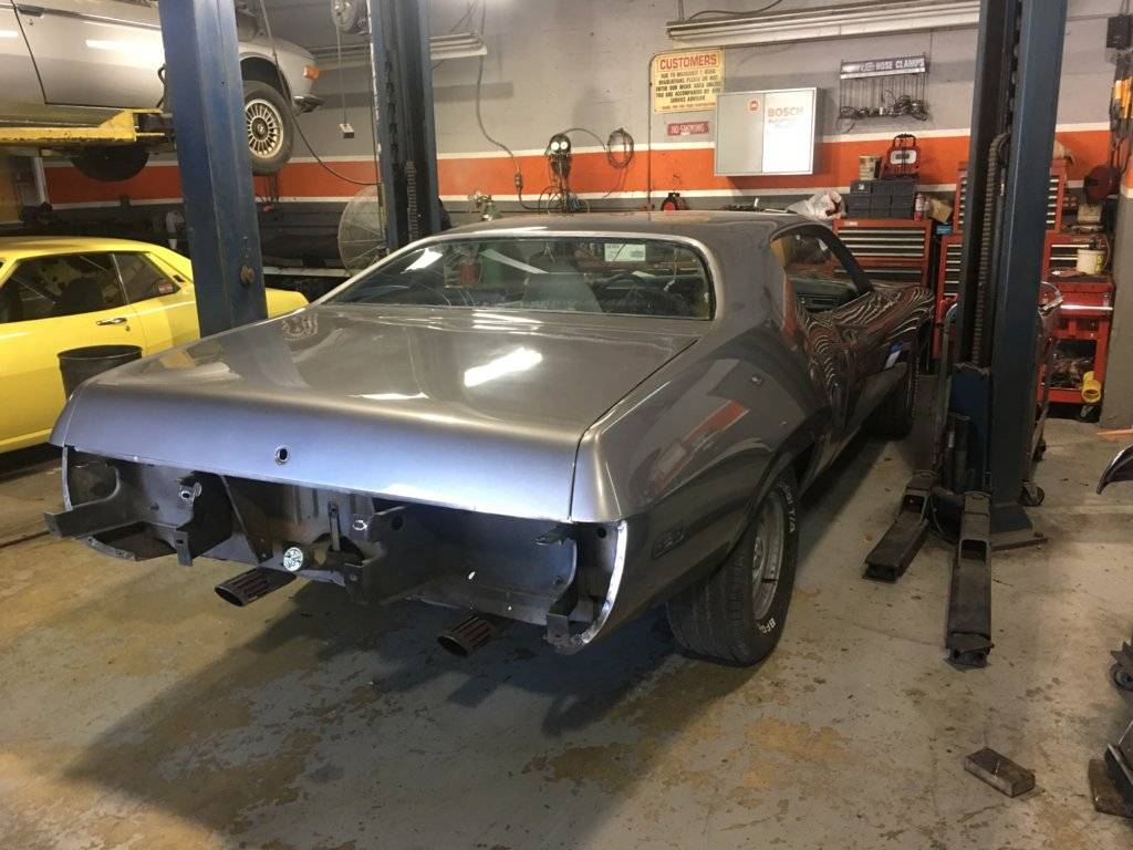

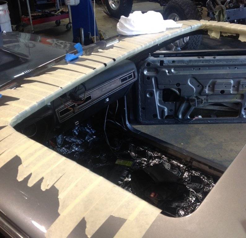

Went by the shop to drop off some parts. Here’s some pictures of the roadrunner in for reassembly.
Rust in the lower corners of the rear window now gone.
Also had some rust in the roof And door bottoms.
All gone.

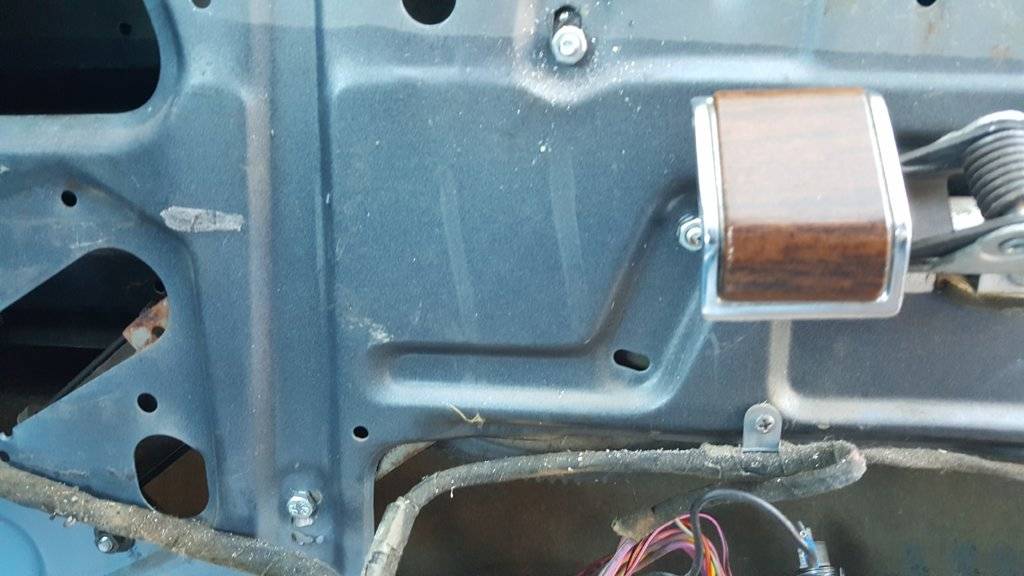

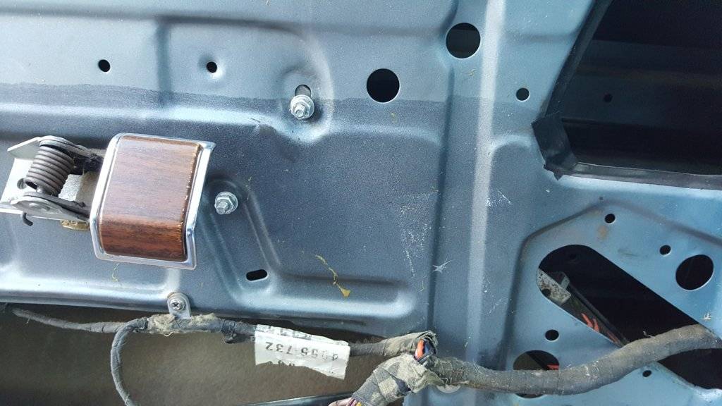

First, get well. Second, I guess I hallucinated when I drilled out the pop rivets holding the regulator on both doors of my 78 coupe. See photos below which show the 1/4 inch bolts that replaced the three pop rivets. The FSM for 78 also mention that you had to do that to remove the regulator.
Sorry.... didn't do that with mine. Never even paid attention to them. Didn't have to.

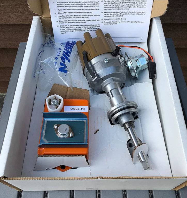

Javier, would this be considered an Upgrade from our OE electronic distributor? Or an aftermarket equal replacement? If an upgrade! Where’d ya get it?
Nope! It is pretty much a stock electronic ignition. The orange module is an upgrade in that it is rated for higher rpm that a stock engine should never see. It is available separately from mopar.

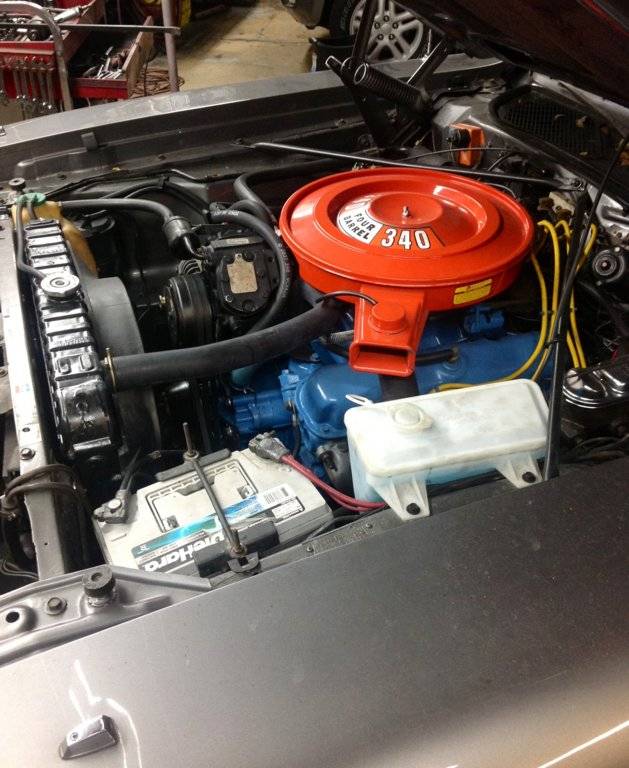

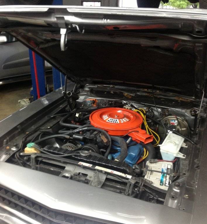

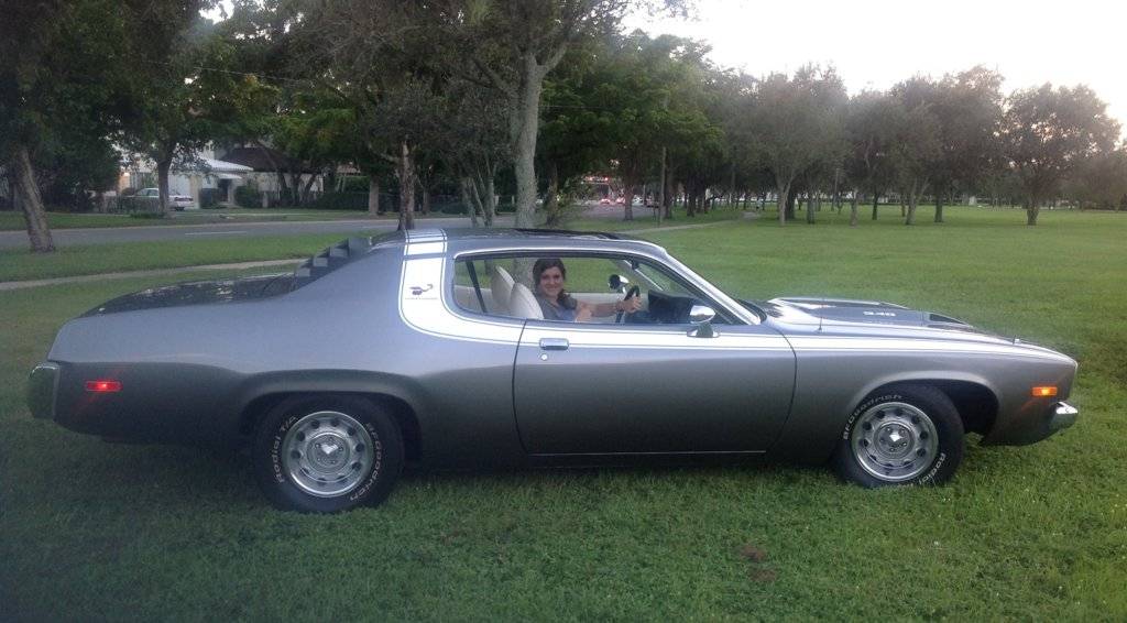

Here it is as it was about 7 years ago and will soon be.
