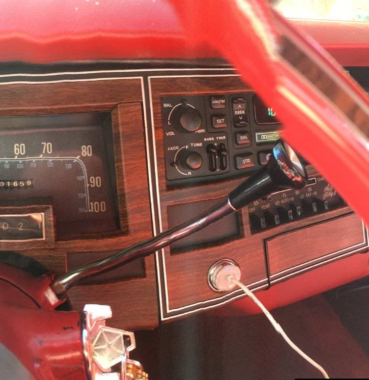

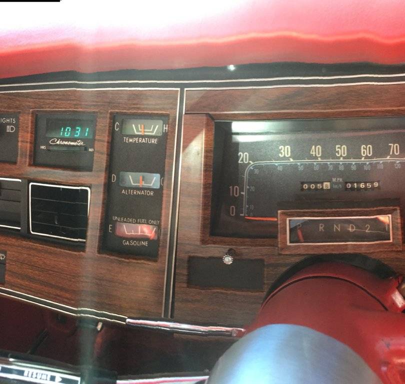

I had bought a later model radio refurbished with Bluetooth to replace the eight track. However, I was never able to get the Bluetooth to work. I received the replacement radio on Friday and managed the switch yesterday. New unit working fine.

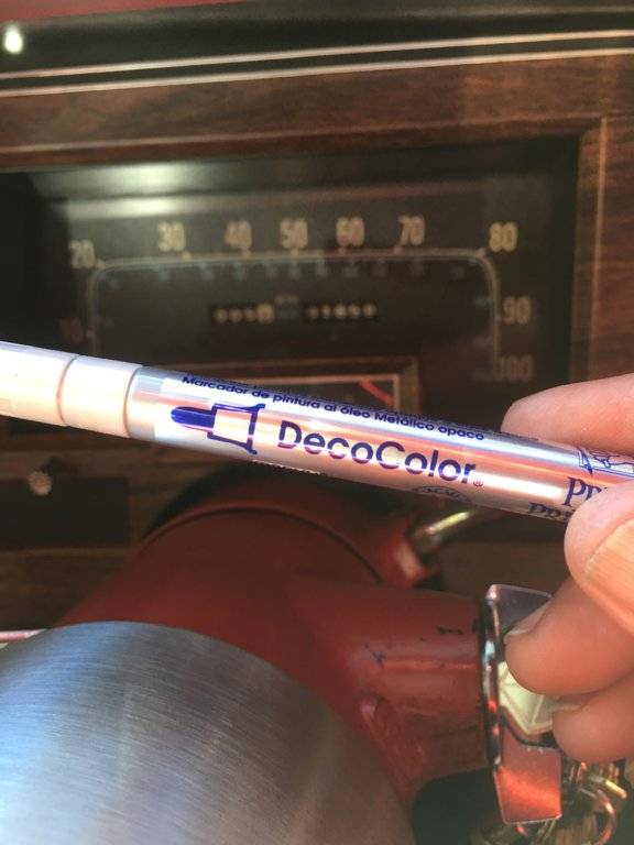

While I was at it, I touched up the silver edging on the dash, refinished the gear indicator needle, cleaned all the vents, cleaned the edge of the dash pad hidden under the metal cover, installed some new foam that seperates the dash idiot lights, reset the breaker for the lighter socket (like who the hell knew it had a breaker!),polished the Speedo lens and put it all back together managing not to have any extra screws.
Here’s the silver gilding pen I used.

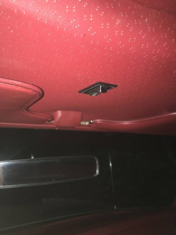

Sunroof cars have no dome lights and the red interior is dark....

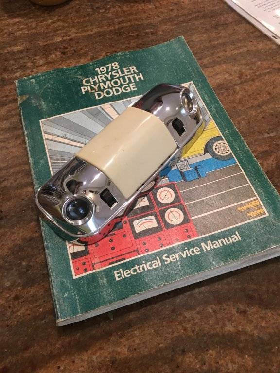

Leftover from one of my old cars...

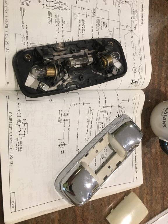

According to the FSM (page c28 of the electrical Service manual), the dome light connector is on the left rear wheel well.
Will need to pull seat to get it I think. If Chrysler had any logic to the wiring it should be just behind seat back.

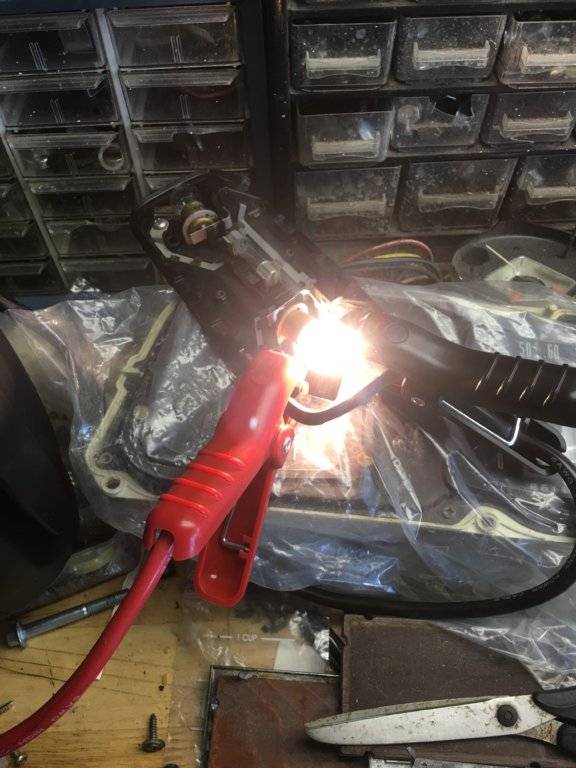

This fixture (ironically...from a LINCOLN) is set up for intermittent power and not ground for the dome portion of the fixture.
This will easily change to work with my wiring by disconnecting the ground on the fixture and using the existing body grounds to mount the fixture to the bottom of the sunroof metal pan for the map/reading light portion of the fixture.
Here’s the goal....

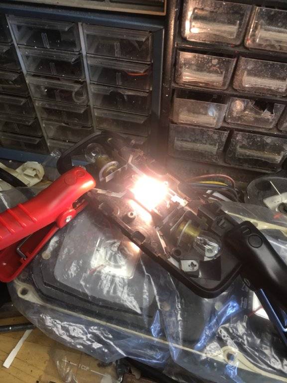

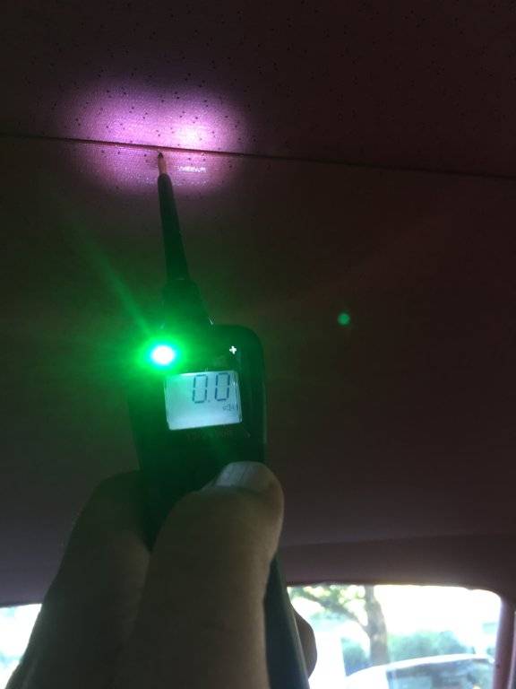

First test the circuits to confirm what I’m seeing in the fixture... this is reading light
This is the dome light portion. Note ground is the same.

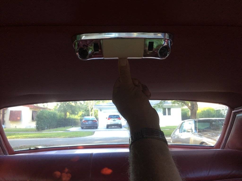

Just to see how it will look.
Next... check that sunroof pan is well grounded..... should be.
It is...
