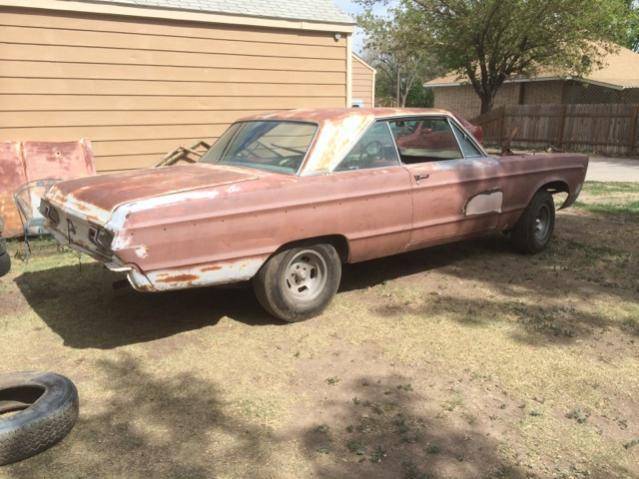

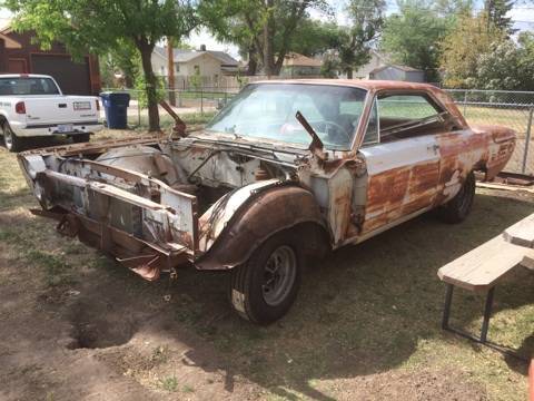

Some pics of the ol girl!

Well looking at the 2 fury's i got they look pretty darn close. Just grille, truck lid and tail lights look differant? I may be wrong?
They share many overall parts, but differ when it comes to trim and details. For example the doors and fenders interchange but the trim does not, this is also true for trim levels, Sport Fury trim is different than Fury III and Fury II and so on, glass is the same but the door panels, seats and upholstery are different. speed and gauge panels are different, the rear quarters are very different, fuel tank is different from 65 to 66, K-frame is different you will need to use the factory 383 due to different motor mounts.
they are based on the same platform and are the same chassis and underpinnings but have plenty of differences

And I'm sure I'll be in the same boat as you 66sportfury. I have most of the trim down the side but the left fender was hit and it bent up pretty bad. And I know I'm missing the commando v8 emblem on that side along with the fury emblem. But I do have 2 bent up little strips. So some of it I'll have to find or just fill in the holes if I can't. I got 2 front and rear bumper but all 4 are bent. I'm missing the Plymouth emblems from the hood and the trim from the drip rail he took off with pliers so it's all bent up. All the trunk molding and Plymouth trim is bent. I have the 2 out side tail lights but the back up lights and inside tail lights are broken. So I know I got a lot of money I'll have to spend just to find decent parts to get it to look half way good. I'm hoping the drip rail trim will work from the 66. The side trim on the 66 I know will not work. My grille is bent but is there. Part of the hood emblem was in the glove box. Lol.
The body will be the easy part. I got no problem fixing rust I've done rust a lot of times. The engine is in the father in laws basement bored and ready to go back together. But the heads were in the trunk all covered with rust and stuck valves. Only good thing about the engine is that he has 2 other complete 383's. One is out of some wagon the other is out of a GTX. And we can find the tranny.
So I've got a long road of hide and seek parts to find.
