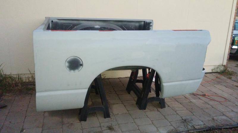

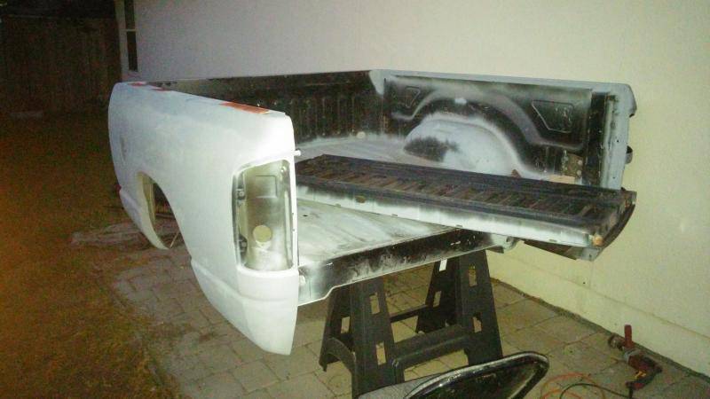

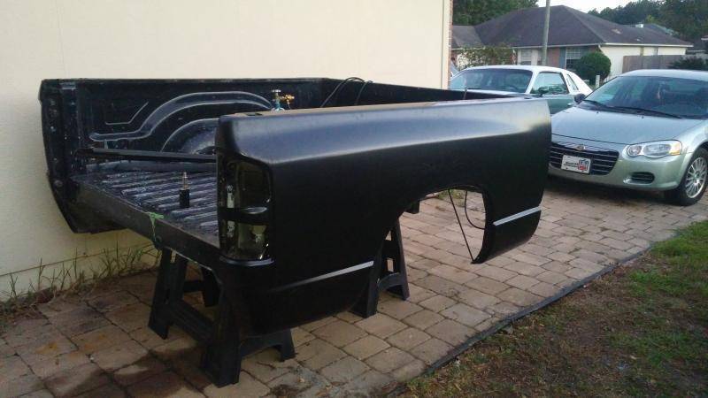

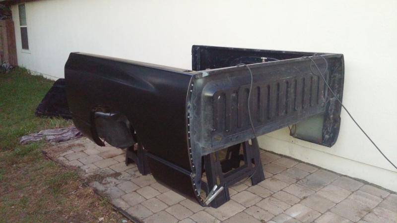

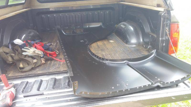

Got some time to work on the bed this week. Drilled out all the holes to weld the bedside on. Was a pain getting the bedside onto the bed! Had to stretch it around the corners as it has a lip. Was afraid of bending the new metal! Once it was on, got it welded up. Spent today and yesterday grinding the welds down. Once they were done, put on a light coat of spot putty to fill the little holes left from the weld.

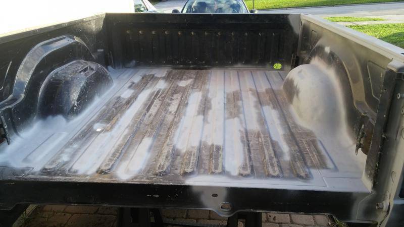

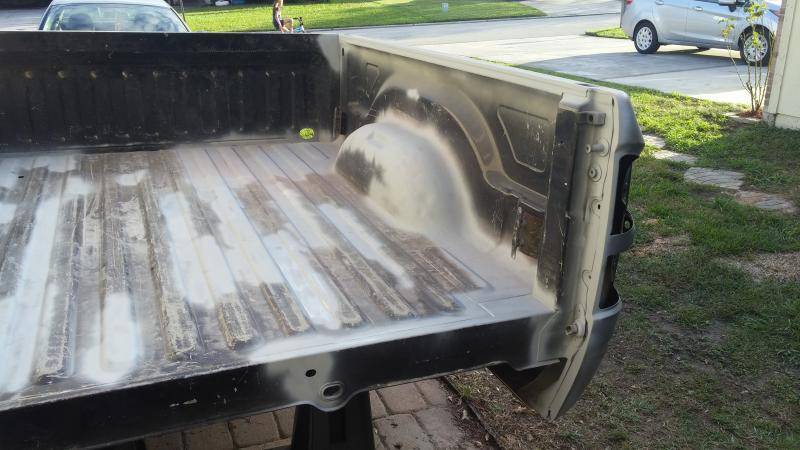

I don't know what was spilled in the bed by the prior owner. But there was some nasty **** in there! Was kind of a silicone/cement mix. Only thing i could use to get it off was the grinder. Luckily there is a thick coat of primer to keep the grinder off the metal. Got most of it off and primered.
I'm hoping to get it finished up, and to the paint shop next weekend. Gonna be a Macoo job... Obviously nothing fancy lol. As long as the truck is all one color I'll be happy. I'm doing 90% of the work. All they will have to do is a final sand, and paint.

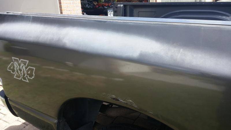

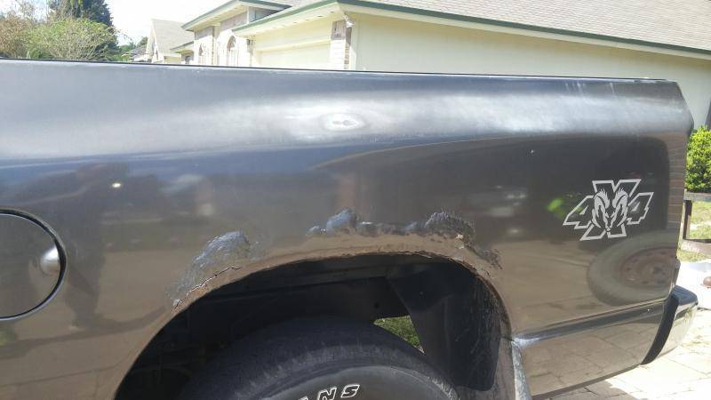

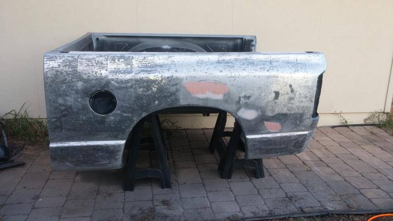

20151013_184952.jpg20151015_191133.jpg20151015_191940.jpgGot the paint stripped down on the driver side. This bed was repainted once before. Kinda **** my pants for a second as I found bondo as soon as I dug in. Luckily it was just a skim coat. Only needed a little bit for a couple little dings (as seen in pics).

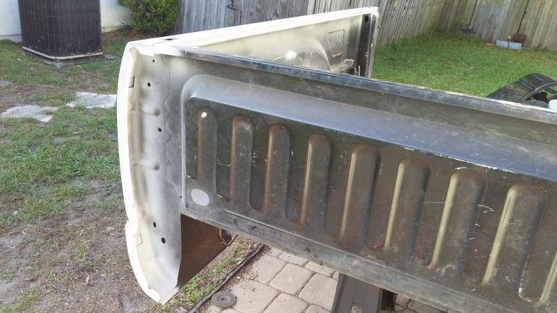

Pulled the tailgate off the truck, and treated a little bit of rot on the bottom edge. Have a little spot putty to sand dow , and a tiny weld to grind down, and she should be good for the paint shop. Come on saturday!!

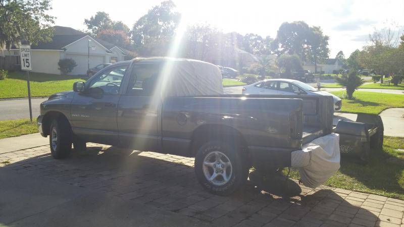

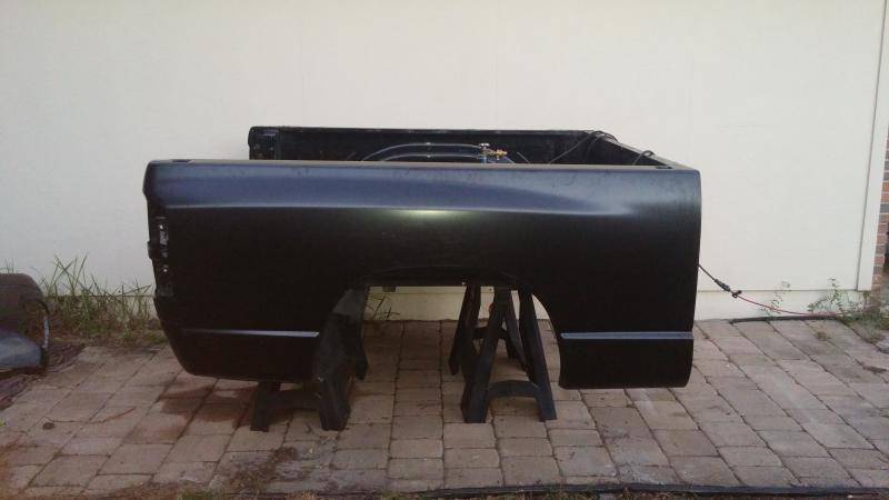

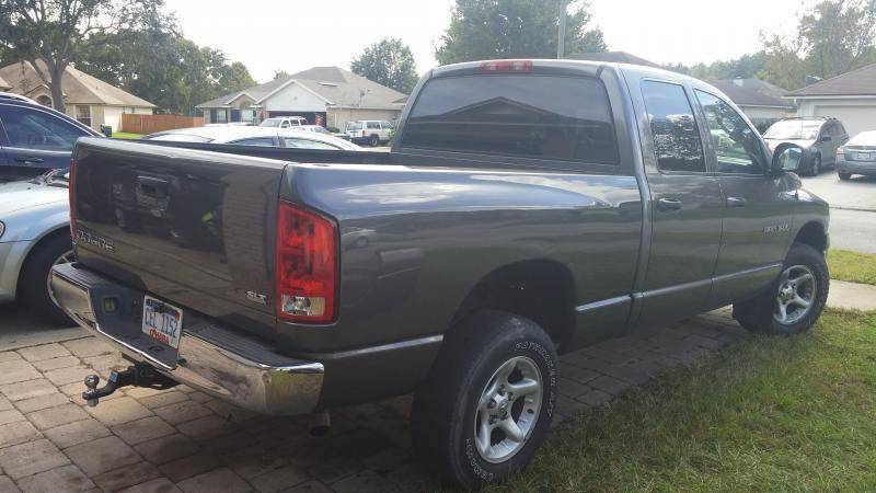

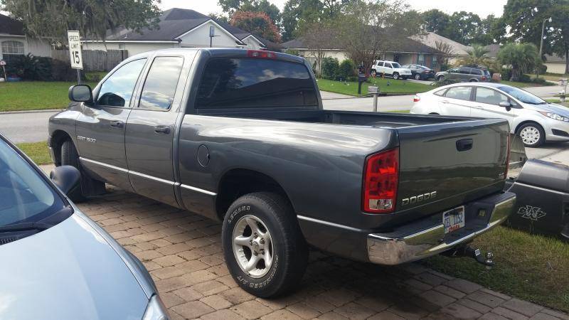

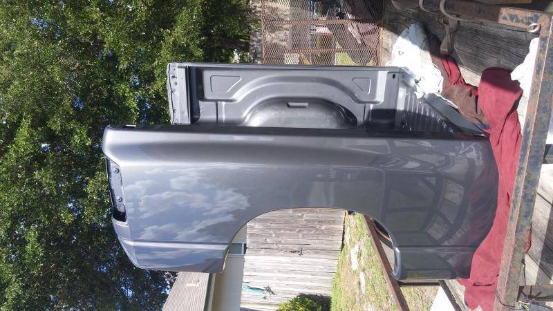

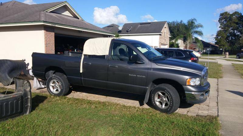

Picked the bed up from Maaco yesterday. They actually did a pretty damn good job! The bed looks great! Matches the truck pretty good too. Can deff tell its newer paint, but still looks good.

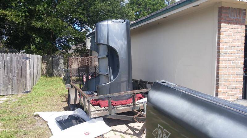

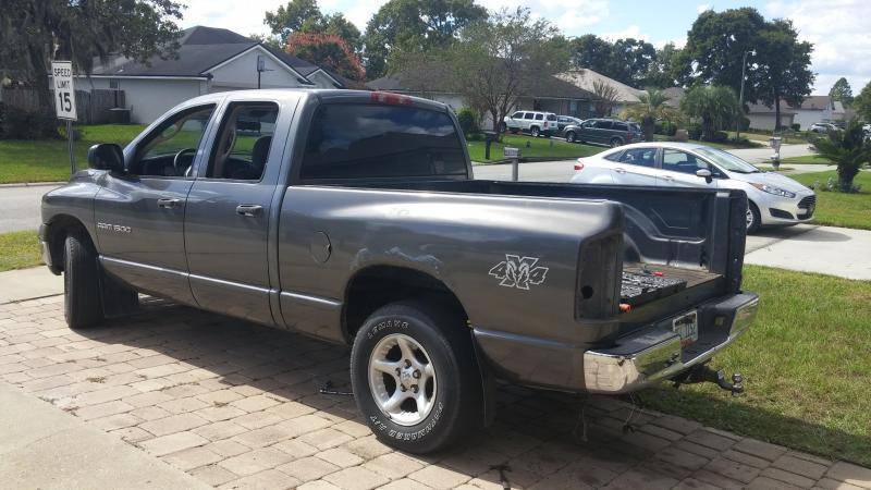

Got the old one off, and new one on yesterday. Spent today doing some final touches. Don't think I did too bad. Spent $2300 and basically have a brand new truck. If you count the engine rebuild a few years back looking around $4900..

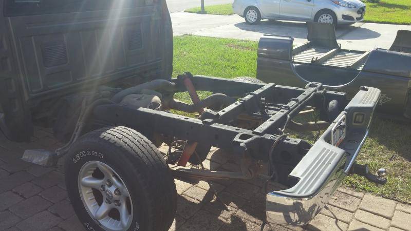

A few pics of the work, including some of the bad from the old bed. Need to get some new decals for the bedsides.

Thanks for the update. Nice work. Why is it that every older truck has rot in the same area around the rear wheels. You'd think the manufacturers would have figured out how to prevent corrosion in that area. Must be built in obsolescence.
I really think dodge should have stepped up, and recalled all these generation trucks a few years ago for rust problems. All of them have it, and they get bad. A page or 2 back you can see why they rust there with the spray foam glue/sound deadener that is applied in between the wheel well, and bedside. Whats worse is there is no real reason for anything to be there. Theres a wall behind the wheel well that wont let any water, or dirt into the bed. Its just open space.

25 years working in a Dodge dealership I've seen these rust problems on every generation truck since 1989. We have been told by Mother Mopar that it is related to splashguard installations not sealing the self tapping screws but that doesn't explain rust on the top of the wheelwell. Just warranteed a repaint on a 2011 same issue. BTW nice to meet another Cordoba driving C body building Ram driver!

Yea it is bad how they all rust there. My 2nd gen ram did the exact same thing in the same places. Although I think these third gens progress alot quicker/worse. Pretty bad when you have to do warranty work like this on a 2011!! My 98 was bad but not near as bad as this one was.

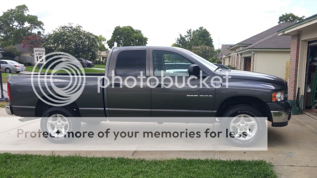

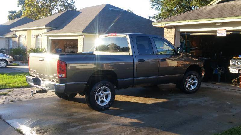

Gave the truck its first bath since putting the bed on. Looks much better then before. Still need to wait a week or 2 before any wax.

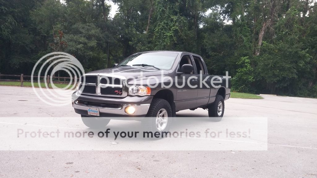

I bought a small lift kit, with new torsion keys, and blocks for out back.

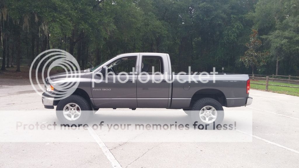

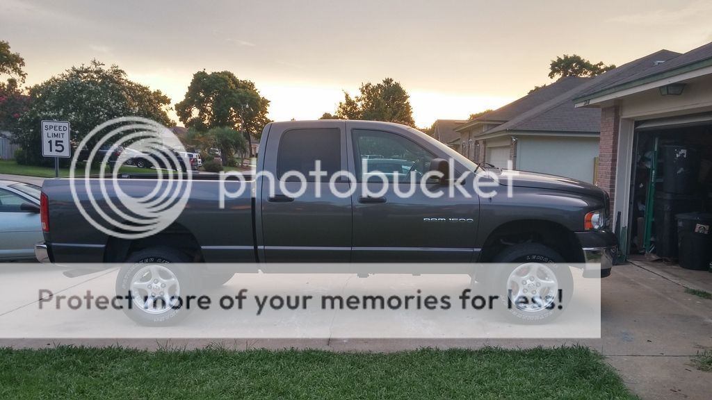

Before-
After-
The front went up a little higher after this pic. Been letting the suspension settle, and readjusting through the week.

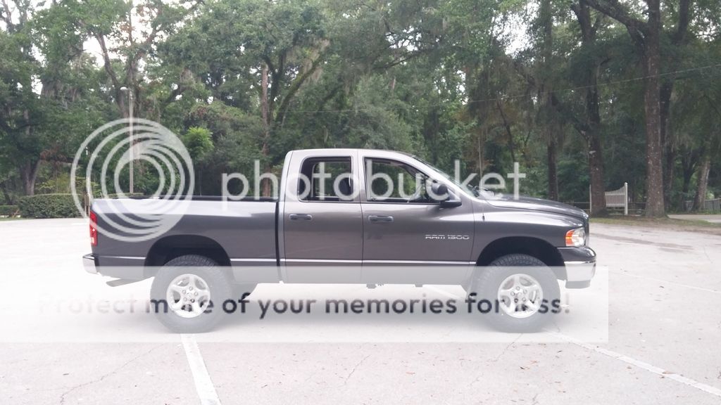

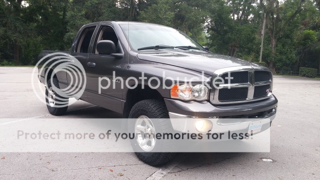

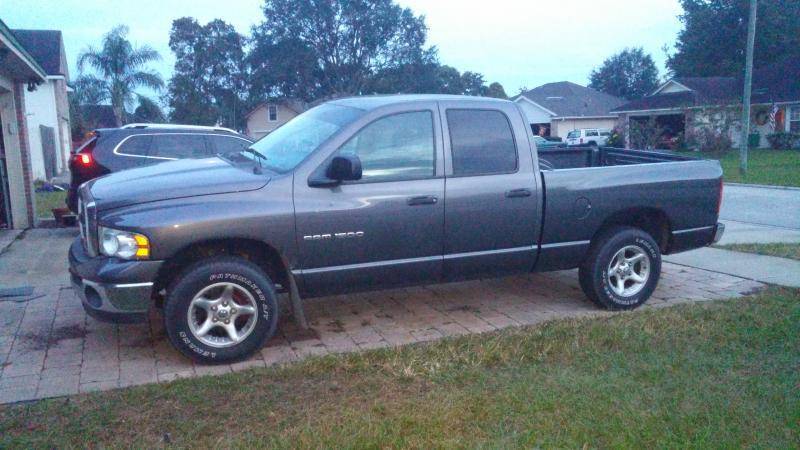

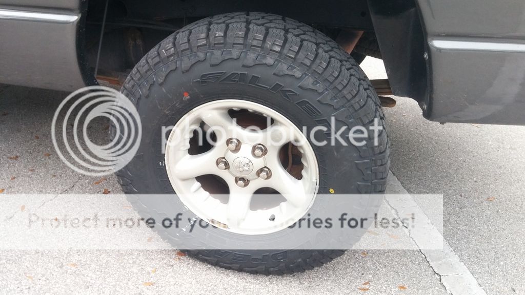

Took her to the tire shop today. Got some new shoes, and an alignment done. Much better! Not near as grandpa-es as before lol. Hard to tell from the pics, but shes sitting much higher. The ol' lady just about fell the other day trying to get in!
She got a set of 285 75r17's. Original was 265 70r17's. Think it was the perfect step up to compliment the lift. Wish I could have gotten em for the same price as tires for our cars!
