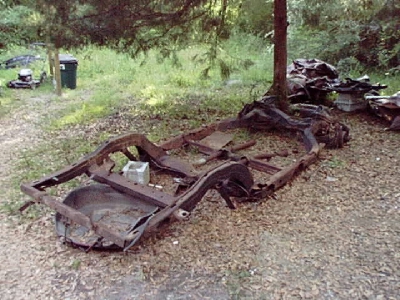

If you have a restored 69 Roadrunner from Cape Cod that went to California via Florida, it will arrive like this...
But it's a dry rust, not so bad just like the dry heat. ;)
