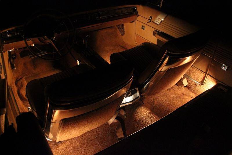

Now I have interior lights:eek:s_dancing2:
I love this pic .. please keep posting please! I don't think we can ever get enough of this beauty :)
Hope you resolve the remaining light gremlins soon and are out enjoying this convert to the maximum extent possible the rest of the season
