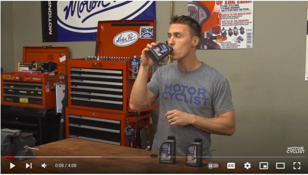

And look what popped up in YouTube this morning.
I really want to start using this as a response to "bad ballast resistor".
