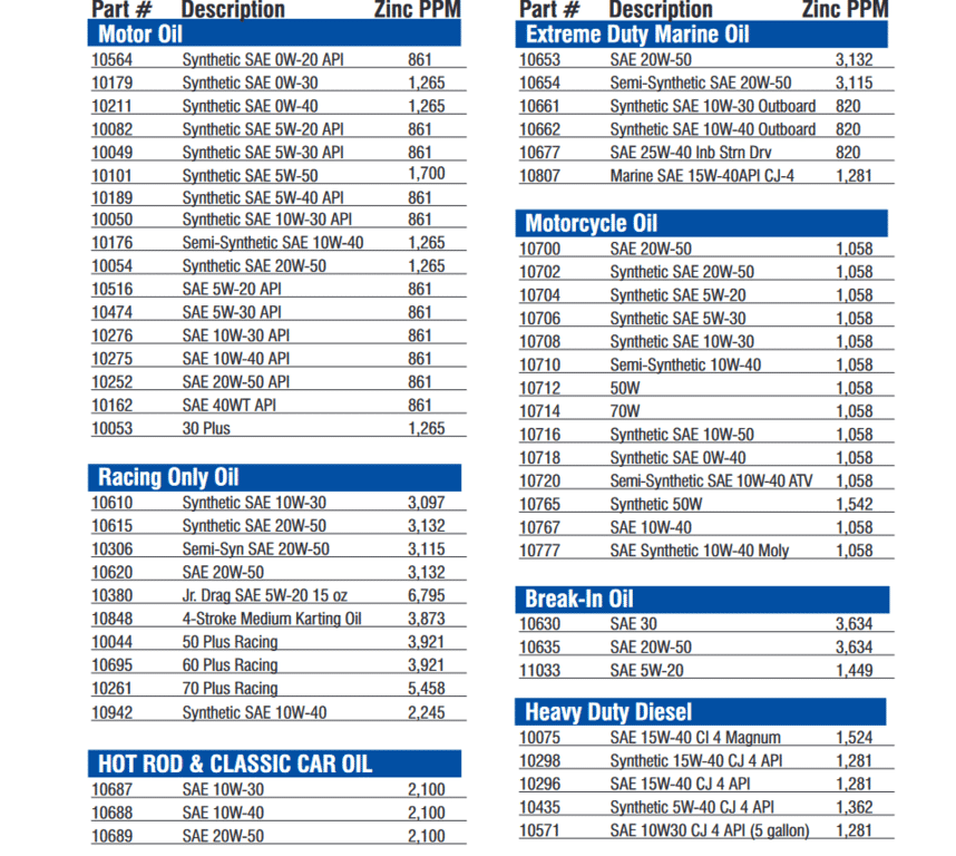

Just for giggles, here's their zinc level sheet
Screenshot_2020-06-07 Zinc_Values_MotorOil-MotorcycleOil_5-7-19 - Zinc_Values_MotorcycleOil pdf.png
