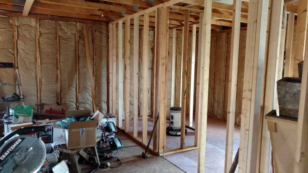

An update for those of you that care. Shop called block and crank are good and do not have to come out. #3 piston was the culprit for blowby/miss/trying to seize in ts liner. Bad news is cam is flaking and has taken followers with it (more money more labor), also connecting rod bushings are loose and need redone/exchanged. So she will have a fresh heart in about another week along with a bill that she will have to work off over the next year or so. Other news is I have got back to work on the walls in our addition, which is making Mrs. Bigblockdodge a little happier after the truck engine issue.

How many sq ft did you add? Looks like you got the commode up and flushing!
Live in renovations seem to take longer, cost more and are messier than planned.
Started out as a little 24x28, 1 1/2 story cape cod. With the free gas, adding the pole building and able to park my big truck here I figured I would add on and make it more what we want. So added 32x28 out the back and made a full second floor on the original cape cod all overtop a 2 car garage for wife's daily driver and my Challenger lives in the house garage most of the time. I was moving along pretty decent till the economy went south in 08 then my 94 Peterbilt broke it's crankshaft in 09 which has basically put the house on hold for 6-7 years now I have done some stuff but i need to get focused back on it again.
