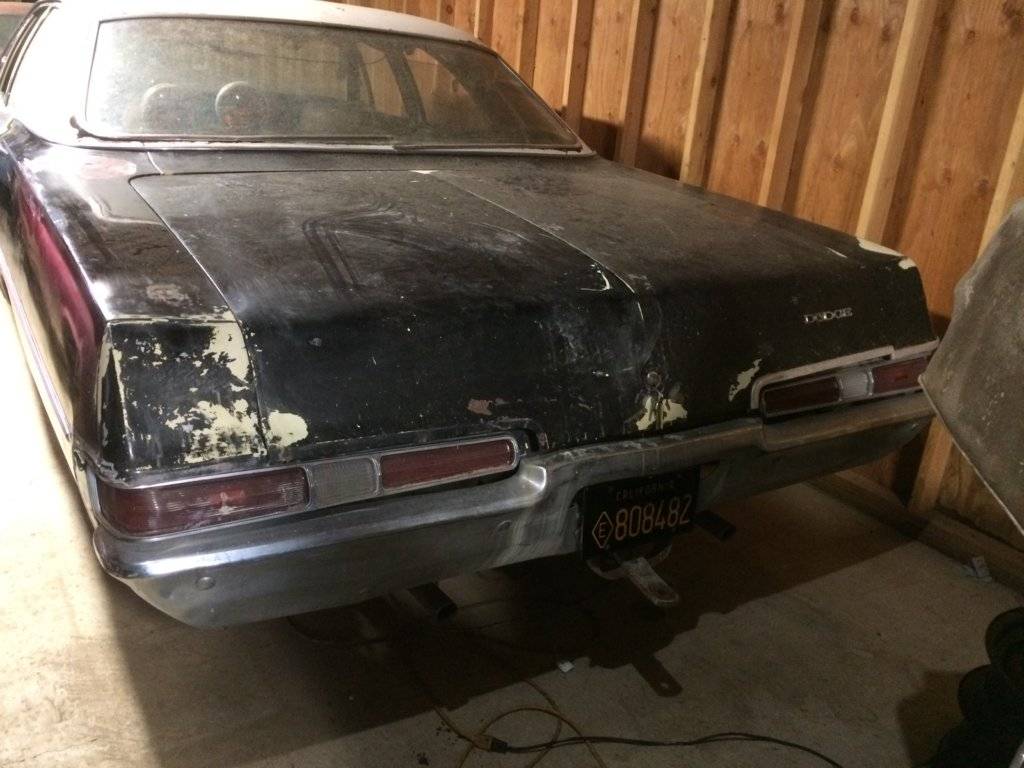

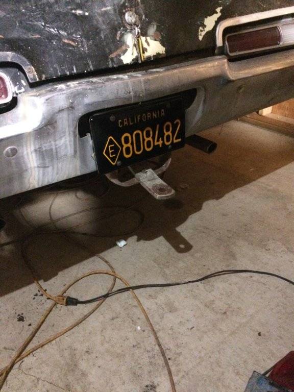

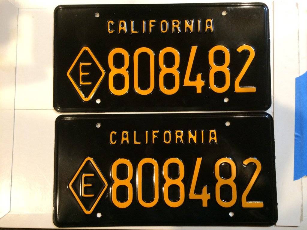

I took Alan's advise with the license plates and got a correct pair with the "correct" (approximate) number my car would have had.
Baby steps..but moving forward.
Just postings this for sh!ts and giggles,...not really any progress, but it's something.
Alan, informed me my numbers are off on the plate, so I'll have to correct that later...it's good enough until I "show" the car.

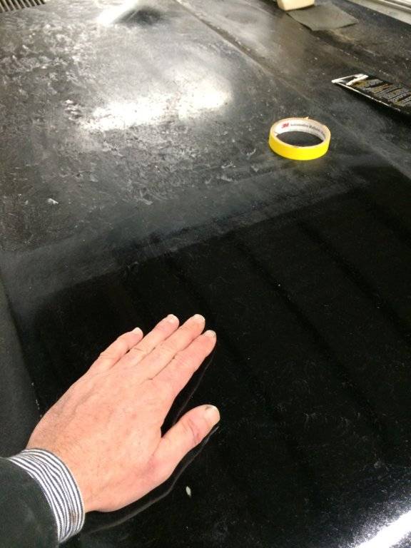

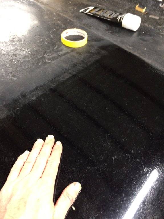

....I spent 5 hours last night with a razor blade removing yellow paint,...it comes off 1/32 of an inch at a time..slow but mostly consistent process. That’s the only way to remove the paint where previous body work by the CHP was done. It’s about 98% back to original day one MoPar CHP paint.

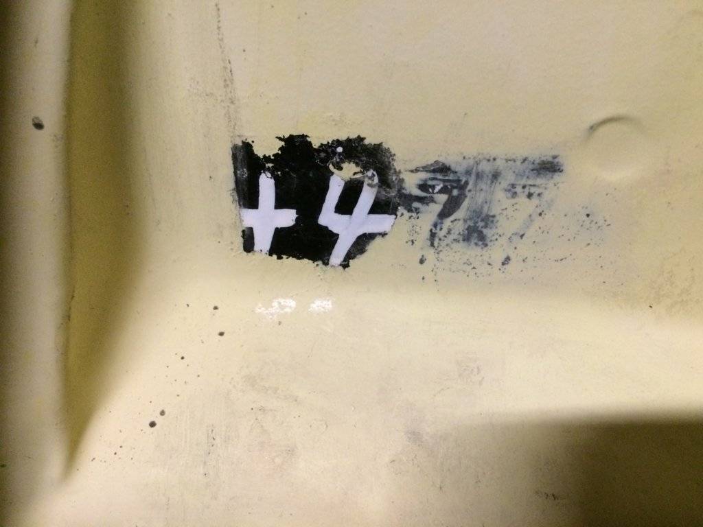

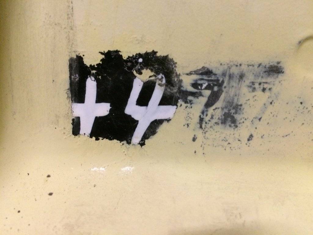

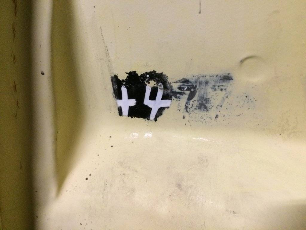

I wet sanded the inner door jamb, and found the original unit number. Unit 4477, as confirmed by Allan/ MrMoparCHP. So that’s cool!
Allan, knows more about the unit numbers than most people, maybe he can comment on what they actually mean, why they are there and how many are left.
A wet cut with 1500 to smooth the texture. I’ll give it a final lap later.
95% of the “day 2” CHP yellow has been removed with water pressure and mechanically with a specially cut razor blade.
The goal is to save the original paint and have a decent appearance from 10 feet.

The “Corvette” method of stripping paint is fine as long as you don’t mind/care about the original substrate, or finish.
If you are trying to remove layers of paint and want to NOT harm damage the substrate you’ll need a less aggressive method.
