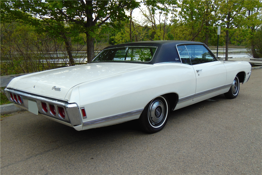

Although I love concave rear glass, IMO the c-pillar and quarter glass look stodgy on a PH29 2-door. It looks great on the 69 4-door PH43 though.

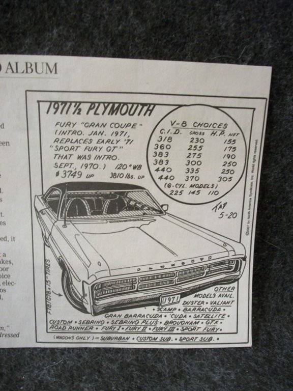

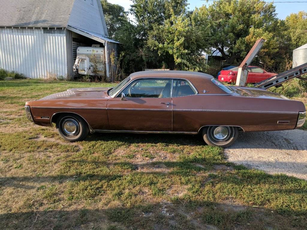

The Paisley Top was part of the 1970 and 1971 Fury Gran Coupe package, not offered on 1969 models.
In 1970 it was available in 21 body style only, which is a two-door sedan since it had a B-pillar. However, the roofline is idential to the 29 and 43 body.
383 engine, power steering, automatic transmission, A/C, tinted glass, power brakes, white sidewall tires, light package, remote left outside rearview mirror, 3-speed wipers, AM radio, deluxe wheel covers, vinyl roof, headlight delay w/ buzzer, and concealed headlights were all standard items.
In 1971 it was available in 29 and 43 body.
Note that the package was not restrained to one exterior color. Additionally, any regular vinyl roof could be had instead of the paisley roof and also the paisley interior could be swapped with a regular upholstery.
