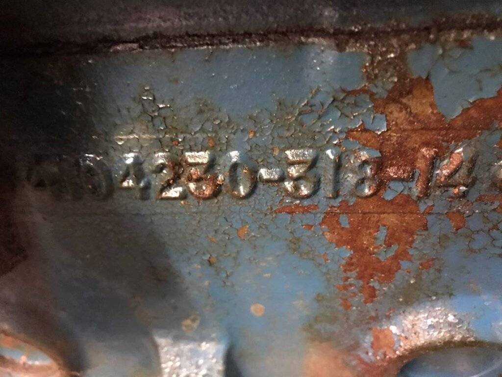

I saw a 318 engine advertised that was used to run a generator and ran on propane. The seller believes that it is a 1985 engine and he called a "race engine"; not sure about that term. Would this engine fit into my '67 Fury with the 727 Torqueflight transmission without any major modifications?

I sure would like a pic of that engine. I have a few questions that a pic would answer. Then I can give my opinion if you can a/o should use it. How much, btw.

Thanks for your response. Here are a few photos. They're asking $350.
You would want to be sure and run a compression check if this engine will fit your application. Engines converted to propane are famous for bad valve guides and burnt valves. Interesting it has a flex plate for a generator mount? You will need to have the exhaust header pipes fabricated as they are different on your '67.
