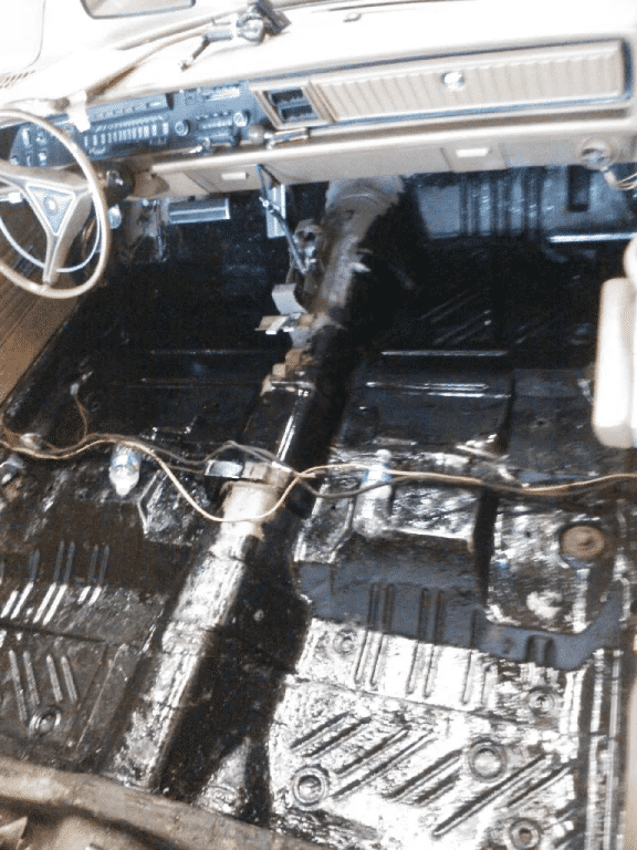

Hello Guys!
I currently rebuild the interior of my 70 Polara from Column to Center Console but i couldn find proper informations about the exact position of the 3 brackets...
I've found two pictures in the Internet:
No 1
mopar center console mounting brackets - Google Search
No 2
Console shifter and bracket location
The pictures in the thread in the b Body Forum looks more like my tunnel, but they measured only two brackets?
The other problem i have is, that both infos gave me different measures and i also doesn't have a pinch weld?
My interior looks unwelded but my floor panels are completely smooth... I'll take a proper photo tomorrow.
Can you help me?
Thank you all very much in advance!!!
Marcus

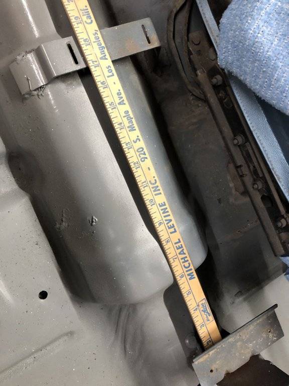

This is a pic from my '70 300 vert. It's the best one I have showing any of the console brackets. Note the rear bracket relation to the seat belt holes, that may give you a place to start.

The outside seat mounting holes are the same as the bench. The inside mounting holes are added (obviously) for the buckets.
