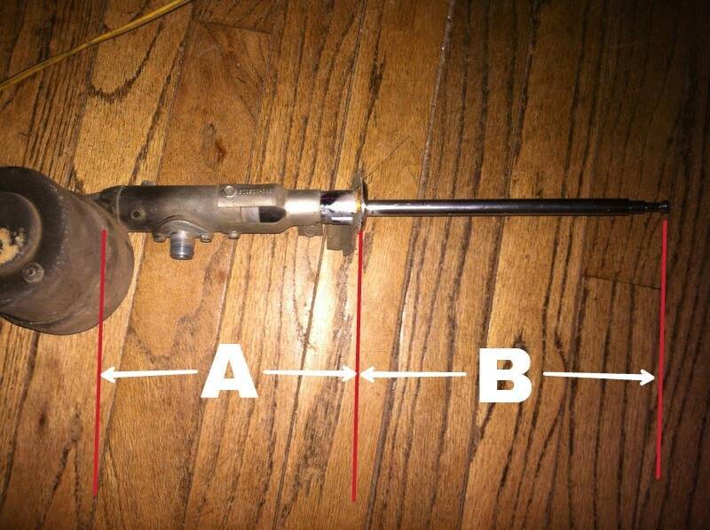

Does the power antenna on a 70' Chrysler go down so the top of the mast is flush with the fender? Or does it stick up above the fender?
It seems like it should... But I have 2 power antennas, both are supposed to be the right antenna... One is even from Murray Park, so I would say it's the right one. Both don't go down flush... The mast still sticks out about 7-8" from the top of the fender. The mast can't go down any further in the assembly.
Every other car I've owned has the mast go down flush... But never owned a fusie with a power antenna until this car.
As you can see, the mast can't go down any further. There's no room.

Looks like the tube is missing.
Nope, the 70 antenna is a lot shorter. It doesn't have the room under the fender for that long tube.

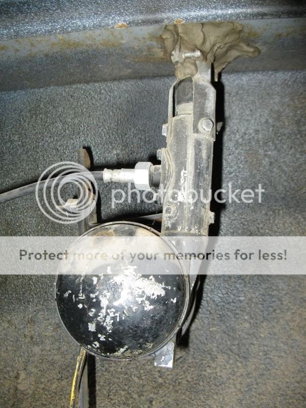

Here's the one that was in the back of Critters's car.
Something is not right . B is too long to retract all the way in to A.
I'm trying to use logic here which may be a mistake. Lol.
If this was the only antenna like this, I would agree that something is wrong. But... The one in the car (I have no picture) is exactly the same.
I'm interested to know how this antenna dilemma is going to turn out too.
I have one of these out of a vehicle also. Is the chrome part that would sit against (on) the fender at a slight angle? This thing does not retract all the way. about 8 inches or so would be exposed.

In the mean time, I've tried to get a more reliable antenna or at least a core to work with. I ended up buying one from Murray Park... The one shown.
Yes, that is correct.
