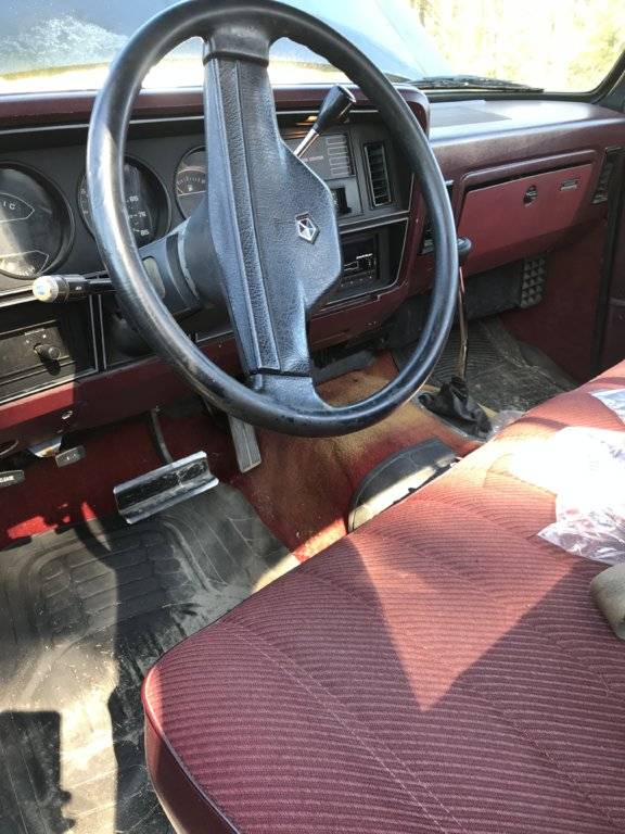

Dug into it a bit today. Needs inspection to get tag. Thank goodness no emission inspection. No O2 sensor, no catalytic converters, vapor canister disconnected, etc. Truck is as rednecked up as my Fury was when I got it. Found more scotch splice connectors than I could count in the wiring and I really hate those things.
No horn (ground terminal broken off) and the bushing for the passenger side wiper is missing. Ordered from Rock Auto. Truck needs to pull horse trailer by Sunday so I am in a hurry.
The charcoal in those things separate into pellets, they get pulled into the carburetor and are the perfect size to block the main jets and virtually shut the truck down. If / when you reconnect it, put some sort of screen in the line to the bowl vent to keep the pellets out. I've had good luck with fuel filters. 2¢
