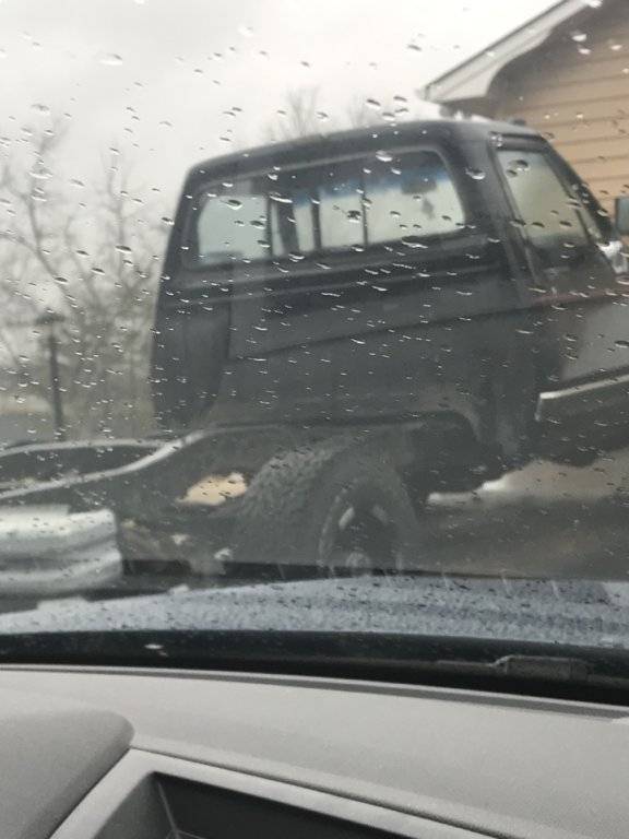

    I have an opportunity to buy an 89 Power Wagon for $700.
    will it pull a single horse trailer with horse that weighs 1k lbs?

    Looked at it today.
    No major rust. Needs exhaust . Bed is off because gas tank straps were bad. Bed has a big hole so it would need a bed. Has A/C. Interior looks really good.
    Trans fluid on dipstick was black and smelled burnt.
    • Like Like x 1
