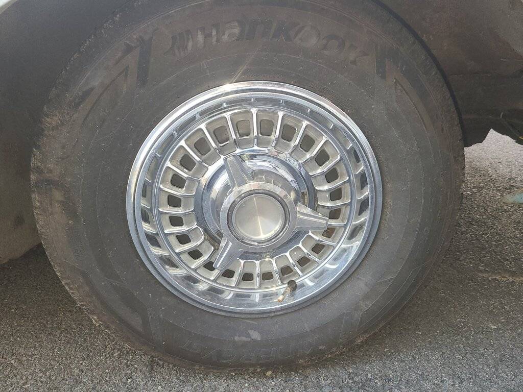

Hello again fellows, few months ago you all helped with my Amp gauge meltdown on my 66 newport, ended up wiring in all aftermarket gauges, including fuel gauge too. Now my right fender and front turn signal won't blink, every other blinker works, including right rear, changed bulbs, cleaned grounds etc. Nothing, ,parking light works too. Also cousin gave me a set of nice hubcaps, anybody know what they are from?
Hello again fellows, few months ago you all helped with my Amp gauge meltdown on my 66 newport, ended up wiring in all aftermarket gauges, including fuel gauge too. Now my right fender and front turn signal won't blink, every other blinker works, including right rear, changed bulbs, cleaned grounds etc. Nothing, ,parking light works too. Also cousin gave me a set of nice hubcaps, anybody know what they are from? View attachment 466828

Hubcaps are GM units mid 60's often seen on Tempest LeMans for example.

They did work after I corrected the meltdown, maybe I missed something under there, guess I'll have to squeeze under again, I do have a full size diagram, so I'll test and trace. That's what I was thinking on the hubcaps, older Pontiac style. They look good though. Thanks
